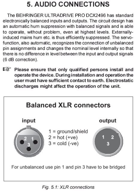

My Behringer Feedback destroyer has a little -10 / +4db switch on the back which is handy as it sets the operating level of the device. I see on page 20 of the DCX2496 manual under "5. Audio Connections" it says:
I was using an RCA to male XLR from the receiver to the DCX2496 from MonoPrice.
I'm not sure how these MonoPrice cables are wired internally. I tried removing the sleeves but they do a good job guming up everything so you can't see anything. Even so, does the DCX2496 require the unbalanced XLR to be wired this way to detect the unbalanced signal?
Anyone know of a place that sells these cables wired in this fashion (pin 1 and 3 bridged)?

Connecting pins 1 and 3 may work, or it may not. Sometimes you can run pins 2 and 3 and leave pin 1 disconnected. You're best off making your own cables to get what works best. And read this:
http://www.rane.com/note110.html

So it appears I'd want it wired like #17 ? Is this different than how Behringer is prescribing?
Maybe, and yes. Connecting consumer and pro gear is a Forrest Gump, you never know what you're going to get.
Again +1. My DEQ manual says for assymetrical use, connect pins 1 and 3 together. It will automagically do some internal switching to consumer level. Have a look in the DCX manual to see if it has a similar feature (probably mentioned under "Audio Connections").
Myn, do you happen to have a multimeter available? If not, I suggest you pick one up. They are available from a few dollars up and are a very useful tool to have around if you're in the speaker building and audio business, be it as a professional or amateur. You can check the connections in your cable with it.
