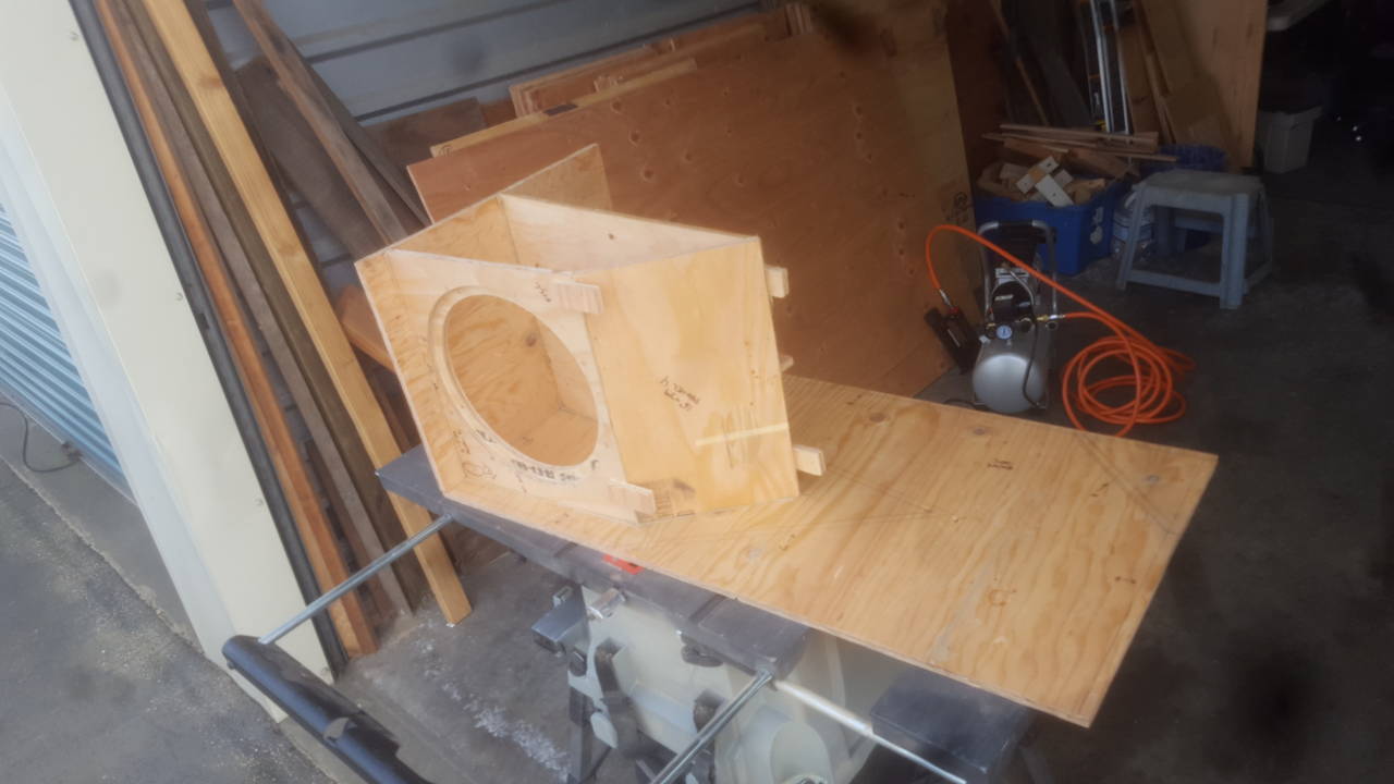

Anchor's attached to the baffle, drew out all the panel locations and lines on outer sides for fastener locations, and installed panel's 1 & 2 today. Loving the crown staples. Waaaaay more efficient than screws. I think the table saw's not making entirely square cuts. I'll have to investigate a little and see what's up. Not being too anal about this first one, so if it's out of square a little, oh well. But would like to have the next 4 as perfect as can be.

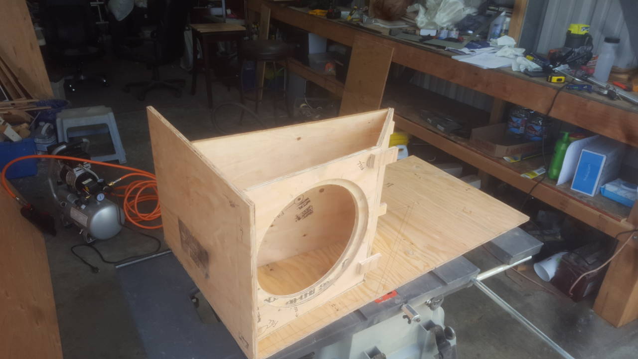

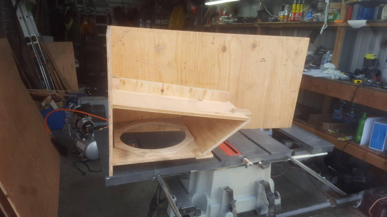

Crappy photo quality, but here's the current state.
