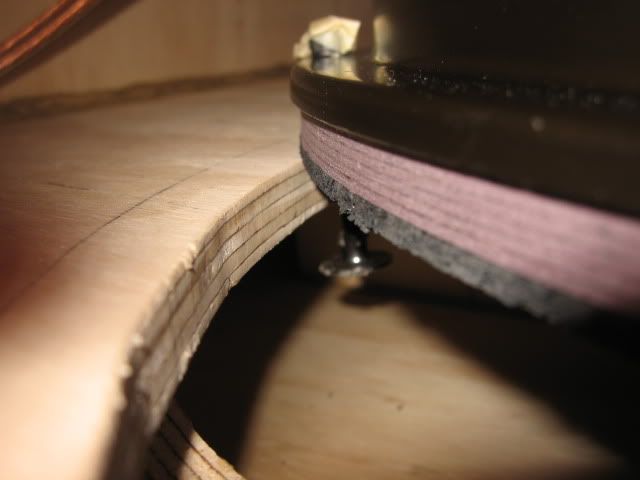

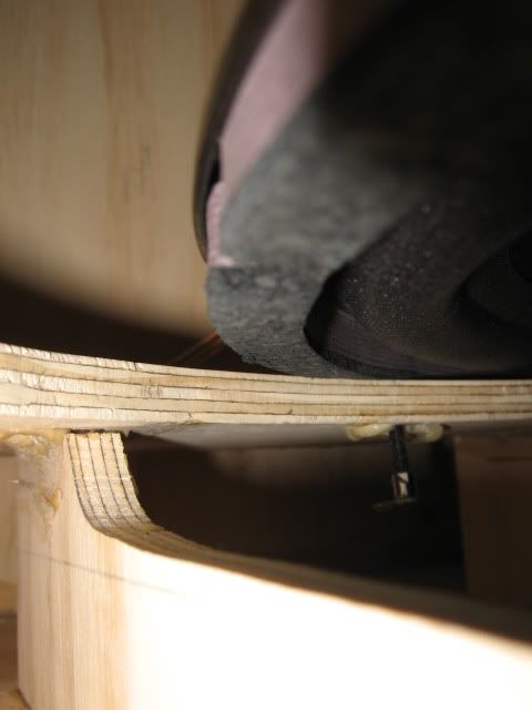

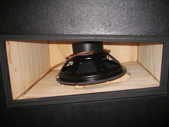

I received my 14 gauge speaker wire from MonoPrice today. I wired up my sub and began securing it inside of the THT with the socket caps. I noticed 1 of the 8 socket caps was having a little bit of a harder time hitting the hole precisely to line up with the hurricane nut so I took it easy and undid it and tried again. Well on the 4th try I heard a squishy noise which I immediately associated with wood and gorilla glue tension.. You can only guess what I am about to say next. The 1 hurricane nut spun loose :(.
Talk about a downer on the entire night. I was so ready to get this THT going. I've had much success with hurricane nuts not spining through thus far. I guess I am not immune to it.
So I have my Dremel plugged in charging the battery so it should be charged ready to use by tomorrow. I'll use the cutting blade and carefully cut the socket cap off. I'm going to cover the speaker with a towel so red hot sparks don't get onto the driver.
Once the screw and hurricane nut is free I am not sure what my next steps are :(. I suspect a new hurricane nut won't have anything to grab onto inside of the hole? Not to mention there is gorilla glue overspill from the previous hurricane nut install. And working in this small confined space is going to be a royal PITA. Do I just fill the hole and not use it? Using 7/8 screws?
I'd appreciate some feedback and help.

Loaded up the Dremel this morning and cut the screw off. I tied a piece of string around the hurricane nut section so when the cut went through it wouldn't fall down into the Horn labyrinth. That worked out well.
Looking at the binding between the hurricane nut and socket cap now I can say I never stood a chance. It was driven in on a slight angle. That particular hole was a tiny bit off and as you guys all know, hurricane/tnuts need to be in perfect or else your screw will never find the nut correctly.
There still remains a glob of Gorilla glue on the backside of the baffle where the hurricane nut used to reside.

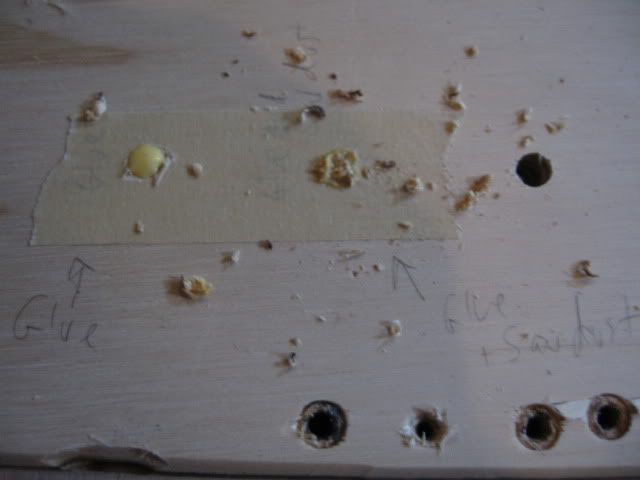

Immediately after I cut the socket cap I set up a test piece of wood with a few 1/4" holes in them. 1 is filled with pure titebond II, The other is filled with Titebond + arauco sawdust. My thought was to test and ensure there wouldn't be any issues.
I am going to head out and get some 2 part 5 min epoxy too. Perhaps I should pick up some L-brackets if they are available locally.
