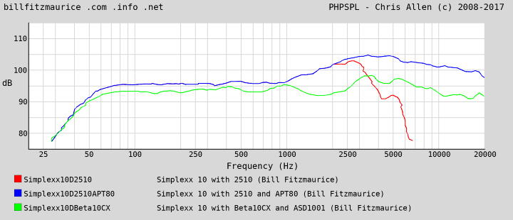

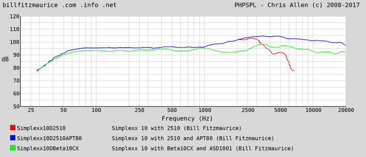

Code: Select all

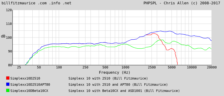

[spl]Simplexx10D2510,Simplexx10D2510APT80,Simplexx10DBeta10CX&dbmin=80[/spl]

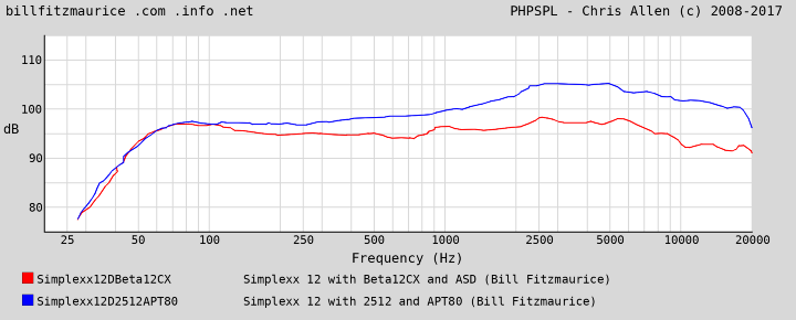

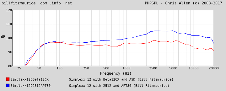

Code: Select all

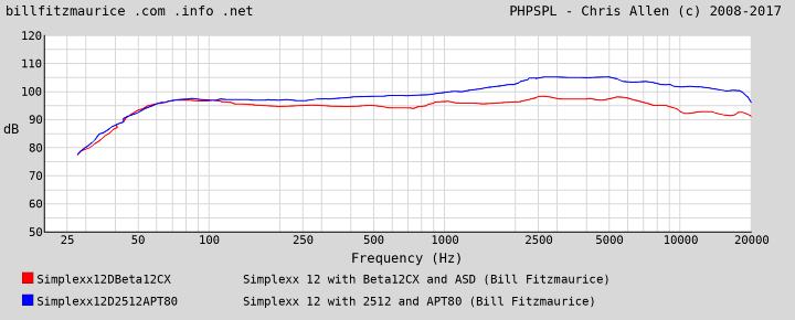

[spl]Simplexx12DBeta12CX,Simplexx12D2512APT80&dbmin=80[/spl]

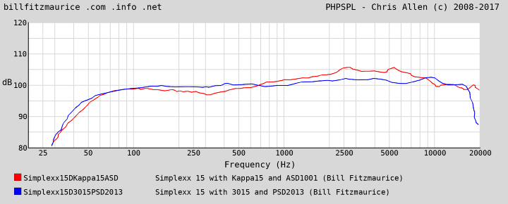

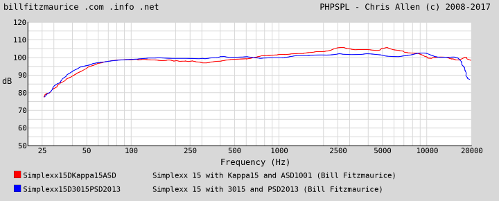

Code: Select all

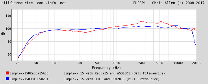

[spl]Simplexx15DKappa15ASD,Simplexx15D3015PSD2013&dbmin=80[/spl]
More simplexx cabs coming real soon..... [Added 3 more]

Those charts actually look a bit too good, due to the vertical scale. They'd be better with a scale of 75 to 115dB in the same vertical dimension.

It looks like they have changed the way the bbcodes work in such a way that I'll have to reformat the way these charts are requested.
