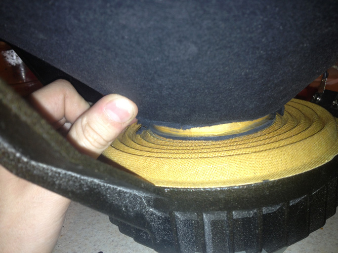

Picture worth thousand words: This is what can happen when you don't limit:

limited to 55 volts :wall:
think eminence is on my side though. they said it looked odd.

sine143 wrote:limited to 55 volts :wall:
A few years back a production run of the now discontinued HL-10 driver had the same issue, which Eminence fixed, and they did replace the defective drivers.
