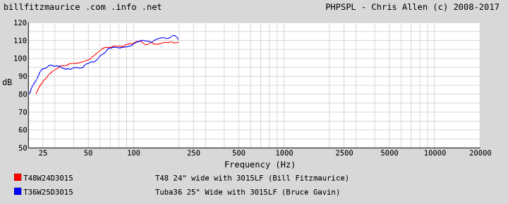

are you sure T48's will go low enough for dubstep and d&b ? looks like it is -10db at 40hz and only start to get efficient around 60hz.
anybody has a comparison plot on a T48 vs THT btw ?

paul_ulrix wrote:are you sure T48's will go low enough for dubstep and d&b ? looks like it is -10db at 40hz and only start to get efficient around 60hz.
The OP does not mention DnB or DubStep, only Top 40, Pop and Hip-Hop. For Dnb and DubStep, you want T36's, or, as Wisounds has proven, THT's. At least 4 of either.

ok well tuba 36s, which 1 the mid size 25" wide with 1 15"? or 2 15" 36"wide?
jcmbowman
Posts: 1263
Location: Detroit, MI
Re: i need advice. valve power, what speakers
#45 Post by jcmbowman »
bigwill wrote:ok well tuba 36s, which 1 the mid size 25" wide with 1 15"? or 2 15" 36"wide?
Build as wide as you can and still get it through doorways. I would stay away from the T36 at 36" wide unless you plan on permanently installing it somewhere.
You can build them anywhere from 20" wide to 36" wide - the wider it is, the better the low end extension and response.
