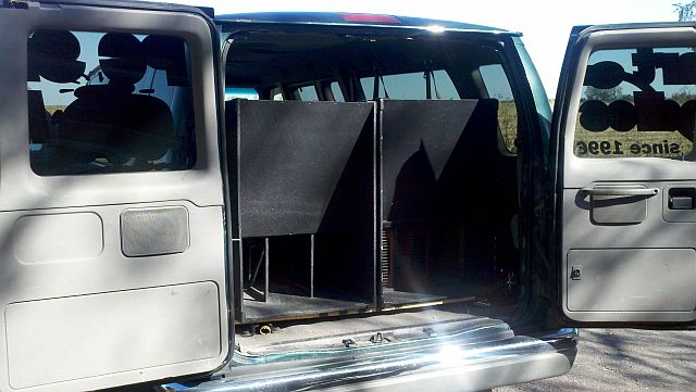

Re: 2xAutoTuba results from USAC / DB Drag Race
Here is what I use to go to war with the natives!
"BaronVonSteve"
"BaronVonSteve"
Have some mercy on the natives in your areabaronvonsteve wrote:Here is what I use to go to war with the natives!![]()
Ahh Steve!! Sheash!
Wait till you have 3 T60 and you can play those out the side door. LOL
