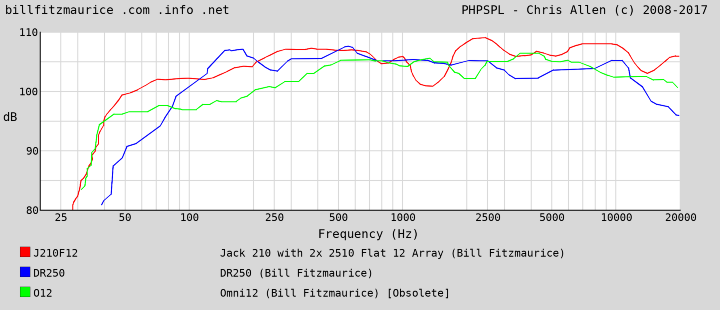

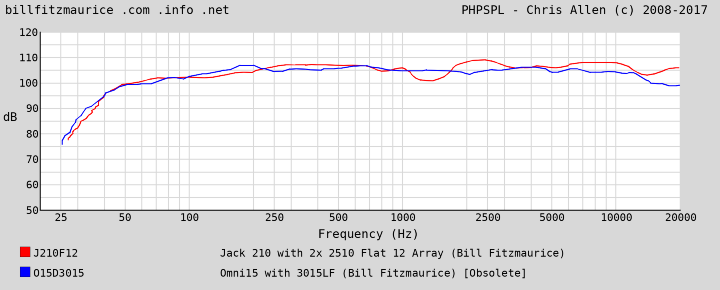

Bass players, check this out! Jack210 == Omni 15 (maybe with the help of a little EQ to flatten that dip and hump at 1500-3000 :-) ).

DaveK wrote:Bass players, check this out! Jack210 == Omni 15 (maybe with the help of a little EQ to flatten that dip and hump at 1500-3000 :-) ).
Well, I've just built an O15TB and could probably use the DLII2510's from my current O10 and build a J210 and compare. That would be real interesting after seeing that chart.
-1. Jack 210 is 4 ohms, O15 is 8. Jack 210 has 294cc displacement, O15 has 846cc. SPL charts alone do not tell the whole story. And there's still no such thing as a free lunch.
