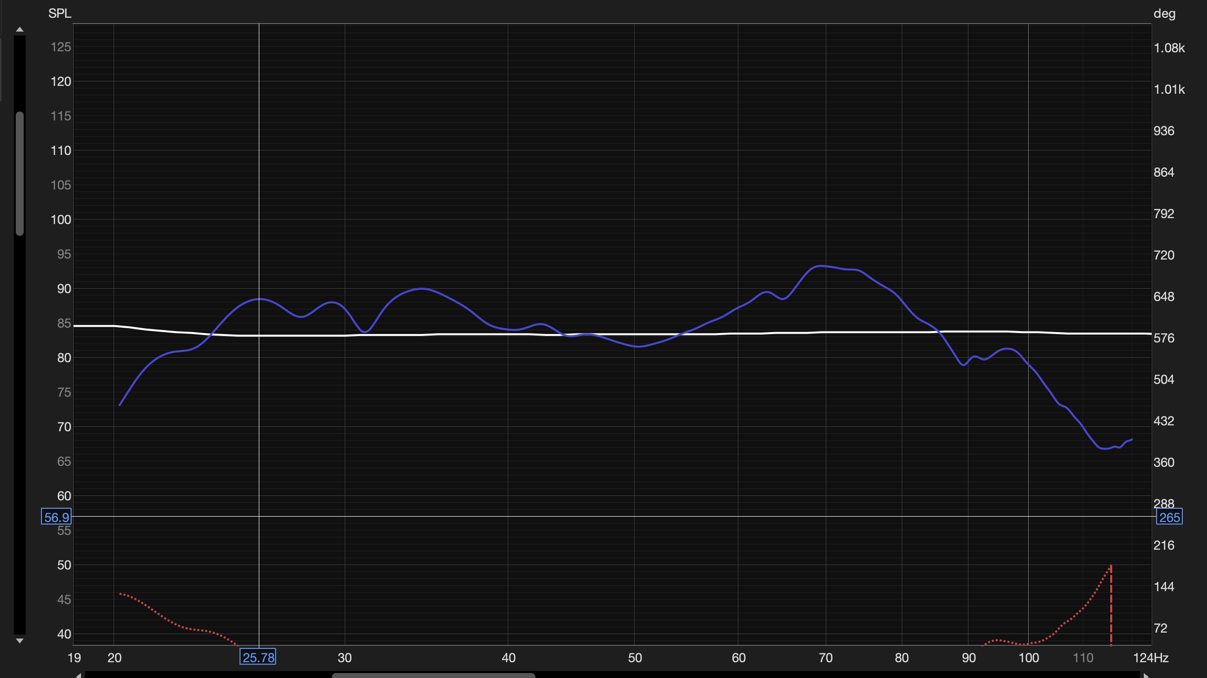

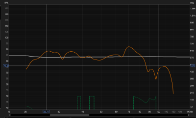

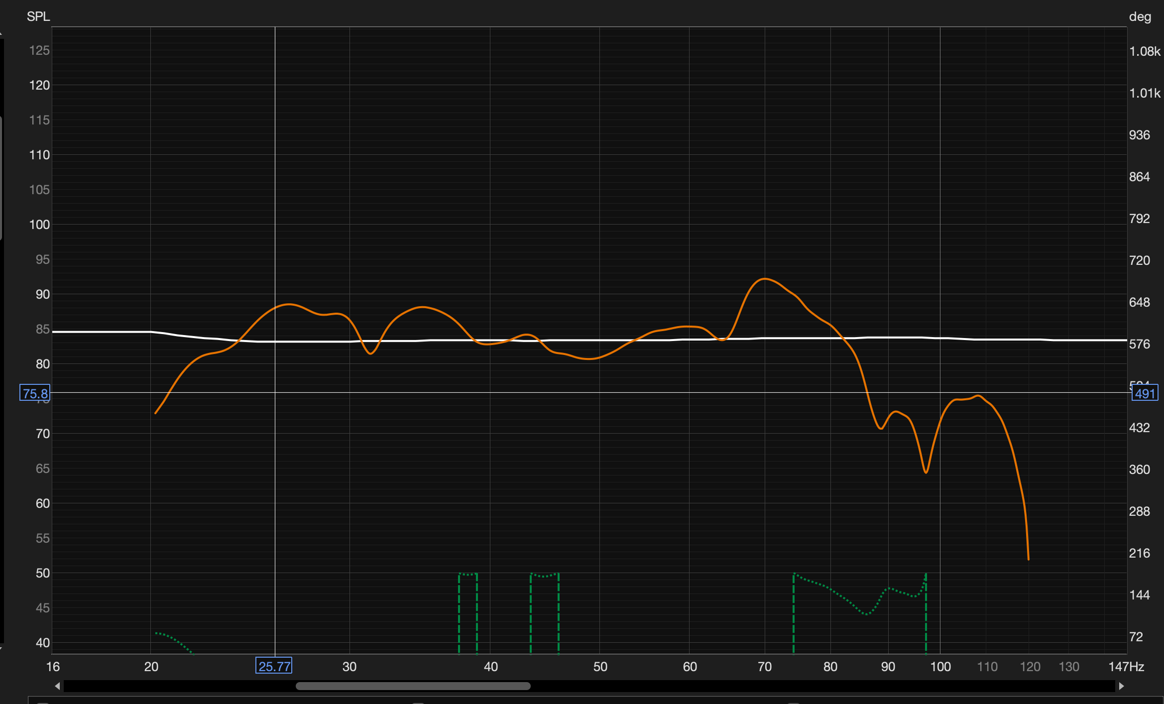

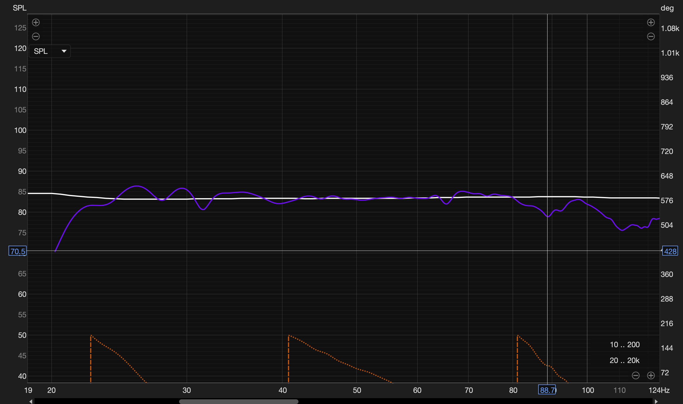

I cleared the settings on my minidsp last night to start over and the 20-30hz range improved a lot. I think I had a leftover filter from the T39's on the minidsp input channel that I forgot about. I then set them up in an opposed layout with the mouths facing away. There wasn't a huge difference to my ear, but I plan to keep them opposed to potentially smooth out room modes. There are some voids if you walk around the room, but as luck would have it, the sweet spot is right where everyone sits

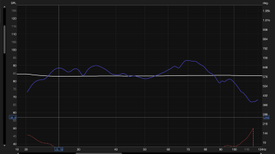

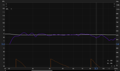

The first two are no EQ with the only change being that I flipped the subs around. The last is the subs opposed from one another and EQ applied. An 80hz low pass is on all charts.
Mouths facing each other no EQ: Mouths opposed no EQ: Mouths opposed with EQ: There are still a few dips and peaks I may try to level out, but overall, they sound amazing and I'm really happy with them! The really low stuff is absolutely effortless with so much headroom if you need more. I feel bad for doubting the 12's as they're now exceeding my expectations. It's easily the cleanest low frequency bass I've ever experienced.
