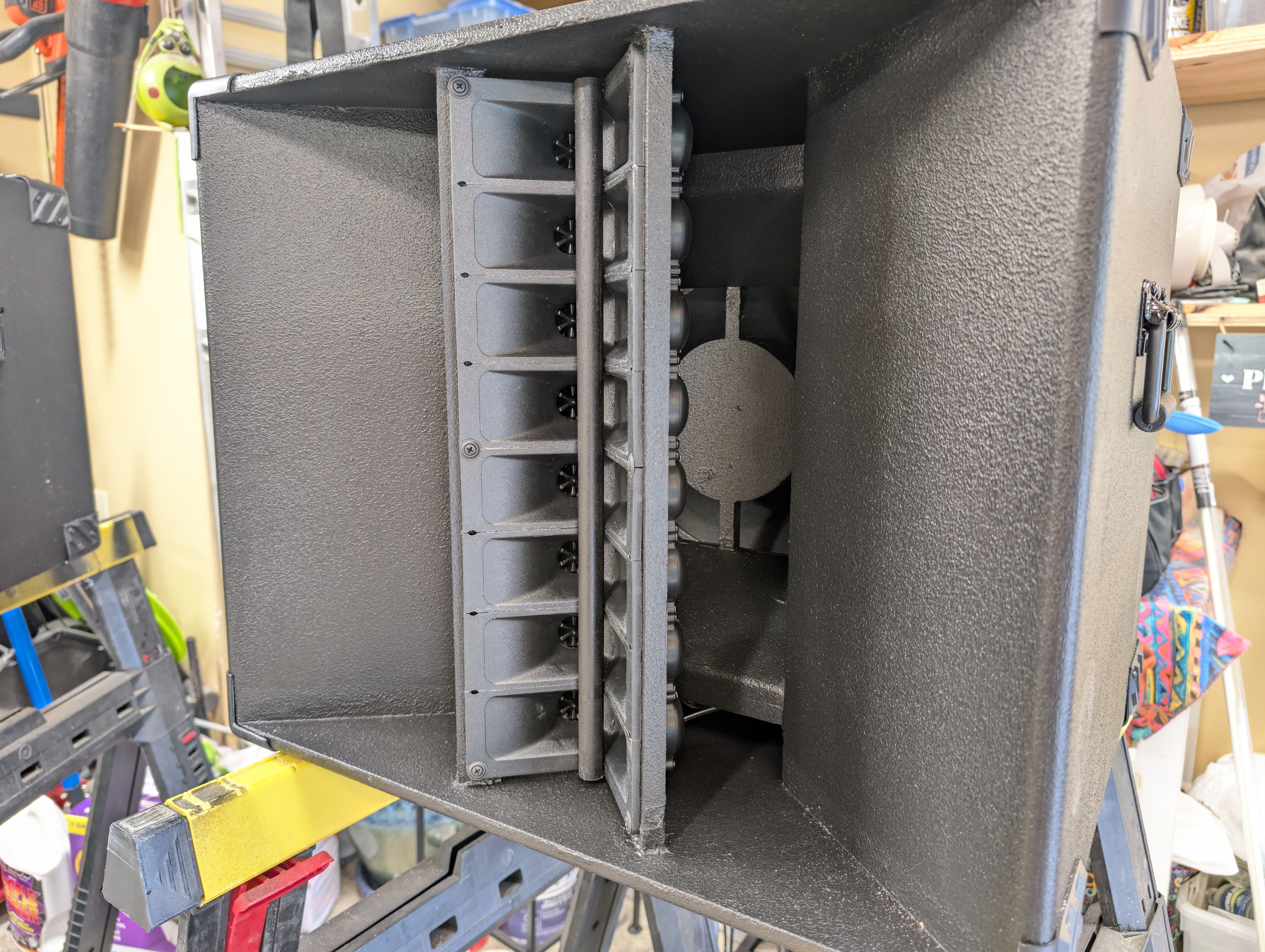

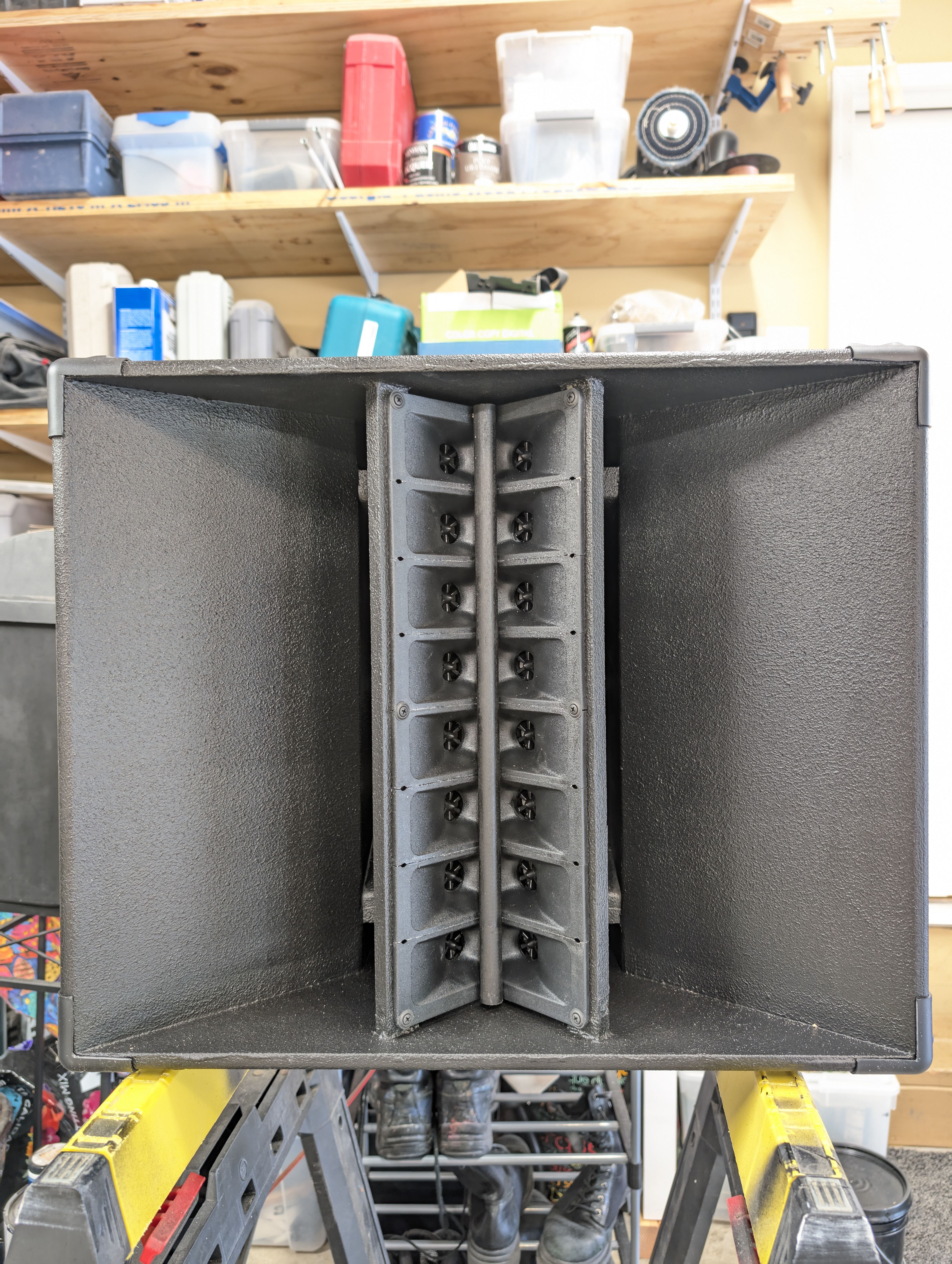

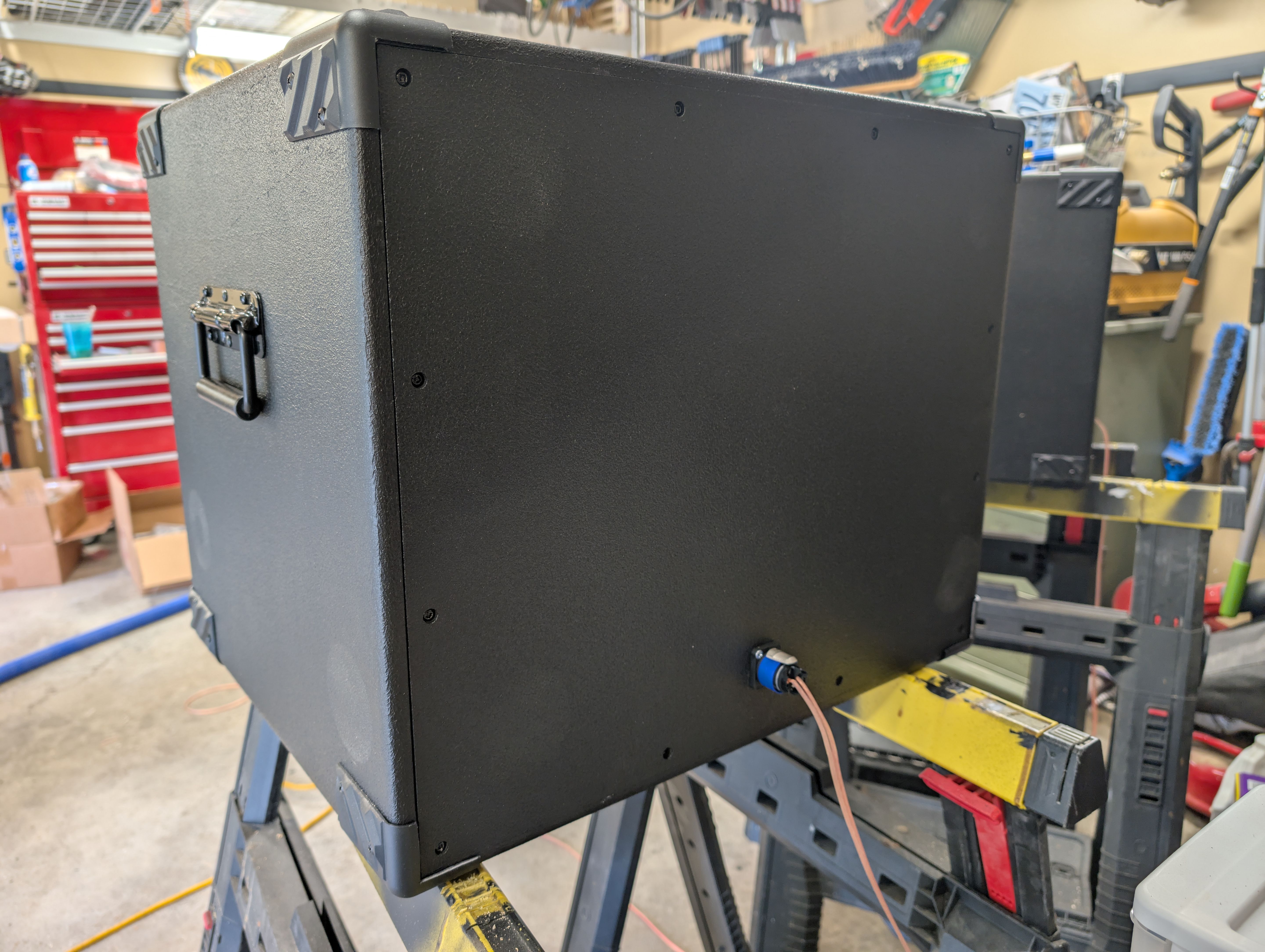

FIN!

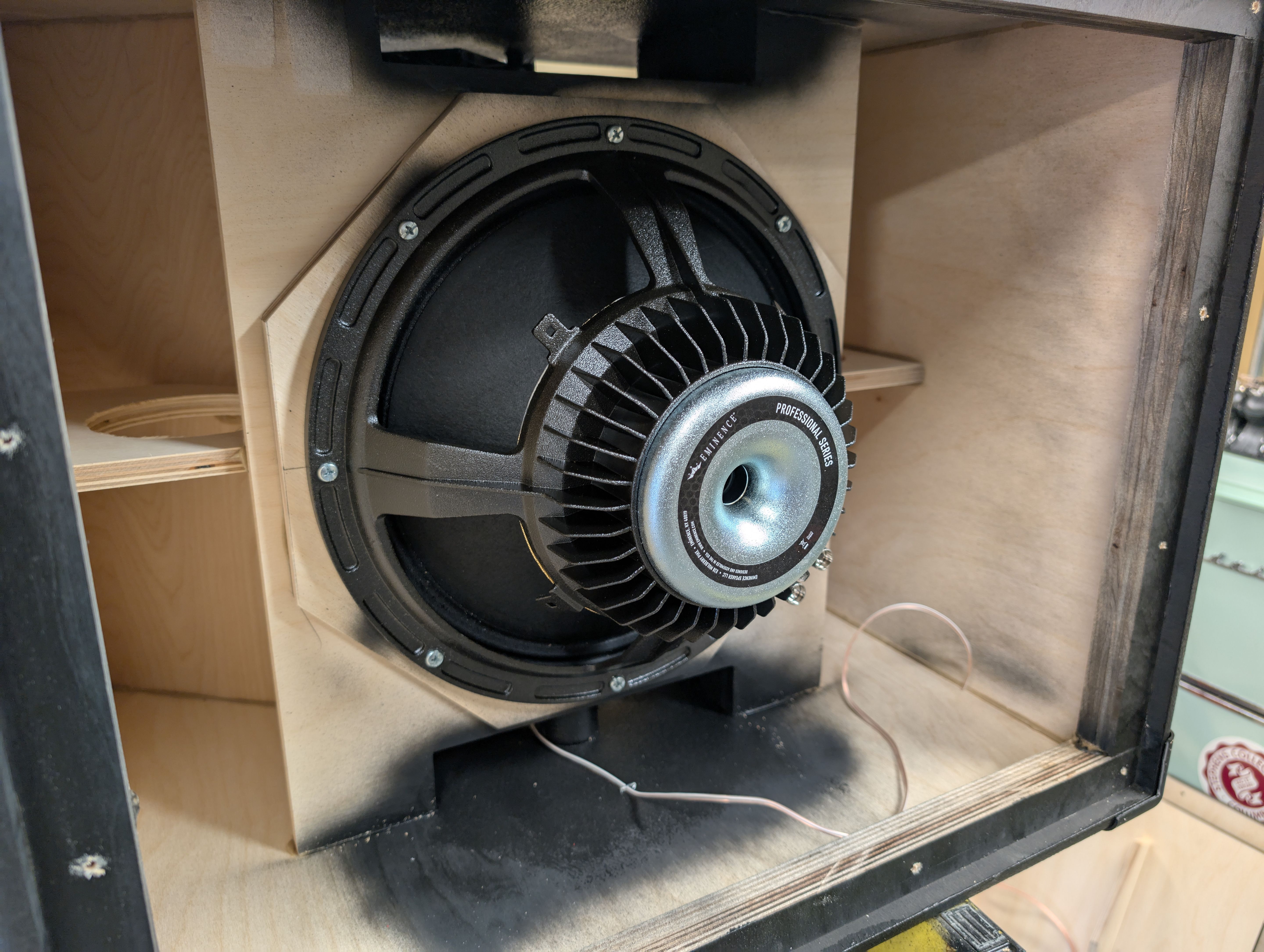

I want to dial them in a bit more with EQ, but my initial thoughts were that these have way more bottom end (when EQ'd) than any other pro cab of this size (or even bigger) that I've heard! I can see why these can run without subs for small PA! They're pretty hot in the mid bass region (250-800 or so) though. Not sure if that's normal or if I fudged something with the crossover. The highs need attenuating as well, but EQ definitely brings these alive.

shane2943 wrote: Sun May 25, 2025 5:19 pm They're pretty hot in the mid bass region (250-800 or so) though. Not sure if that's normal or if I fudged something with the crossover.
All is well, that's what you can expect, however you did fit insulation, yes..?
shane2943 wrote: Sun May 25, 2025 5:19 pm ..The highs need attenuating as well..
I've found 2-5khz needs taming with the melded array.

Keryn O'Shea wrote: Sun May 25, 2025 9:43 pm All is well, that's what you can expect, however you did fit insulation, yes..?
um....I didn't because I didn't see that in the plans. I figured no insulation since the plans didn't mention it, or I missed it somehow. If I just missed it then: :slap:
The damping is critical to smooth out the midrange. It's in the plans and in the sketchup.

I definitely missed it then. I'll get that added. Not a big deal to take off the rear panels and put that in.
Edit: just checked the Sketchup and sure enough, there it is. :slap: :slap: :slap:

Ok, got the insulation installed in both cabs. To the surprise of no one, that fixed that mid-range hump! They sound even better now!

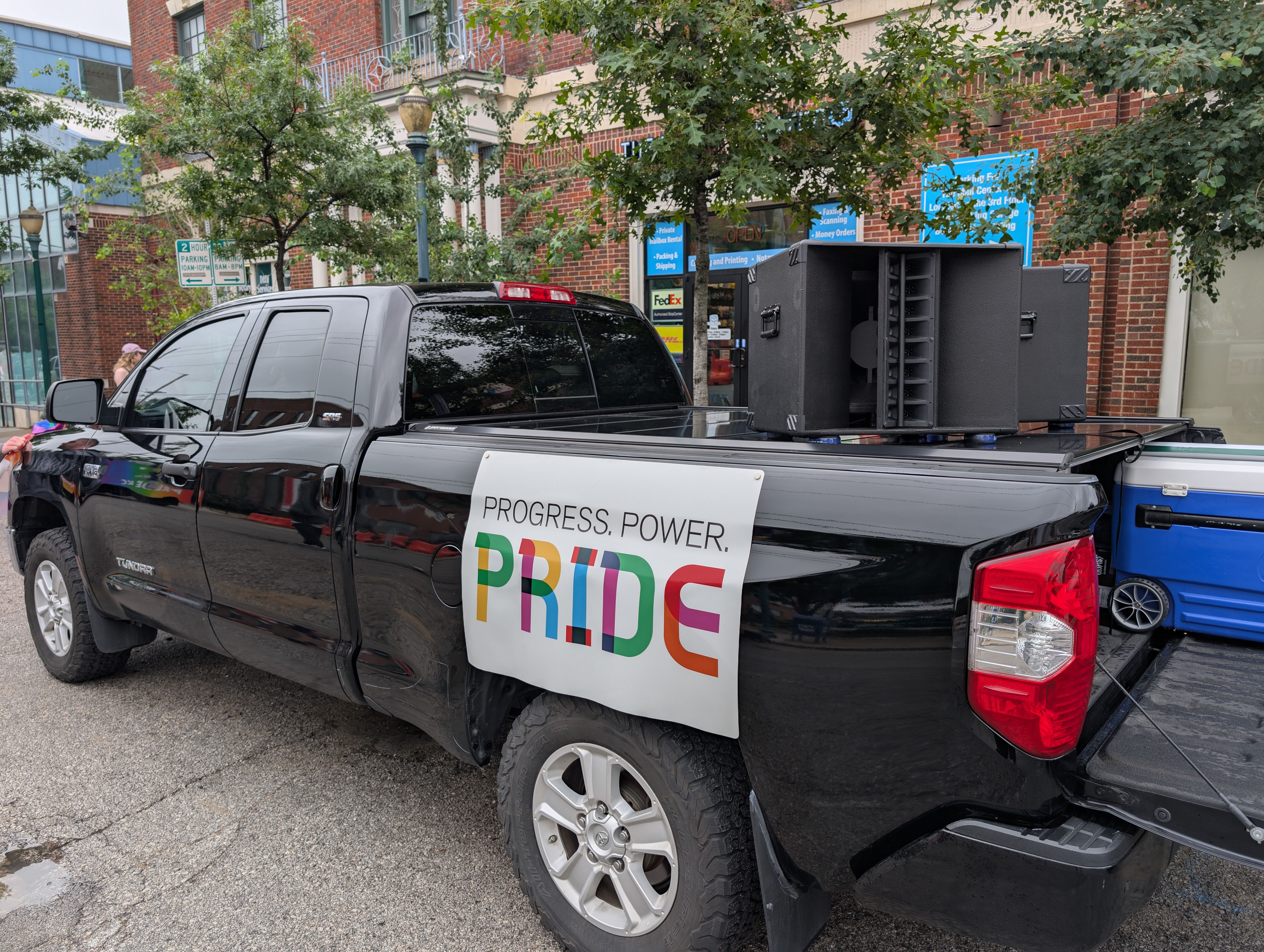

Hey thanks Anton!

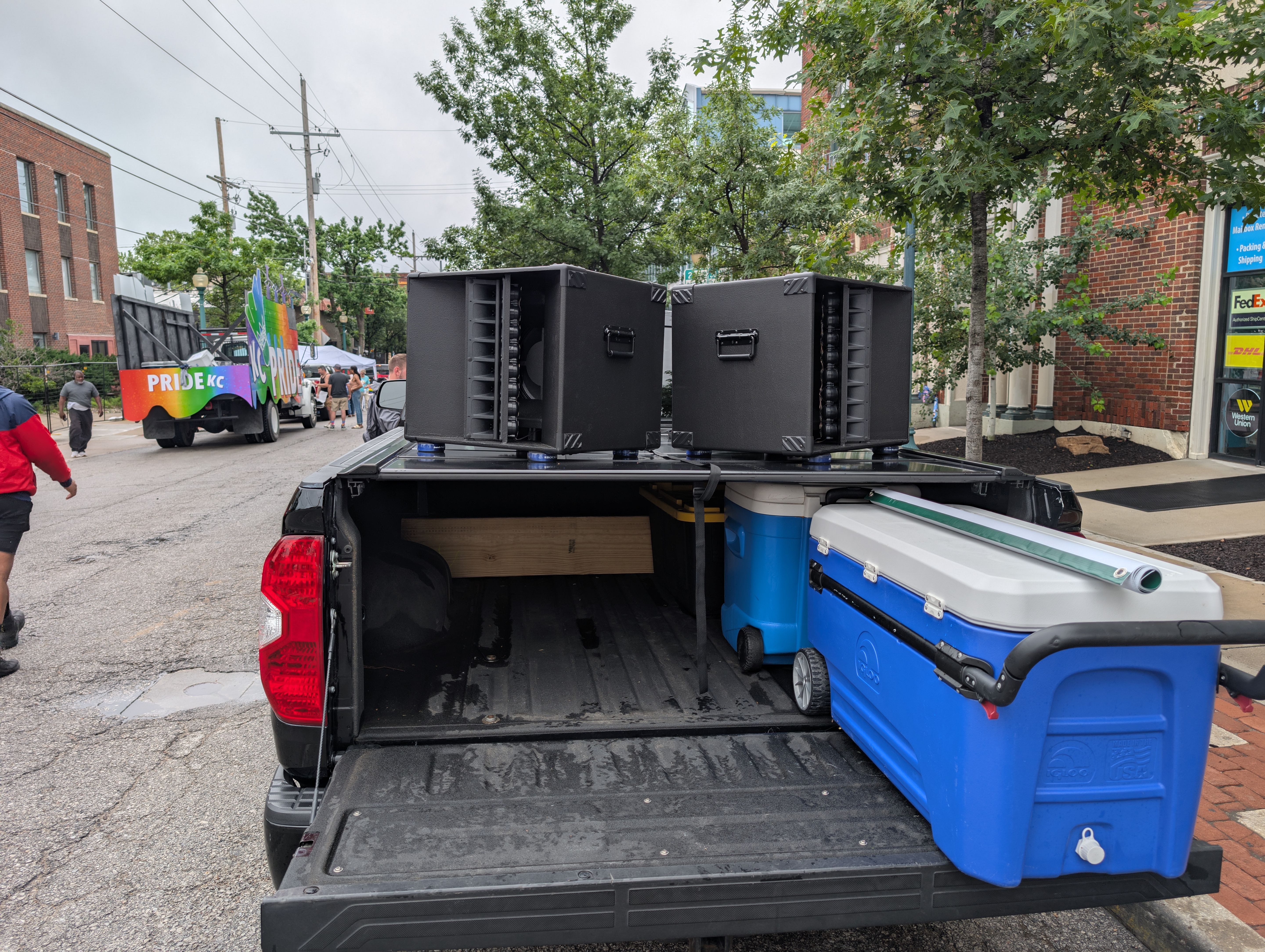

Tomorrow they make their "debut" at the local Pride parade here in KC. They'll ride on the bed cover of my truck playing music for those walking and the crowds on either side. They'll be powered by a car amp (already tested and works fine and get's PLENTY loud). I'll post pitchers after tomorrow of the event. :)

The Jacks did awesome at the parade!! Ran them quietly before the parade for ambience. Then once we started walking, I cranked to just about war volume. They sounded great! And the crowd on either side of the parade route and the walkers definitely enjoyed them.
I powered them with a car amp which worked fine.
I also tested the water resistance (lol) of the Jacks as it started POURING during the parade. Like, complete downpour. They got pretty wet, but my hope is that they'll dry and be fine.

shane2943 wrote: Sat Jun 07, 2025 1:11 pm I also tested the water resistance (lol) of the Jacks as it started POURING during the parade..
Unless water ran into the port, they'll be fine as you used Duratex.
Are your filters mounted to the sides? No harm in popping the backs off to check the unpainted surfaces..

We played a lot of the cliche songs (YMCA, I'm coming out, etc) and we also played a lot of modern upbeat stuff like Pink's Raise Your Glass, Ru Paul, Chappell Roane, etc.
I had several people ask about them actually! My wife also told a lot of people about them and that I built them (I did make sure to tell people that I didn't design them though :wink: )
The bottom end was great! At least from what I could hear driving the truck. Kinda wish I could have been out walking so I could have heard them at near war volume. But they sounded clear to me!
I don't think any water got in the port. The crossover is mounted about mid way up on the rear cover so not worried about that.
