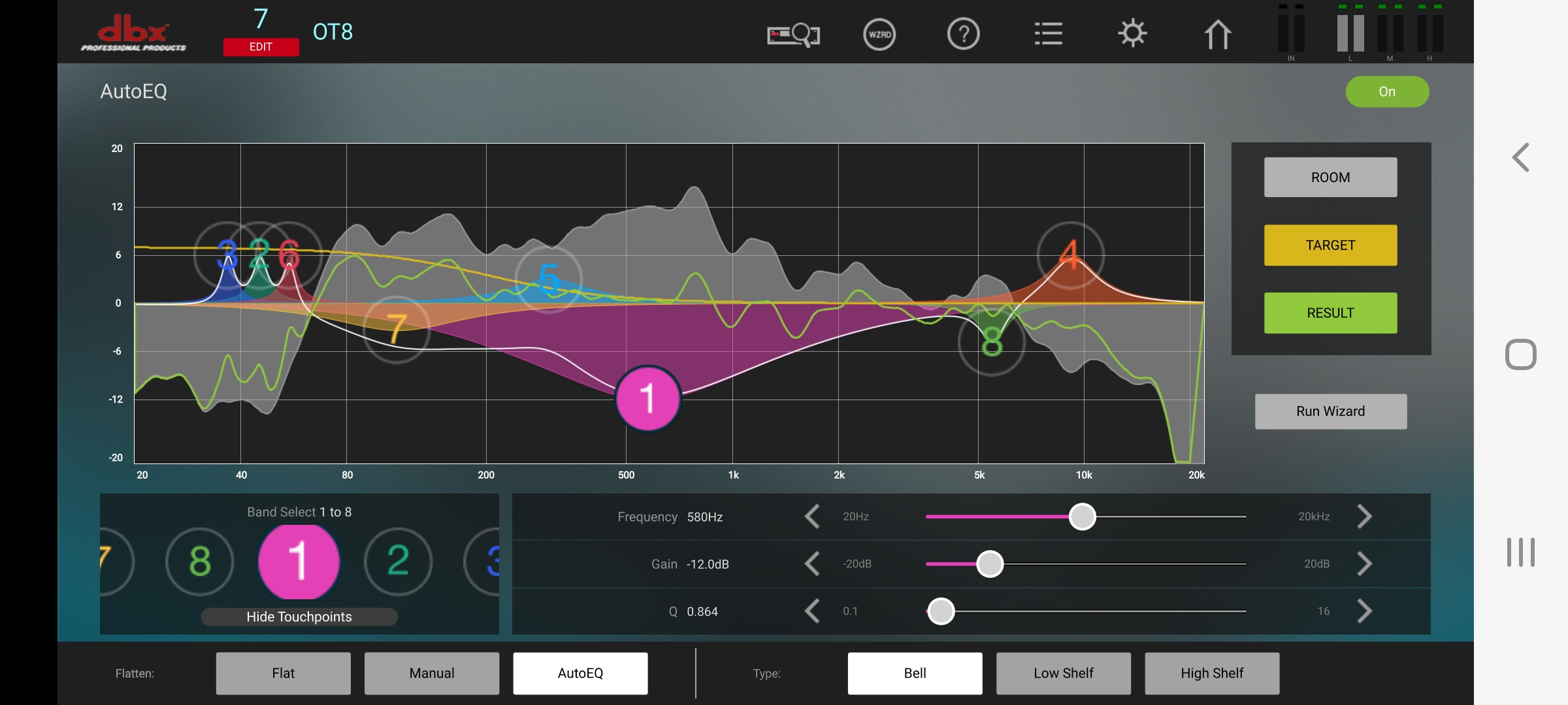

I managed to AutoEQ & give them a 5 song lash with Led Zeppelin, Tash Sultana, Live & Kings of Leon, they were HP at 80hz 38dbBW
Initially l thought the HP was turned off, as there was considerably more bottom end than expected.. but no, it was set. As l increased the volume (l was using my iPod through a headphone amplifier) l realised how much grunt l had at my fingertips! With only the first signal & output lights flickering on the Driverack, it was properly loud & clear but also warm... big smile & goosebumps!
The intelligibility impressed me, l noticed the drums more in the songs played.

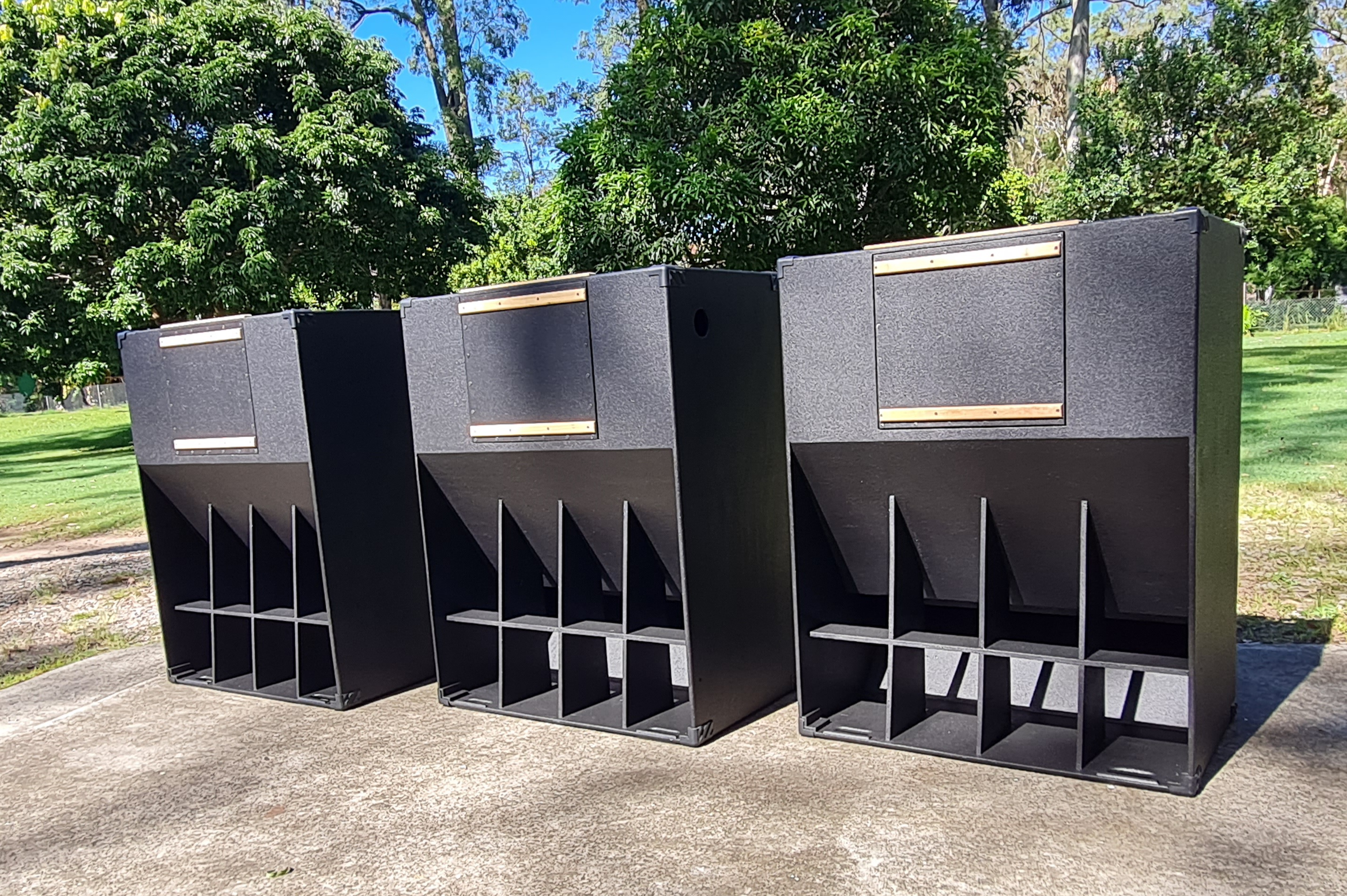

3 painted, 3 more to go..
Thanks for your tips on priming the cabs with flat black & cling wrapping the rollers Bruce, that's saved a fair amount of paint.

it's taking a quart of primer & a gallon of Duratex per cab :shock:
Tom Smit wrote: Fri Apr 18, 2025 11:12 pm Wow! Look at the size of those things! They're huuuuge. I know it sounds silly, I know that they can be that wide, but, to see them!
:D

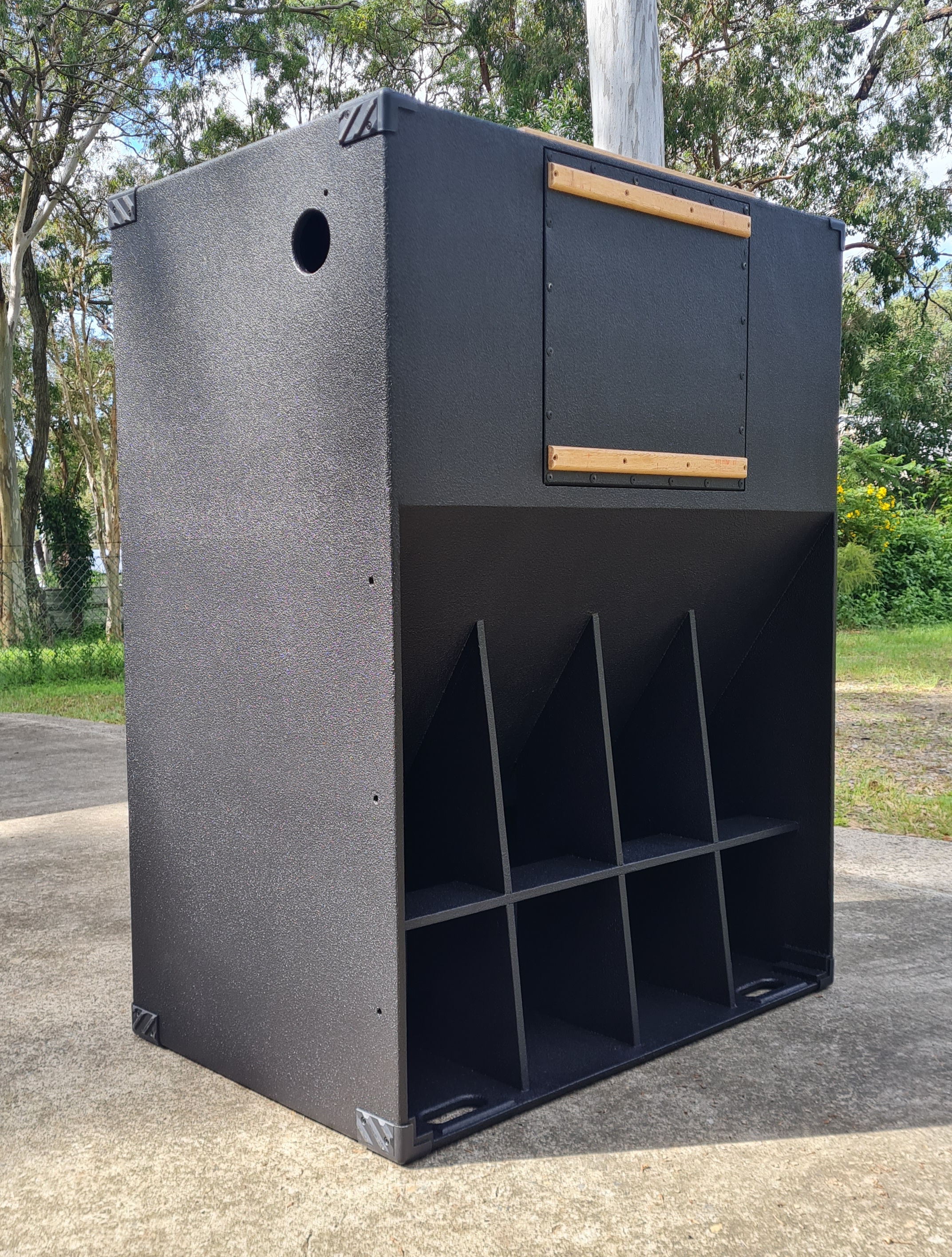

They're sizeable yes, however really easy to move around, even the last two which are LAB15s.
You've probably already worked out the bumper strips on the driver access door & top are for trucking them around upside down.. all the weight is down low & back on the trolley
Painting these seems to be taking forever..
I'm also having thoughts even 6xT48s won't be quite enough to match the 8xOT8s, l guess we'll see..
Aiming to be finished painting in the next two weeks, then l can finally hear them all together

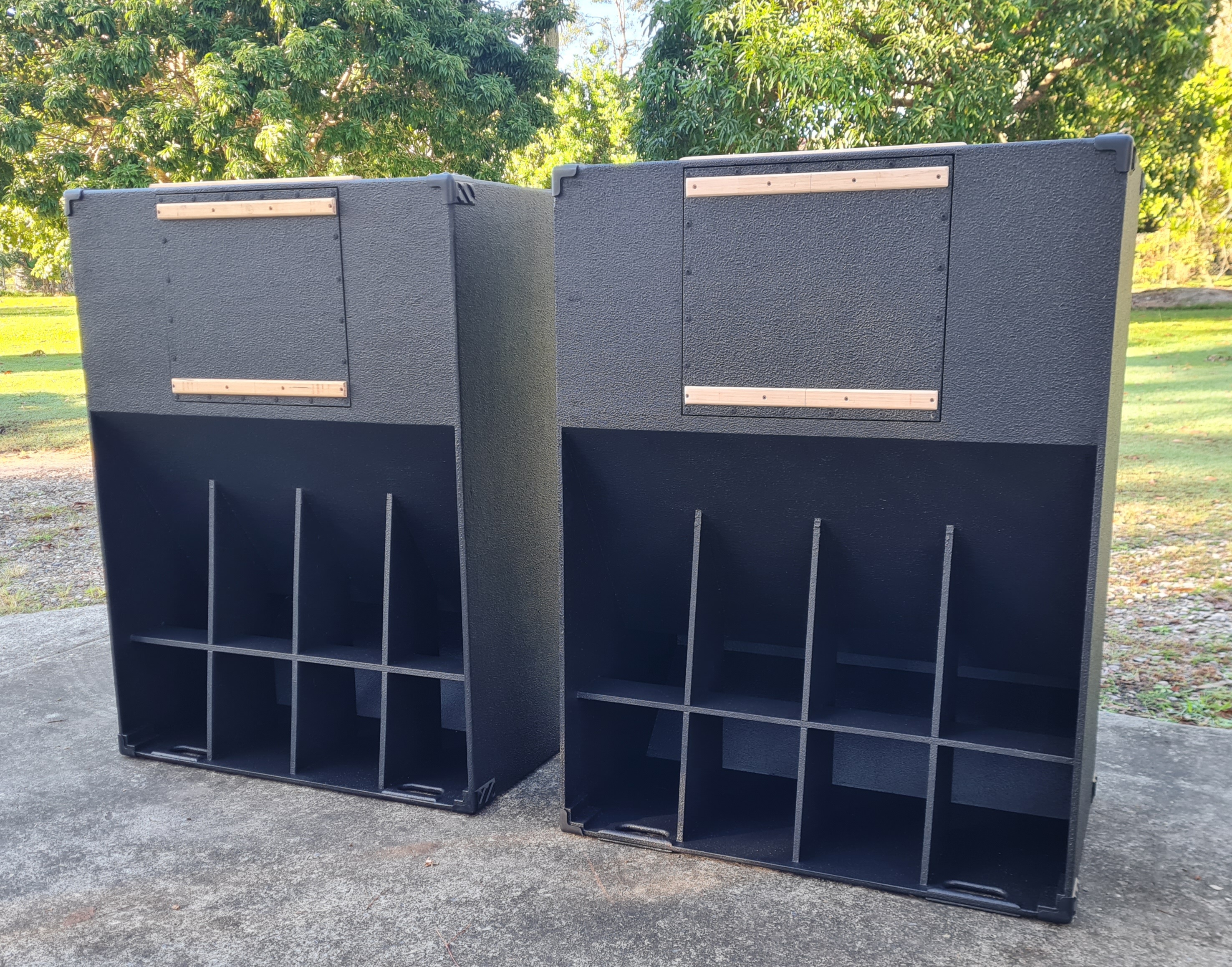

Cabs 5&6 are finished.. :)
I'd like to run the limiter values past you guys to check please. There's 3 different drivers: 2x 3015LF, 2x 3015CX & 2x LAB15, one of each on 2 channels of a CVR D2004 amplifier.
