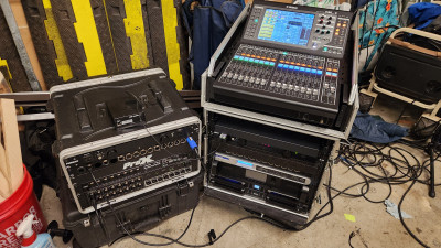

I think if you just learn how to learn, it becomes much easier to try adjacent projects. I had never used power sequencers, open architecture DSP, Dante, or heat maps before last year. But the training is available for free online, and with a little bit of studying and a couple bucks on eBay I ended up with 2 killer installs this year, plus a pretty elaborate Dante network on a Symetrix open architecture DSP with a nice Yamaha mixer for my personal rig.
Those old symetrix radius units sell for as low as 350 used on eBay.... For 64x64 channels of Dante that's crazy. Do the training and swoop one. You will be unstoppable
I patched a USB avio to mine and made an internal loop back, patched the input to a mic preamp on the DSP and now I don't even need a separate interface for FFT. Can measure directly from the DSP preamp
