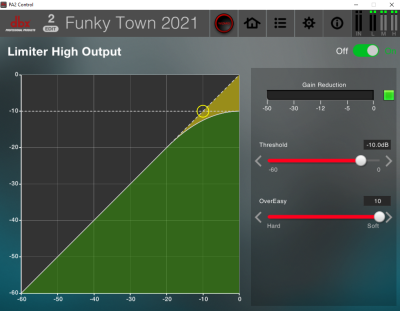

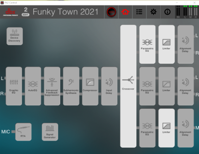

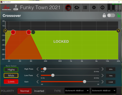

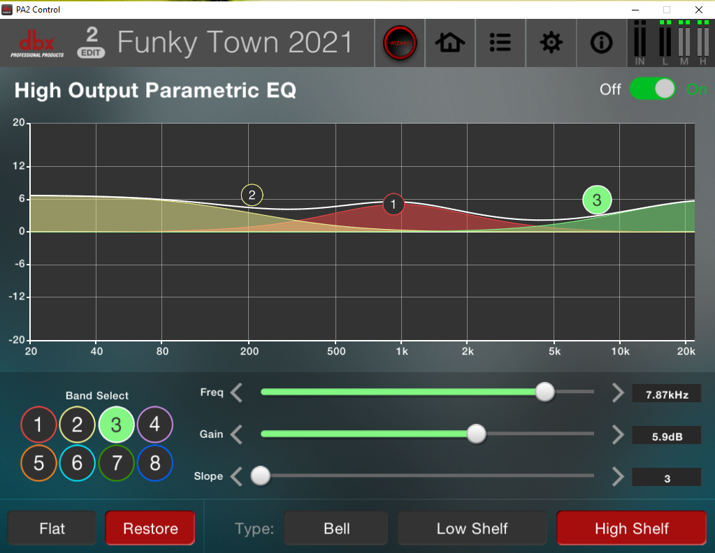

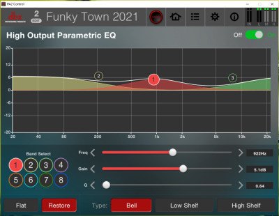

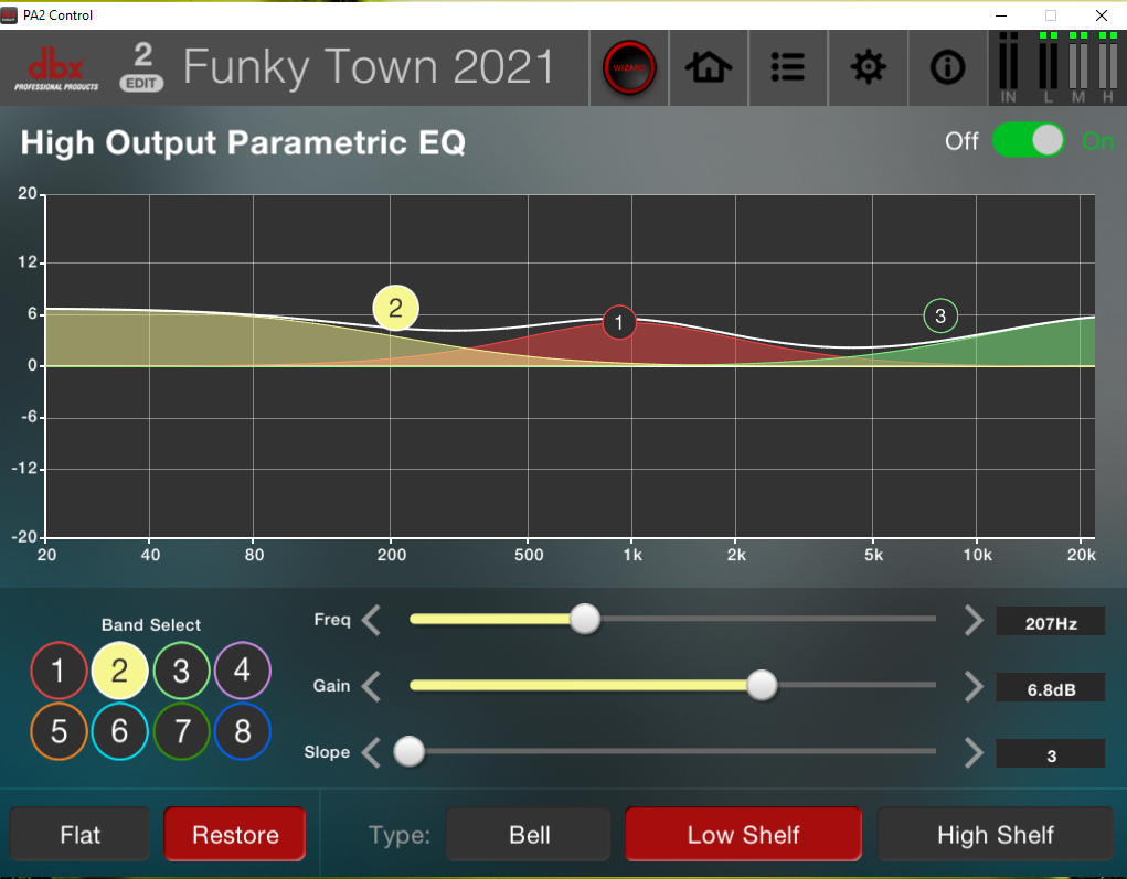

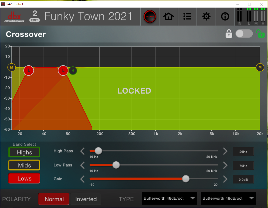

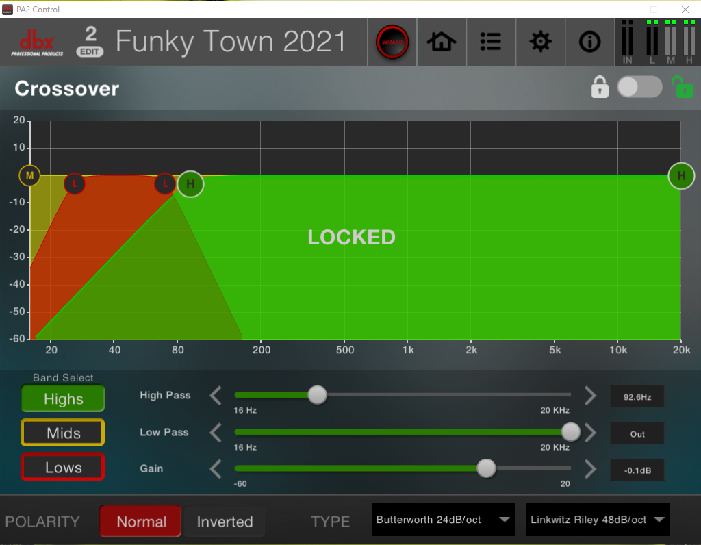

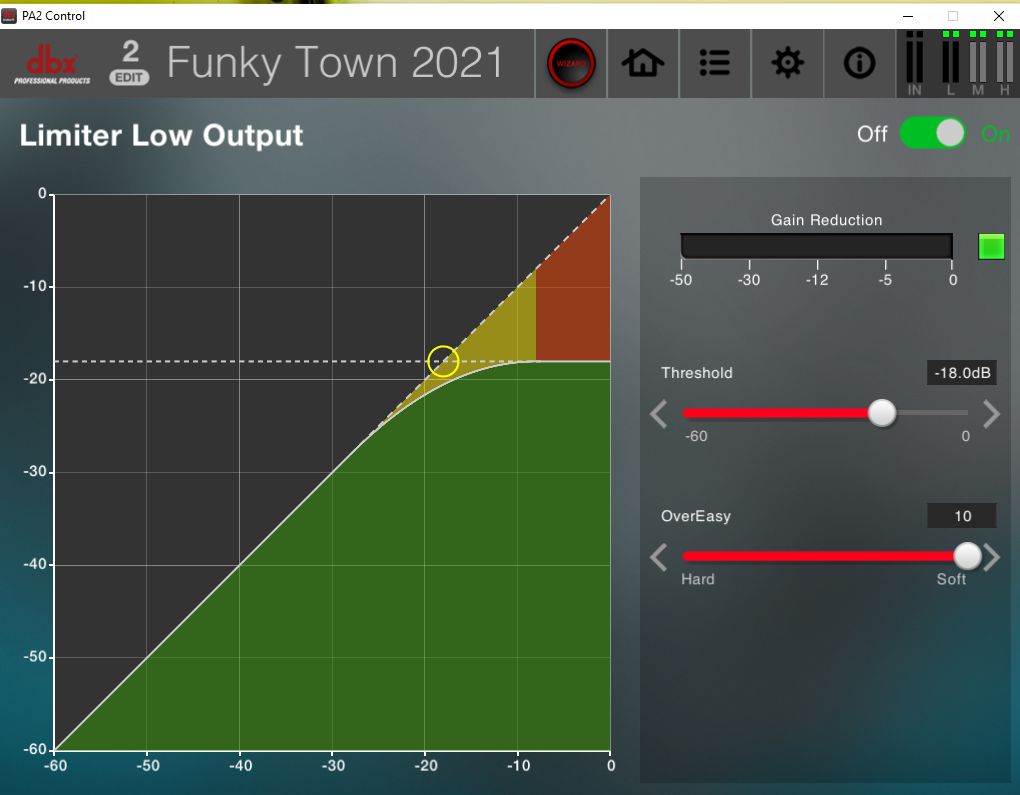

Tuning
Okay! I finally got our tuning/limiting info!
Here we go, from our Driverack:
High pass: 92.6Hz
Mid pass: n/a
Low pass into subs: 26 - 70Hz
Limiter high: -10db with overeasy compression 10
Limiter low: -18db with overeasy compression 10
High EQ Band 3: 7.87kHz, 5.9db gain, slope 3
High EQ Band 2: 207Hz, 6.8db gain, slope 3
High EQ Band 1: 922Hz, 5.1db gain, Q 0.64
Again, this is for an outdoor, wide open, dried up lake bed in the desert. Thoughts?
