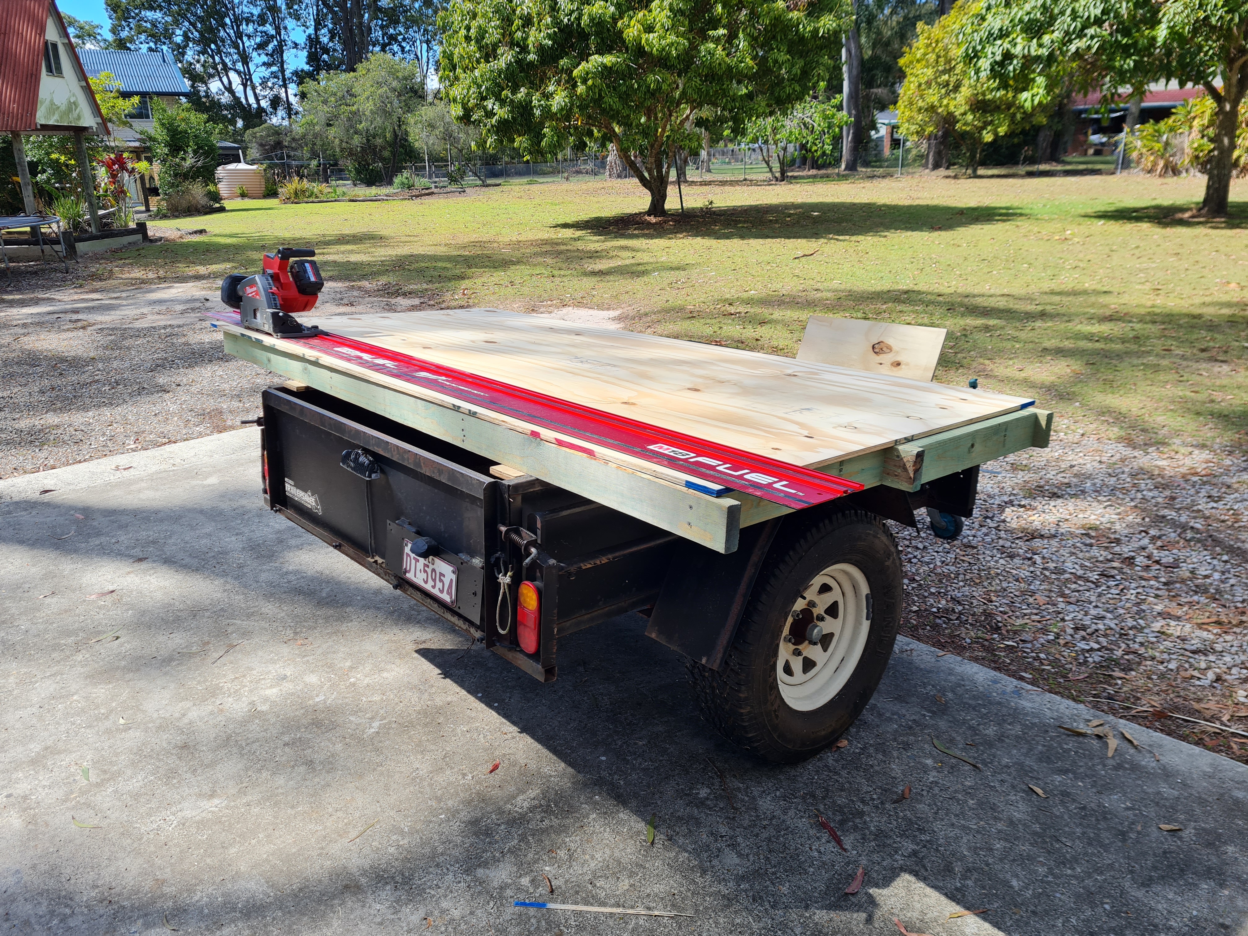

Here's a conveniently accidental mobile saw table for when l'm on a chopathon away from the house

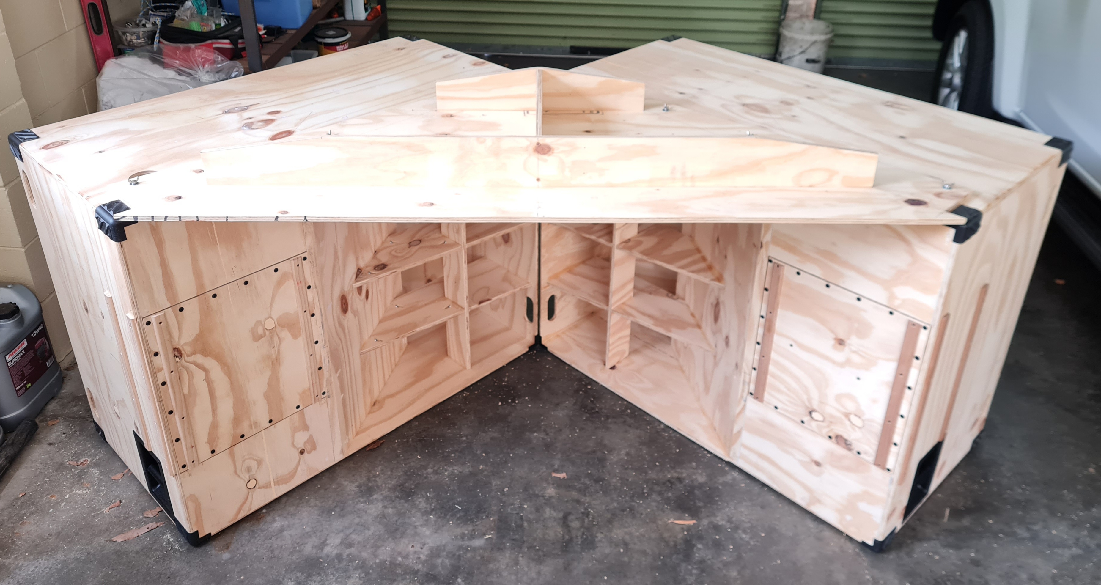

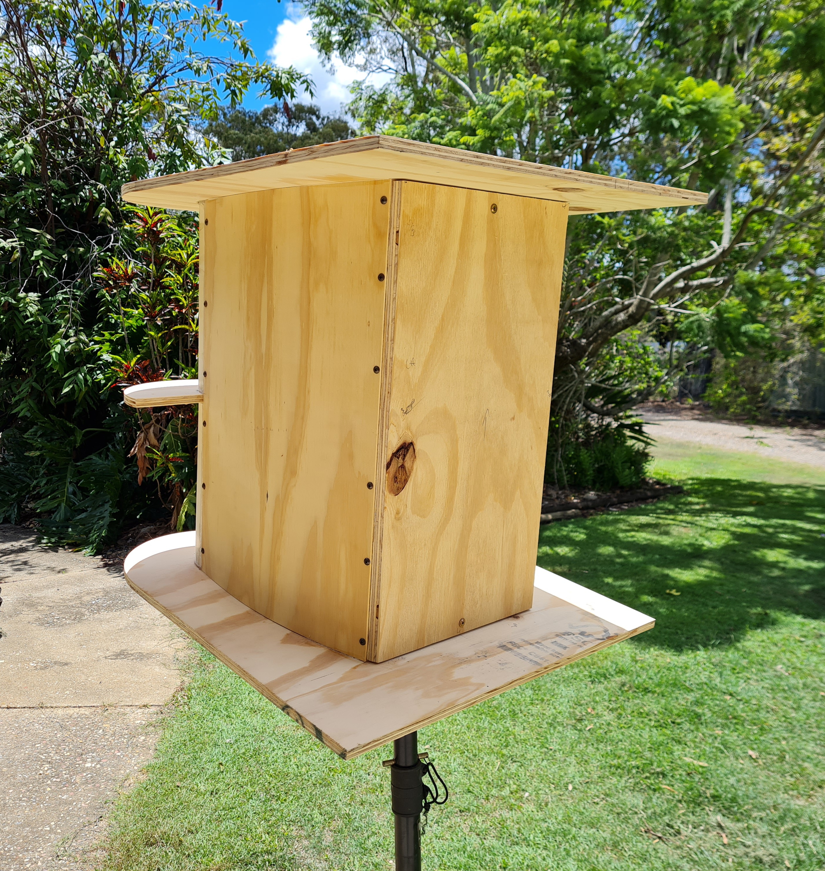

Great day for it lads, had time to do a bit this weekend, the piezo module kicked my butt last time.. we'll see how round 2 goes. Not including the finish & tune, feels like I'm over half way there. Hope you guys are doing well, cheers

Great look'n birdhouse you've got there

Seth wrote: Sat Dec 09, 2023 11:50 pm Great look'n birdhouse you've got there
😄 Mate it could double as one atm! Now l can't unsee that though, thanks very much 🙂
