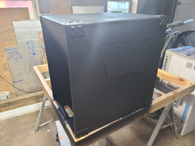

Been a bit, busy with a vacation week and camping on weekends, but cab 1 is finally done.
I've been listening to it a bit while on sawhorses and sanding/finishing. Hoping to break it in more, as I did not give it a full 8 hours of tones as recommended and I normally do. I ran each driver a few hours, and let music drone on them last two weekends I was home, while working in yard. Now the pair is complete, I've stacked them for now, next to my T48's. As expected, I have to turn them up two notches to match T48 output levels. I'm going to listen as is for a few days. Hoping to set the whole rig up in the driveway this weekend for a proper listen and thrash. I can see where I need to set a low pass, for sure there is more low end i'm not used to hearing in the garage with the Titans. Odd bits are rattling more, granted they are a foot or two closer to the back wall of garage, but also 2ft away from sidewall where Titans are parked. I have to say, I do like the low end on newer music, Rihanna and what not. I don't listen to much new stuff, but definitely some punch there. Also some classic rock has kicked a bit more i feel. That could be the Emperors New Clothes effect though LOL. We'll give them both a listen outside this weekend, with limiters set and low pass to get close to apples to apples.
