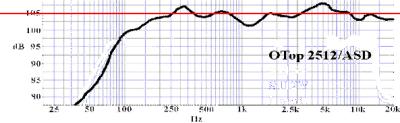

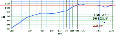

Okay Grant,
so looking into setting up the crossover as you suggested, I've made the charts that I think you're calling for as a reference for my adjustments. Is this about right? I'm a little skeptical of this endeavor because I'm using a different driver for my tops (F151M-8) and my subs are a different width, but I suppose with the high frequencies I can use the rta outside and get a decent sense of what the speakers are doing and adjust accordingly. These look about right?

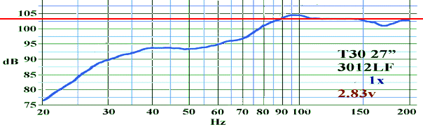

tactix wrote: Sun Apr 30, 2023 12:24 pm Okay Grant,
Almost!
Your pencil line has to be the average for the whole band pass, which in the subs is30Hz odd to 100Hz odd, so your pencil line would be around 97.5dB (rather than where it is at around 102dB) and across the graph.
Otherwise, yes, that's the idea.
Don't RTA anything until you have the EQ adjusted!
The idea is not to get your system response ruler flat. For now, you're just after near enough. You could elect to leave the troughs at 1K and 16-20K as they are.
So it doesn't matter if it's the F151M-8 or the ASD or the whatever.
Let us know how you go...
