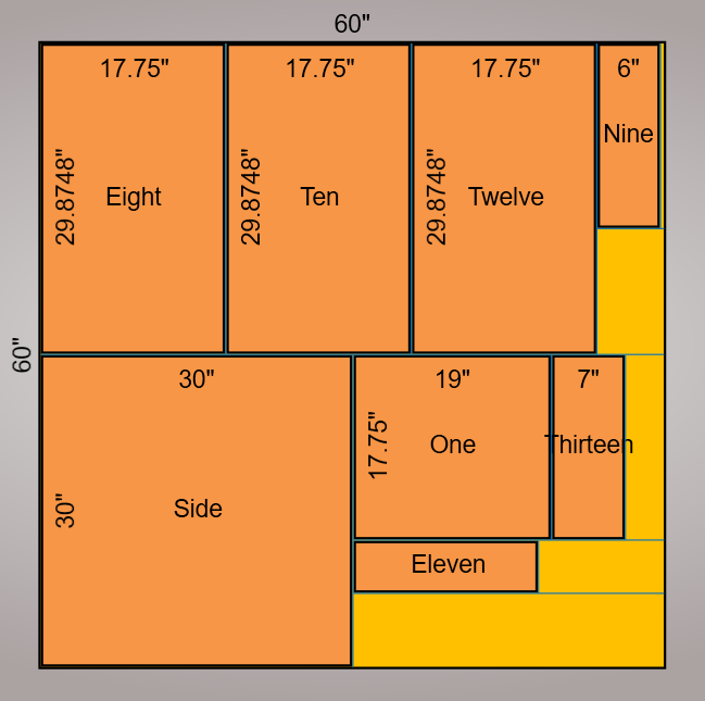

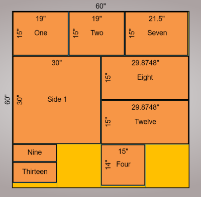

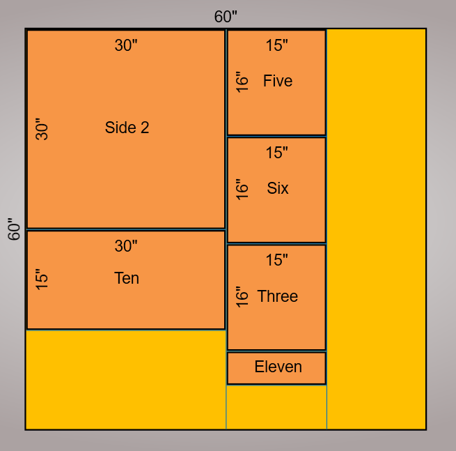

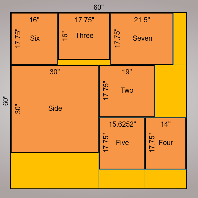

Alright, creative credit to Grant! Some interesting results. Since panels 8, 10, and 12 are all about a half inch oversize, I took an eighth off, still leaving them three eighths oversize for cutting to final size just prior to assembly.
This allows the sides and every part of the build to remain their standard dimensions. AND an 18.75" wide cab can be made from two 60x60 sheets now! It appears there may still be enough left to use for bracing too. If not, use nice stuff in the mouth and pretty much any sort of scrap for inner braces that are out of sight.
18.75" Wide Cab Cut Sheets
Or if there's a reason a 16" cab is the maximum width you want to build..
My opinion, always build as wide as you can, within your limitations. If the limit is keeping it on 2 sheets, go 18.75" wide.

The side panel mod shares that kerf, half of the eighth (1/16th ) on one panel and the other 16th on the other panel... maybe that's what makes it seem like I used 1/16" as the kerf?
Oh yeah, that's it.

Seth wrote: Sun Dec 18, 2022 10:18 pm Alright, creative credit to Grant! Some interesting results. Since panels 8, 10, and 12 are all about a half inch oversize, I took an eighth off, still leaving them three eighths oversize for cutting to final size just prior to assembly.
That is awesome! Thanks!!
