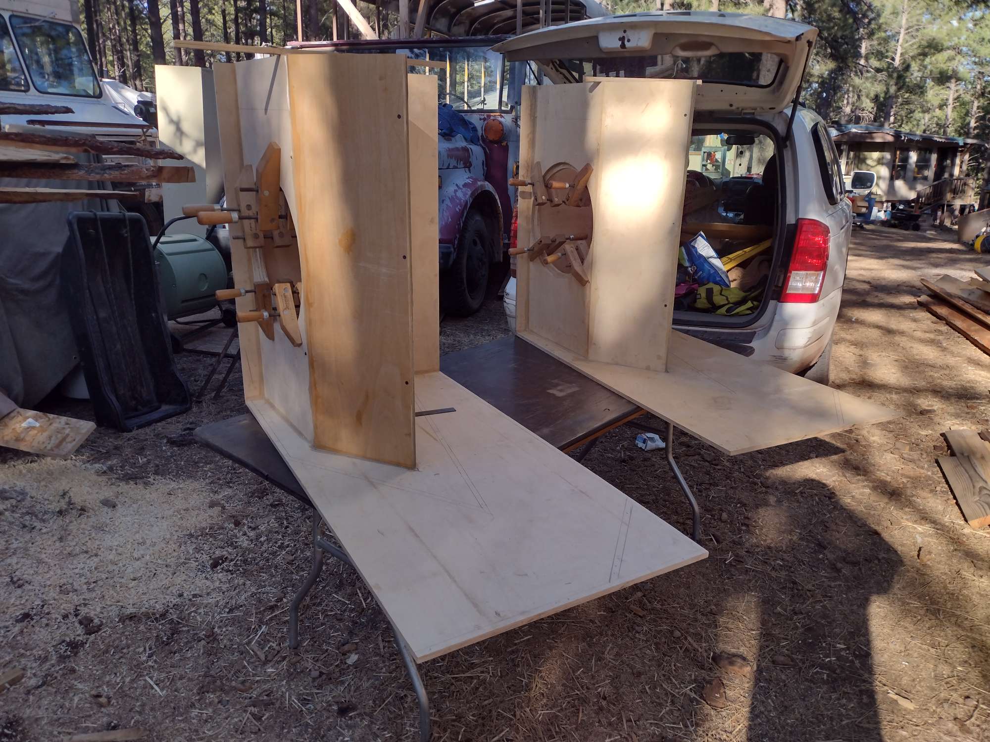

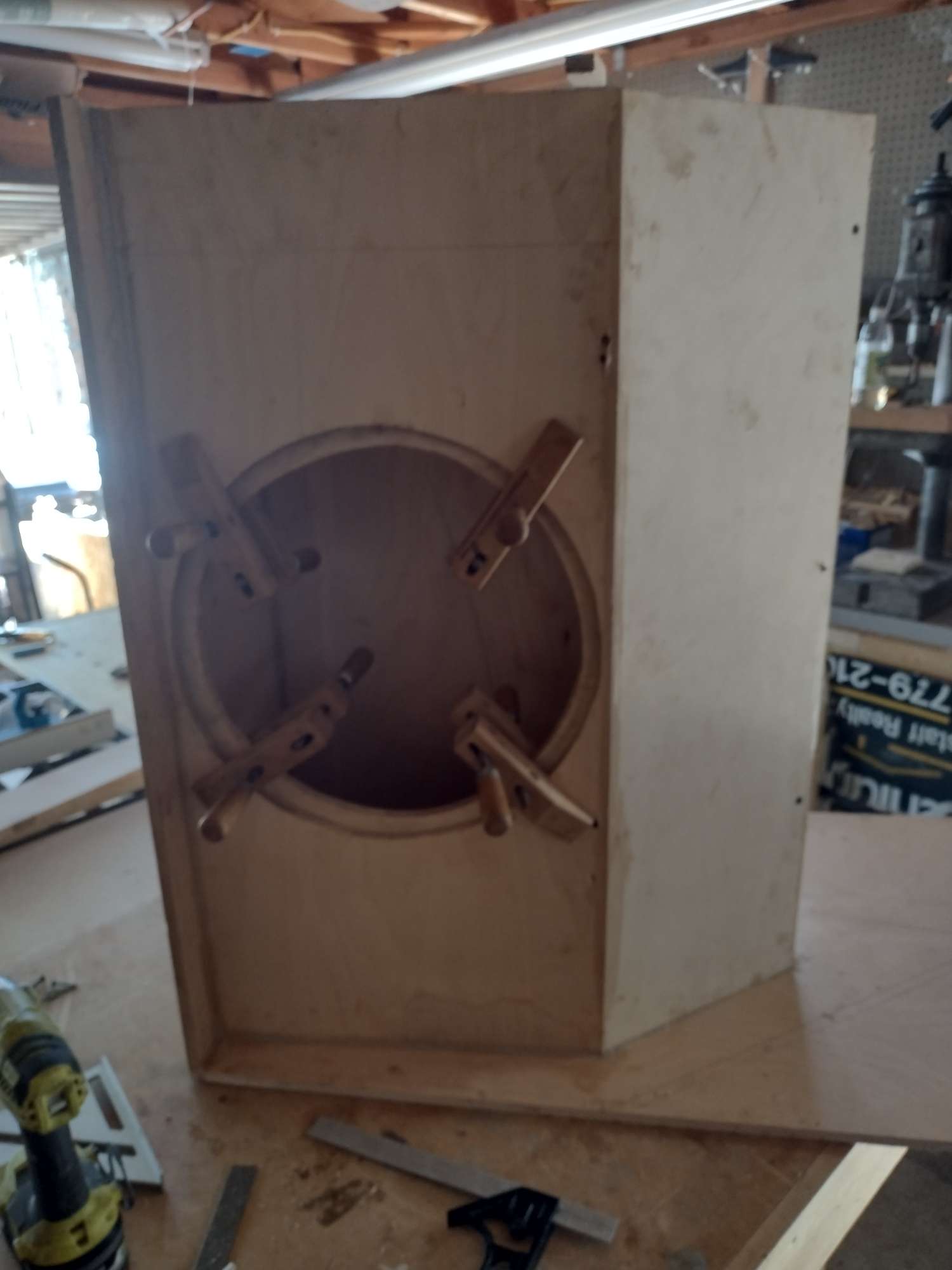

A lot of progress was made this week.
They are both as far as I can get them without buying more plywood.
I checked my local fancy wood store, and blthe 1/2" BB sheets are currently $65 here in Northern Arizona, and very available.
