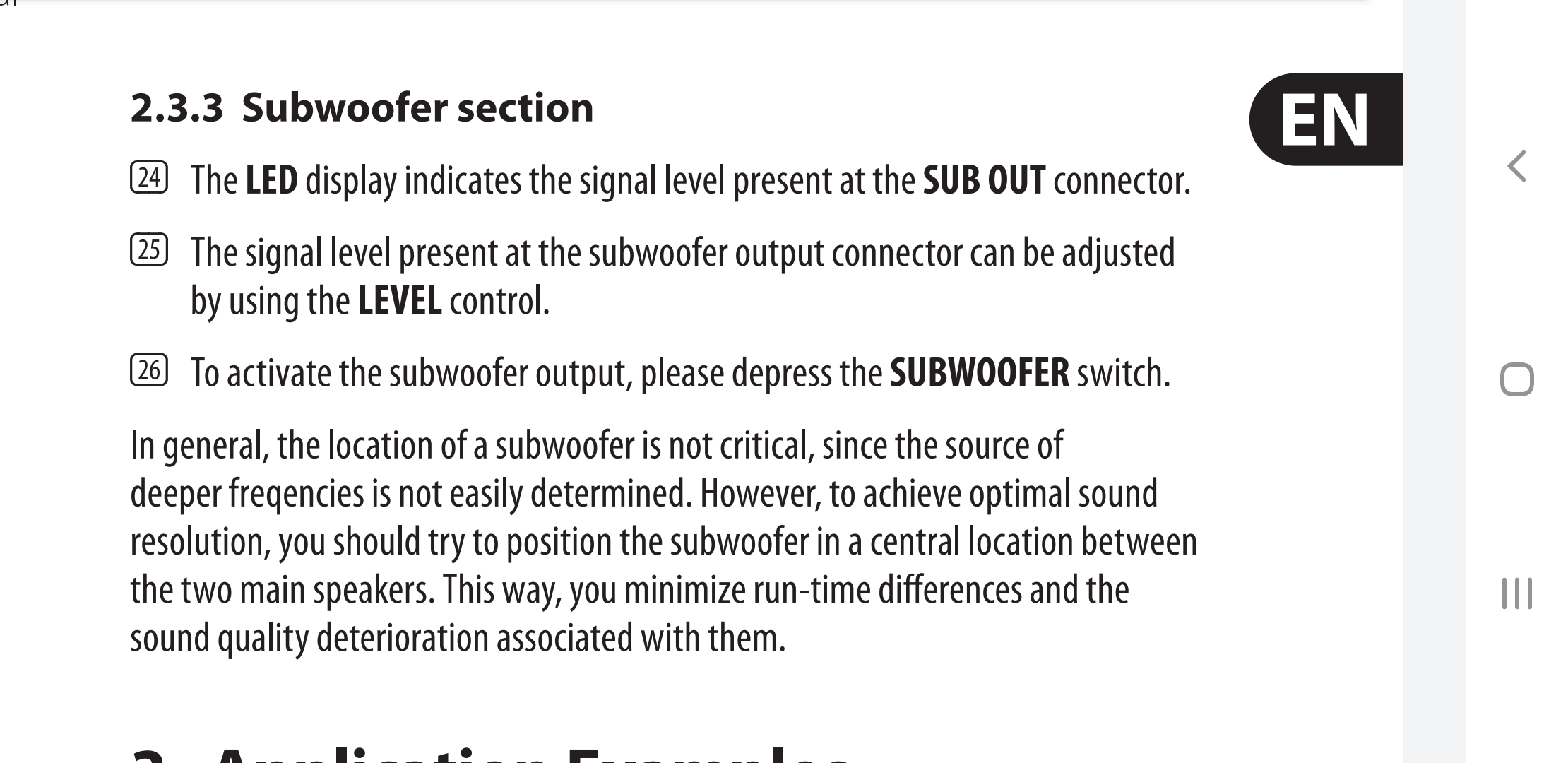

Re: Yet another newbie, sorry guys
Let's see if this works, a direct link to the pdf document titled Product Manual - English
I didn't look at Seth's link, so forgive me.
English manual:
https://mediadl.musictribe.com/media/sy ... 262750.pdf
In this, it says something like (because it's a protected PDF it won't let me copy FFS) :
16 Sub Out. This provides balanced XLR output to supply a summed mono signal to an amplifier for subwoofers.
17 Use the X-Over Frequency control to select the desired crossover frequency for the subwoofer.
(I would try 100Hz if your full range speakers can play below 100Hz)
The bandpass limitation enacted through the low cut filter also affects the frequency response of the subwoofer output.
So, if you were to set low cut at 100, and subwoofer crossover frequency was 100, you'd probably have no sub output...
English manual:

I feel certain that the sub out is just taking the signal after the EQ then sending it out based on the frequency selection. The mains are still running full range. So, it's pretty worthless....
