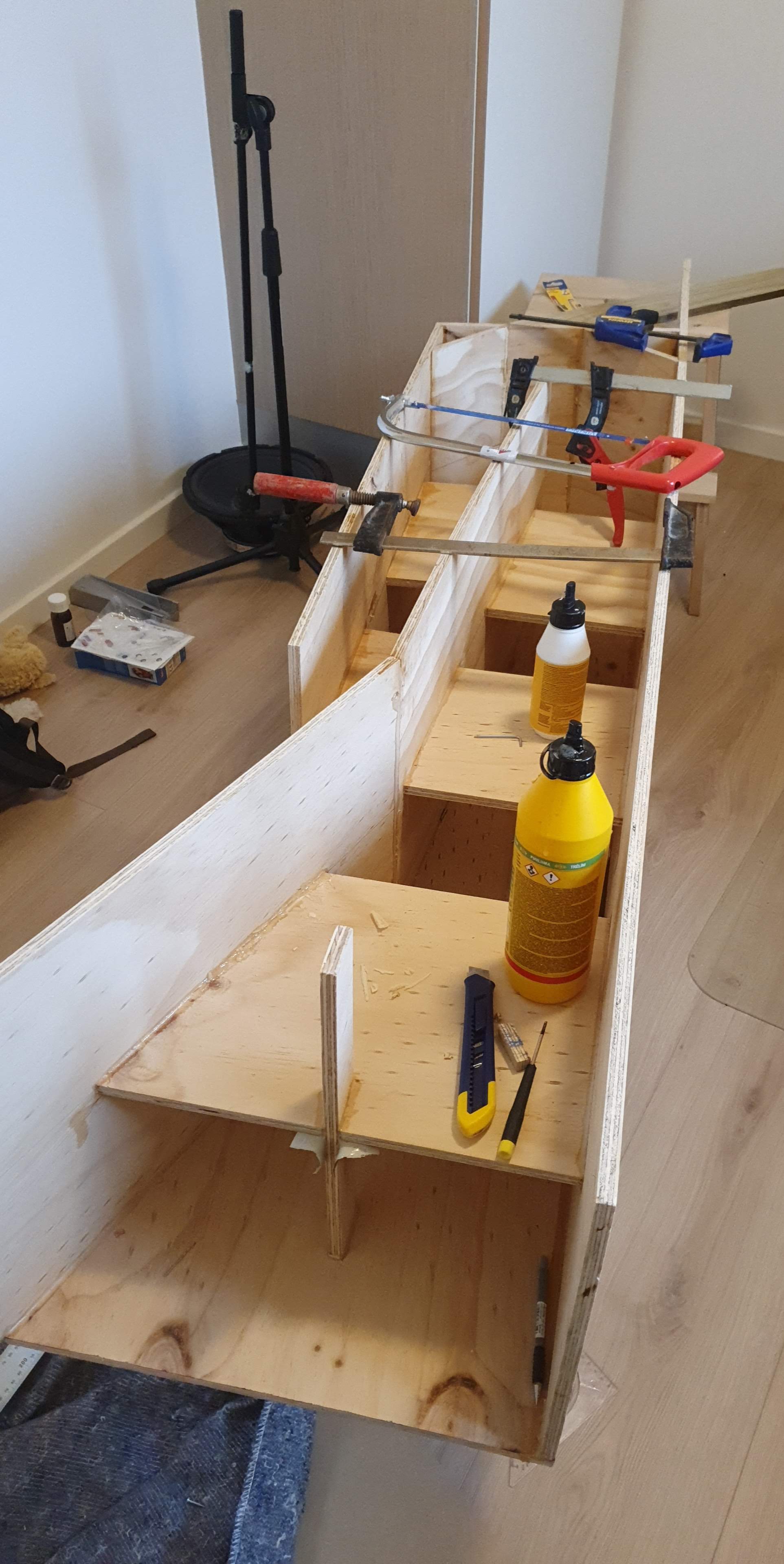

Quick update. I'm doing a panel a day - not much spare time to document the whole process.
It's really starting to shape up - But I'm still thinking about how I'll ever get the other side on. That warp is a pain.
I'll probably buy 2 clamps, clamp a wide upright board on top of the side - fasten it, move it, fasten it, move it, and so on.
I'm also thinking about splitting the side into multiple panels with 45deg sides. That way, I'm able to seal it on the go - making sure everything is perfectly sealed. Would be easier to trace the panels aswell.
Is this a bad idea? Why?

Just realised a big mistake. I alligned panel 7, so the distance is the same to panel 1 at the top as it is on the buttom. But with the first side curved, that won't be a 90 Deg angle. Panel 8 is attached to panel 7, which will give it the same "not"-90 Deg angle. Panel 10 can't be rectangular now, as it won't allign with panel 8.
This will also make it impossible to straighten the curve 🙄
Well. The horn probably won't realise that it's not rectangular 🤔
I'll fit panel 6 and 9, and then cut panel 10 to fit.
I'll then split the other side's into multiples, without 45 Deg angles, as the side will end up as curved as the first. I won't be able to fit the 45 angle sides together.
The will probably not be the prettiest THT. But I won't quit until it works 👍

A bit off square is only a looks thing. As long as all the joints are air tight your THTLP will be fine. Airtight is paramount.
Better have a sub that sounds good and looks just OK rather than the other way around.

Yup. Totally agree. And because of that warp, i'll attach the side panel bit by bit. Then I'll be 99% sure, that it's absolutely tight 👍

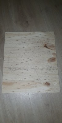

Baffle drawing. I don't have the driver, so I just have to hope that the dimension are accurate. They were on the Dayton for the TT, so I guess this will work aswell.

It is recommended practice to hold back on cutting and drilling the baffle until you have a driver to mark and test fit before the baffle is in the cab without you being able to watch it from all sides with driver test-fitted. The specs may be dead on and if you work very precisely you may have a perfect fit. If you are lucky. Or you may be 3 mm off at some point either due to sloppy specs/QC or your drill bit sliding just a tiny bit off the mark and have a hard time fitting a bolt or screw, or the cone of your driver hits the baffle edge. The importance of the latter is not to be underestimated as the woofer may show significant excursion.
You don't want to be :cussing: when you are so near completion.
