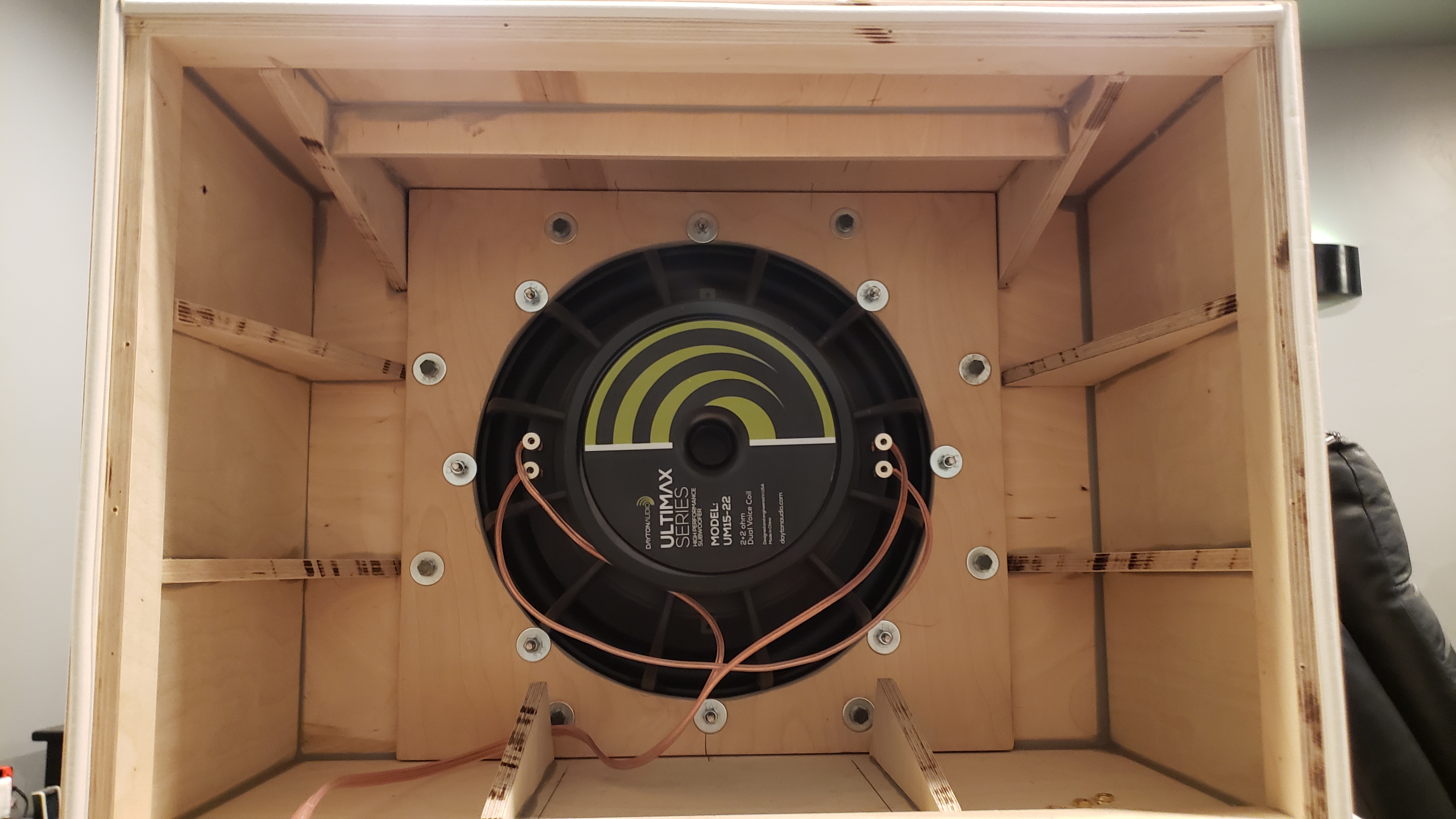

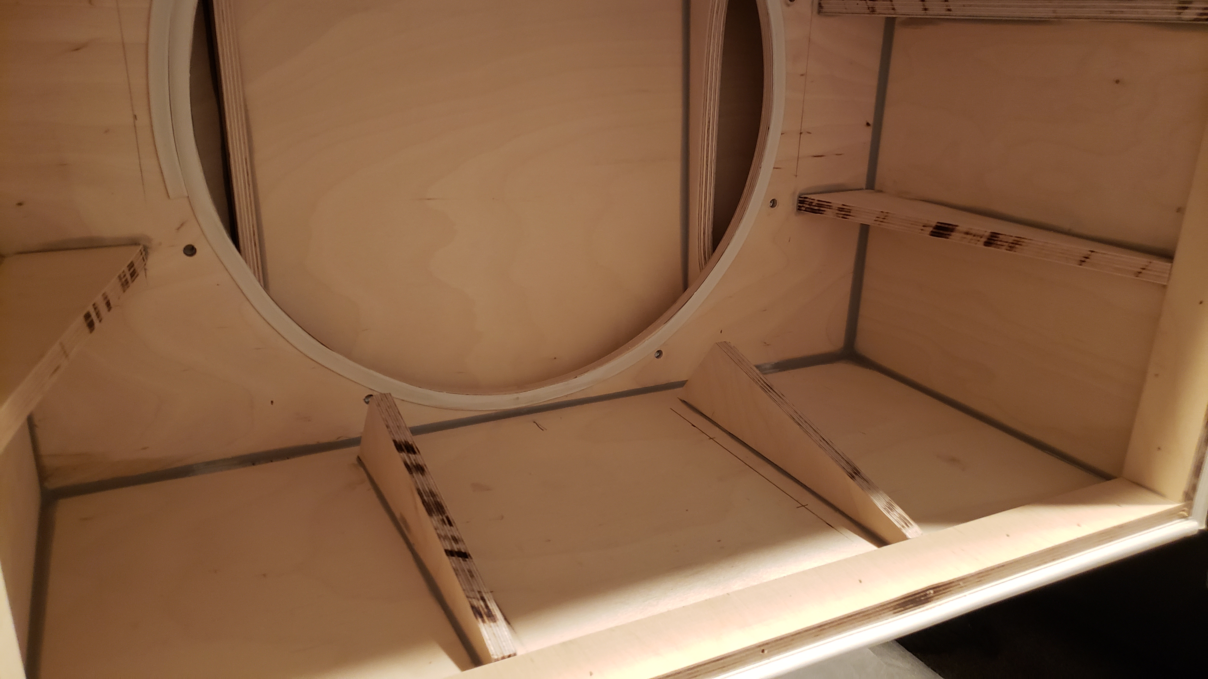

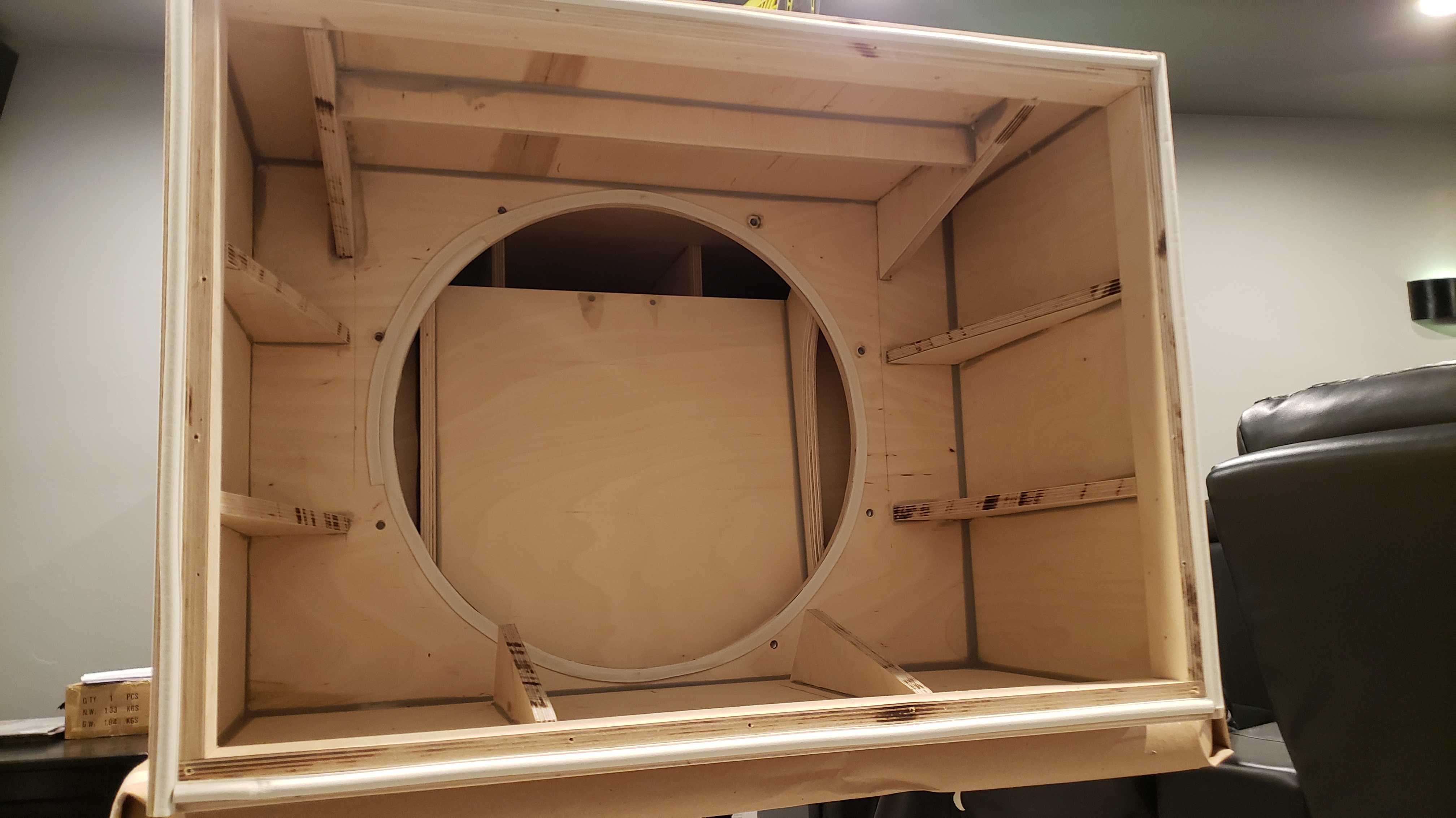

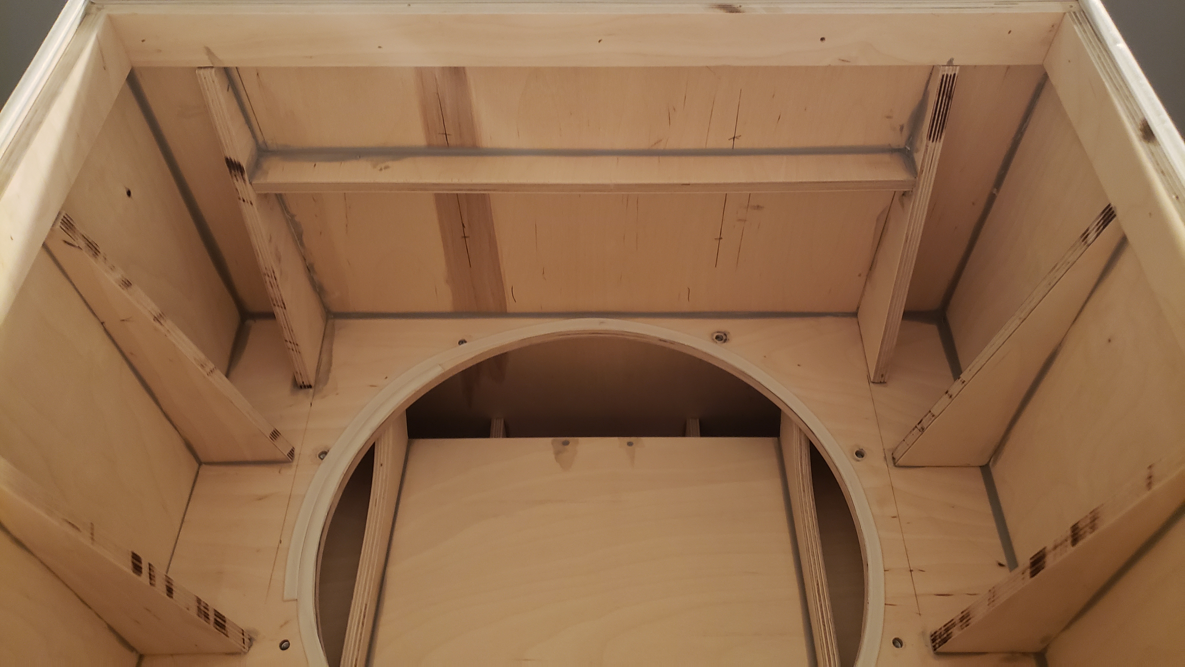

The chamber plate was fairly easy to put together. I just dry fit the braces in place crossing over the seam then clamped the two ends. Tonight, I'll cut it to size and install it. I'll be able to get full size chamber braces on the sides and have minimal reduction in size on the bottom braces. However, I'm thinking the top chamber braces are going to have to be cut back pretty far. Another option I thought of would be to add a second layer of plywood to the majority of the top (inside the chamber) and skip those braces. Would this be an effective option or should I just cut the braces way back?

This is what I ended up doing for chamber braces. I think it'll work just fine. I also drilled though the mounting plate and bolted the driver in with double nuts.

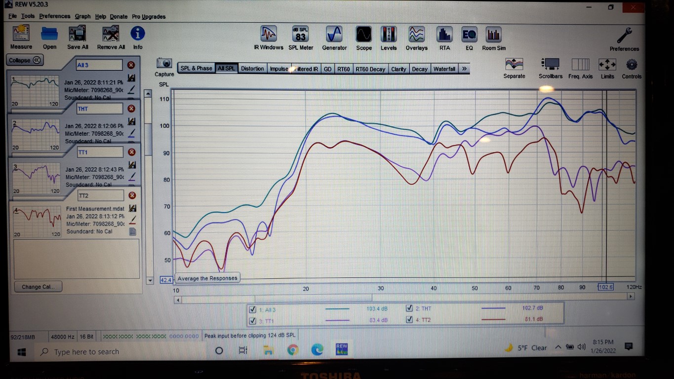

The mic showed up tonight. I've never used one and I need to pick up an extension cord. This is measured from about 5 feet off the back wall. The graph has one line for each... TT1, TT2, THT, then all three together.

How wide are those TT's?
They are measuring more or less the same as the THT 🙄 the THT is just louder, as far as I can see

What looks wierd to me, is that the TT's have a lower roll-off than the THT. Maybe it's a placement "issue" ?
It looks like your TT's is flat to 21 Hz or so.
Can you make a close-up measurement for me? Right in front of the horn mouth.

Sure, no problem. Right now I can only get about 10 feet into the room. I'll measure it when the usb extension cord shows up.

JensToft91 wrote: Thu Jan 27, 2022 9:42 am What looks wierd to me, is that the TT's have a lower roll-off than the THT. Maybe it's a placement "issue" ?
Anytime you're measuring in room the result is very much determined by the room, the speaker placement and the mic placement. For example: http://ethanwiner.com/believe.html
JensToft91
Posts: 140
Joined: Sun Feb 28, 2021 6:43 am
Re: THTLP Build
#44 Post by JensToft91 »
Bill Fitzmaurice wrote: Thu Jan 27, 2022 10:17 pm
I'm aware of that - which is why I said, it could be a placement "issue". It's not an issue, that the TT'S go low. I just don't understand why it goes as low as the THT, considering, that the curves are very similar. It doesn't look like there's any big peaks or nulls in the 20-30 Hz area - the two responses are equal.
This doesn't have anything to do with believes, even though that's a great article. This is a measured response - and I'm asking directly for a close-up measurement to see if it really is the room that equals these subs.
My TT turns on like a switch at 28 Hz or so, no matter where I put it. And it shows exactly that, when I put the mic infront of the horn mouth. I know that's a wrong way to measure it - and it will gain more extension in-room.
But I expect them to show different responses, the THT rolling off slightly later than the TT - per design.
It certainly haven't failed me to use this method.

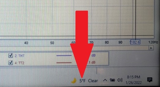

Posts: 3069
Re: THTLP Build
#45 Post by Seth »
Nice curves. But what about that awful dip?
What dip, you ask...
That dip! Crikey!
Are you guys eating seal steaks and walrus burgers, or what! Brrrrr.
