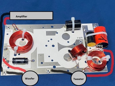

Man. Now I get it. Thanks for the detail sketches. I would have probably never figured it out.
Re: Otop 8 future build
It took some concentration for me to figure it out too. The extra cap was the first head scratcher. I assume they're 4 Ohm crossovers and the 20uF cap value was achieved by combining caps of smaller values (the two on the right) in parallel. Then it was just a matter of figuring out how the coils were routed. More than a few minutes passed before I connected all the dots, so don't don't get down on yourself for not seeing it too.
Will have updates and pics soon. Thanks again for the info.
Sorry, I usually label on the back of the boards what goes where.
