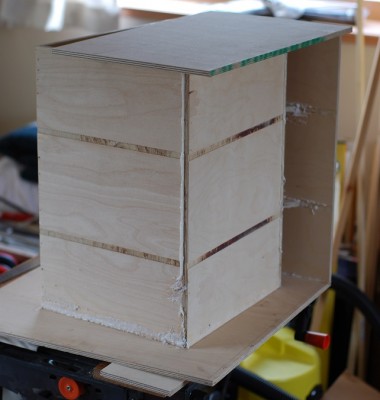

Pleased with the progress today. Got panels 3,4 and 5 in. 6’s are cut. Everything is lining up really well. I put some little guide blocks on the baffle to make lining up the drivers spot on when the time comes. Need to find my stash of popsicle sticks. Going to glue them in as guides for the braces to make it really easy to drop them in position. Need to borrow my friends biscuit cutter to join plywood for panels 7, since my pieces are a couple inches short. Did that last time and it worked well.

himhimself wrote: Sun Mar 28, 2021 3:32 pm Need to find my stash of popsicle sticks. Going to glue them in as guides for the braces to make it really easy to drop them in position.
Now, why didn't I think of that?! :clap:

I use strips of an HDPE cutting board that I cut up to use a jigs and guides. PL wont stick to it. I just tack them in place with a couple brads then pull 'em out with a flat head screwdriver once the PL sets. Although, popsicle sticks sounds like a fantastic idea. Light weight and can just leave them in there and not have the step of removing anything. I like it!

Well crud, no idea where the pack of popsicle sticks went. But......... I found coffee stirrers!!! :hyper: Even better, they're longer and narrower. I glued and tacked some in and it looks like they will be perfect to drop the braces onto. Also cut my panels 7s now that the biscuited glued up edges have cured. Next up will be to install panels 6 and 7 - perhaps tomorrow.

Coffee stirrers glued up on panels 7 and down. Will make braces from my pile of 5/16" 6-ply baltic. Haven't yet decided if I'll do long ones like last time, or the multiple short piece version like shown on sketchup. We shall see. This thing is so sturdy and flat so far, braces almost seem unneccesary, but I SHALL FOLLOW THE PLANS. Hasn't failed me yet :wink:
Also seriously considering just a single access door. I think I'll have enough room to mount the 3012s from one side without much difficulty. Part of the reason I already put in the little blocks to align the drivers when the go in.

Had enough PL to pop in the 5/6 braces tonight. Coffee stirrers worked like a charm, soooo much easier than the way I fought with them last time around. Just slid them in on top which kept the perfectly level, couple pins, and done.
