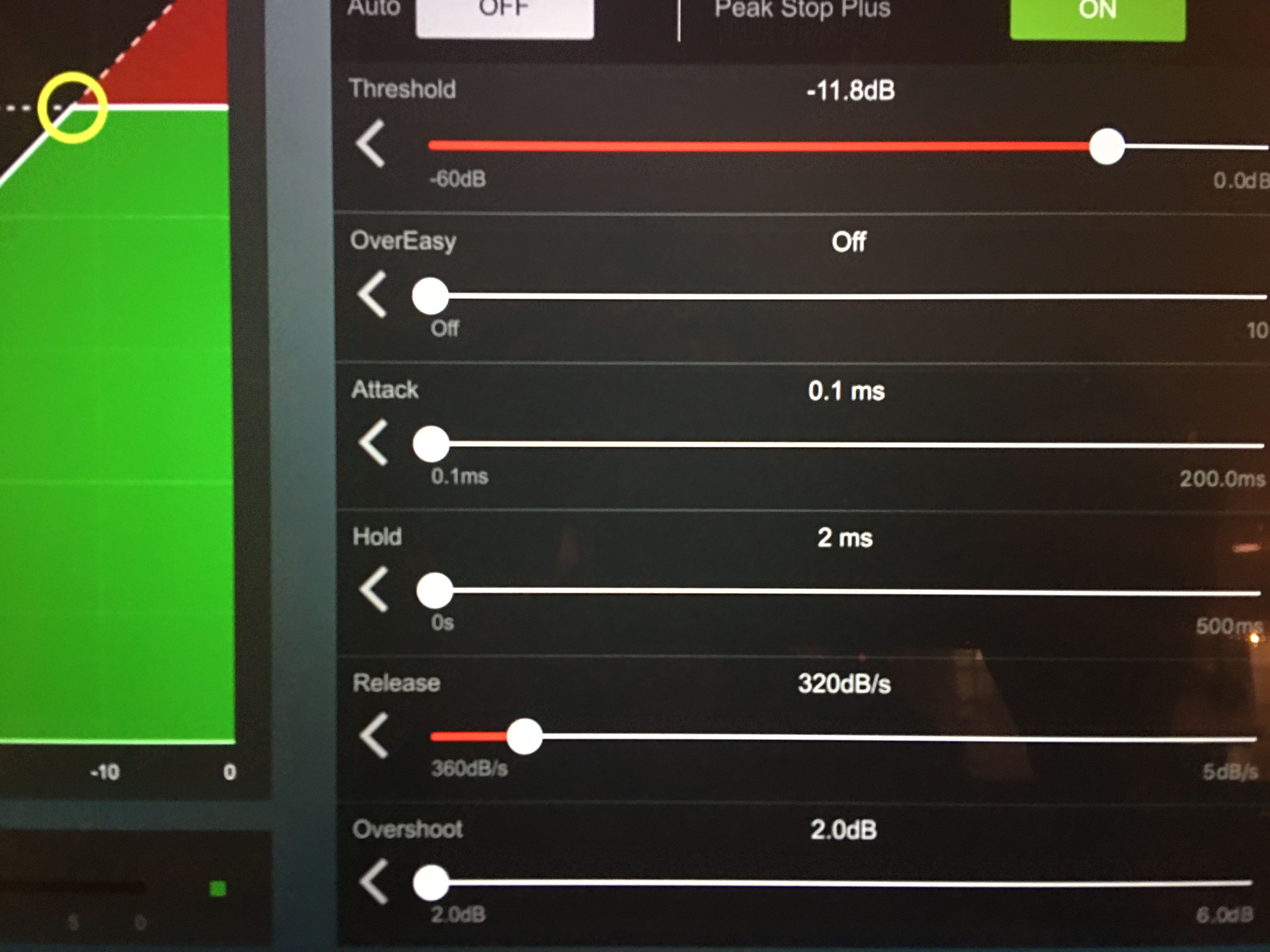

So, what should I have these parameters set to? Should I just set to “auto” and leave alone or is there a more optimal setting?
- Posts: 8678
Re: T45 Driver advice
No one can tell you what settings to use.Pabloaguas wrote: ↑Sun Feb 21, 2021 6:10 pm So, what should I have these parameters set to? Should I just set to “auto” and leave alone or is there a more optimal setting?
You MUST use a voltmeter on the power amp output while playing a 60hz test tone with your mixer output run up to unity and your power amp all the way up. NO SPEAKERS Connected!
Then you adjust the limiter until the output is whatever your voltage limit is. Once you've done that, while watching the volt meter - push the master fader all the way up. If the voltage stays at your limit, then you've set it properly. If it runs past the limit, then something is wrong - start over.

Bruce Weldy wrote: ↑Sun Feb 21, 2021 6:38 pmNo one can tell you what settings to use.Pabloaguas wrote: ↑Sun Feb 21, 2021 6:10 pm So, what should I have these parameters set to? Should I just set to “auto” and leave alone or is there a more optimal setting?
Yes, I used the multimeter, but had it connected in parallel with the driver. Why would I want to have the driver disconnected for that? Seems that I would want to measure the voltage drop on the driver rather than the voltage of the amp struggling to just push through a 10M ohm meter...

SS amps deliver the same voltage into any impedance load,including the high impedance load of a meter. You can set the limiter with the driver connected, but the result is the same, and disconnecting the driver is just a wee bit quieter.

Because if you didn't get the limiter correct, when you slam the master fader all the way up, you could fry the driver. Did you actually push the fader up to see if the limiter held? If not, then you don't know if you did it right.Pabloaguas wrote: ↑Tue Feb 23, 2021 6:34 am Why would I want to have the driver disconnected for that?
We all harp on the limiter business because we are trying to save you from a big mistake. If you have questions about the procedures, it's a good idea to ask before doing it a different way and blowing up your gear.
