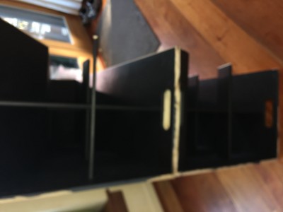

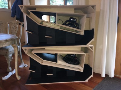

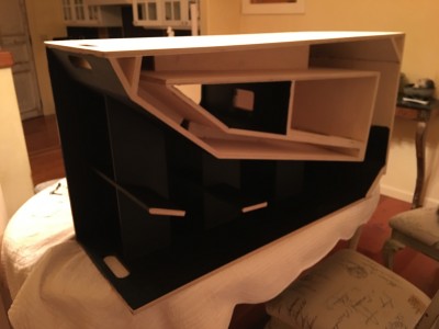

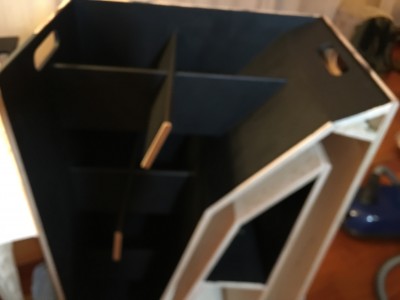

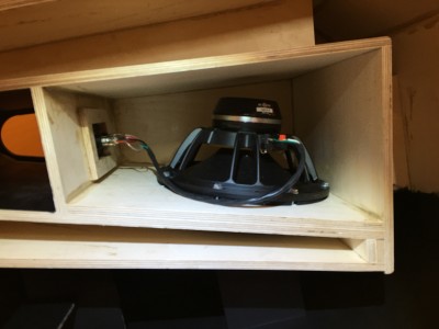

More pics before lids go on
Re: Tuba 45 Build
Paul and Rob... that's looking really good.
What a great job. The build quality is very apparent in the photos. I really hope the results meet your expectations, given the few modifications to the plans.
One thing I thought I'd mention... it's not something I've experienced personally, but it's come up in conversation a time or two. You'll note that the plans advise screws to secure the drivers. IIRC, the plans were modified a few years back to screws and retention blocks, from bolts and hurricane nuts because they hold better without backing out as much and they wont cross thread, push out the back side, or strip and spin as easily. I was thinking thread locker would be good to keep them from backing out, but it could also contribute to spinning the inserts at a later date. What's done is done, and I'm sure you'll handle it appropriately if it ever becomes an issue. Really, I just mention it for the benefit of casual viewers/future builders to be aware of.
Other than that little tidbit... I'm super excited to hear of your impression once they're all buttoned up, painted, and tested/in service.

Yes, we went with the double baffle and 1/4" lag bolts. Torqued them to 5.5nm. They do not protrude through. They should hold fine as long as the gasket on the woofer doesn't shrink...

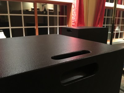

Final coat curing:

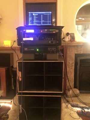

Re: Tuba 45 Build
MIND BLOWN!
Dang these things sound good! And loud! Haven’t gigged with them yet but they sound great and powerful in the living room. Might even sound better than my old ACI Titan II Le. They really have that concert bass sound like horns that professionals use at large concerts. Sound is clean and responsive down to 30hz with a simple 6db boost at 30hz. Can’t wait to gig with them!

Re: Tuba 45 Build
What is the high pass for less than 4 cabs with T45's?
I see a pic of a driverack, that's great.
I'm assuming the high pass is the same as T30's, 35Hz for less than 4 cabs.
If you're high passing at 35Hz, but boosting 30Hz by +6dB (double the power) is AFU
If you're high passing at 30Hz, with less than 4 cabs, is AFU
If you're really "needing" 30Hz at +6dB, add two more cabs, high pass at 30Hz, and you will have it, but that will also raise everything else by +6dB, so where does it stop?
I can't see the point in employing someone to build your cabs, then keep on blowing up drivers, because that's what will happen.
Sorry to come on so strong about it, ask as many questions as you like, but a show with no subs all of a sudden will hurt somehow, pocket or reputation...
