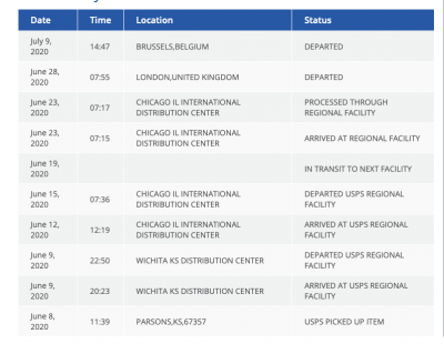

Haha my humble apologies for that... Meanwhile I'm patiently waiting
- Posts: 8678
Re: New Jack 112 build
Damn....we are spoiled over here. I get stuff in 1-3 days with Amazon......2-5 days with FedX or UPS depending on where it comes from.....
I hate to say that things from China arrive faster... But then their shipments are sponsored by the country itself it appears...

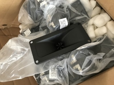

Finally arrived...
