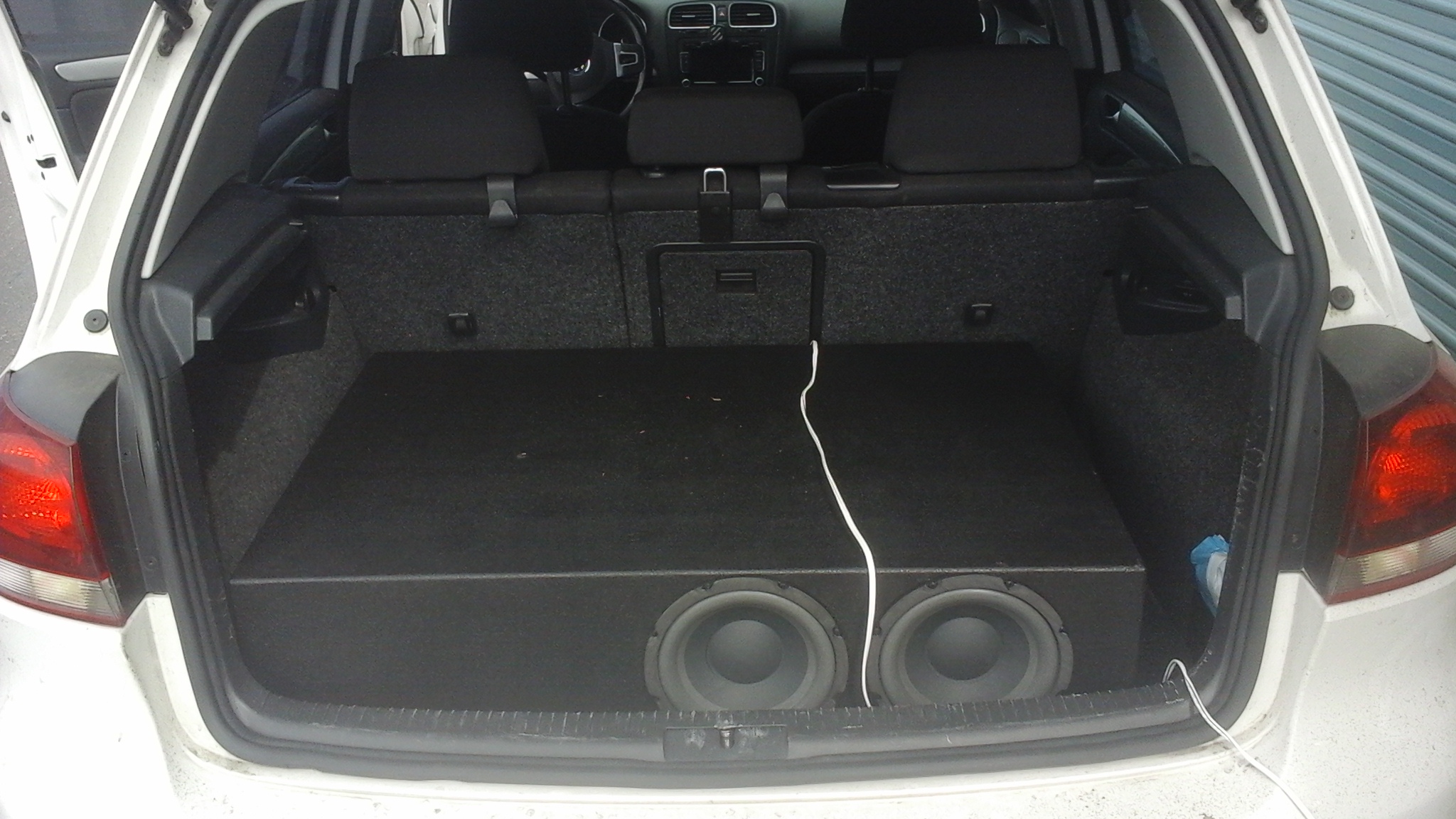

Good job Seth :clap: If I built mine like that then I could still pile all my junk on it in the back of my suv
Posts: 3163
Re: 8" vs 10" truck Tuba
#32 Post by Seth »
jimbo7 wrote: Thu Apr 30, 2020 9:17 am Good job Seth :clap: If I built mine like that then I could still pile all my junk on it in the back of my suv
That's what had me choose the TruckTuba over the standard AutoTuba. An AutoTuba would fit, but I felt it would consume too much floor space in the hatch area, where the TruckTuba would essentially just raise the floor. We'll see, but this should work well for me.

Yeah it looks great indeed, but the million dollar question is: we wants to know what it sounds like in the vehicle. You hooked it up yet in the SethMobile?
Posts: 3163
#34 Post by Seth »
AntonZ wrote: Thu Apr 30, 2020 5:58 pm Yeah it looks great indeed, but the million dollar question is: we wants to know what it sounds like in the vehicle. You hooked it up yet in the SethMobile?
I don't have an amp in the car yet, but yes... I couldn't wait. I set the limiter for 25 volts (a little higher than rated) on the Ashly amp and put the cab in the car.
Outside the vehicle it's not impressive at all. Which is just fine by me. Inside, it's pretty insane. Literally mind numbing. Flexing doors and hatches. It's very impressive. Plays sub 20Hz content like a boss. At 25v, it's waaaaaaay more than I'll need to augment the factory sound system.

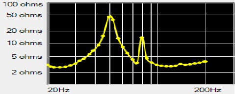

I wired the drivers in parallel, which should be roughly a 4ohm load after adding the cabs impedance. I ran an impedance sweep to verify.

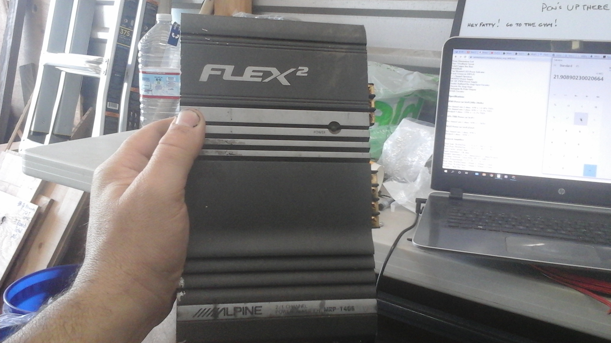

I've had this old Alpine amp kicking around for a long time. I've never used it and don't even remember when, where, or why I acquired it. It's definitely been used by someone somewhere. It's rated 40wpc @ 4ohms or 120 watts bridged @ 4 ohm. I think it will be plenty, if not excessive for my current needs.
So, I had the lumber, I had the drivers, I had the amp... this is like a free upgrade :cowboy:
