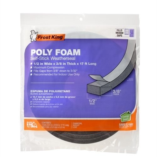

For the jack panel and access panel I use foam weather-stripping that you seal leaks around doors and windows. You can find it in any hardware store. 1 should be plenty but get 2 since it's cheap.
