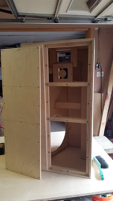

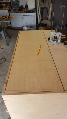

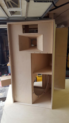

Latest progress:
Back is cut and here I'm marking the hole locations. Back flanges, internal braces and horn installed. I've also installed t-nuts in the flanges to hold the back on. View from the front. I made one sanding pass to see where are all the spots that need filling with bondo.
After letting the large driver play all night on the bench with a 30hz tone at about 11 volts, I noticed a slight buzz that seemed to be coming from somewhere near the outside edge of the cone. Couldn't really identify exactly where. I'll turn it on again this evening and see if it's still doing it.

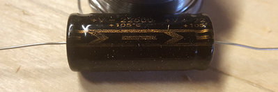

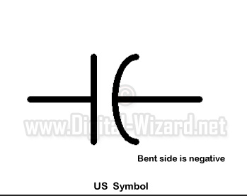

Another noob question. The schematic for the bandpass crossover appears to show the negative end of the 22uf cap connected to the positive input from the amp. The capacitor I bought is polarized. Is there any issue with connecting the negative lead on the cap to positive input?

Have you ever picked a dandelion and then held it in your hand and flicked off the flower? Cause if there is more than 3 or 4 volts going the wrong way through a polar cap that is what happens to the top of it. As audio is AC it gets current in both directions. I don't have the plans in front of me but I would double check to see if a polarized cap is acceptable.The capacitor I bought is polarized. Is there any issue with connecting the negative lead on the cap to positive input?
https://www.parts-express.com/ruby-gold ... r--020-668
Re: Joe's Omni 15 Tallboy
The plans use this capacitor symbol on the schematic which is polarized. the plans don't specifically say polarized or not but they do mention electrolytic which I believe are normally polarized. At least the ones I bought are.CoronaOperator wrote: I don't have the plans in front of me but I would double check to see if a polarized cap is acceptable.

Crossover caps are never polarized.
I'm disappointed with parts express. All the caps I bougt from them look like this: Notice the arrow pointing to the negative lead. Guess I should have bought parts from Leland.Bill Fitzmaurice wrote:Crossover caps are never polarized.
