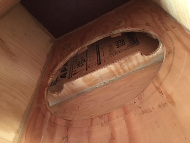

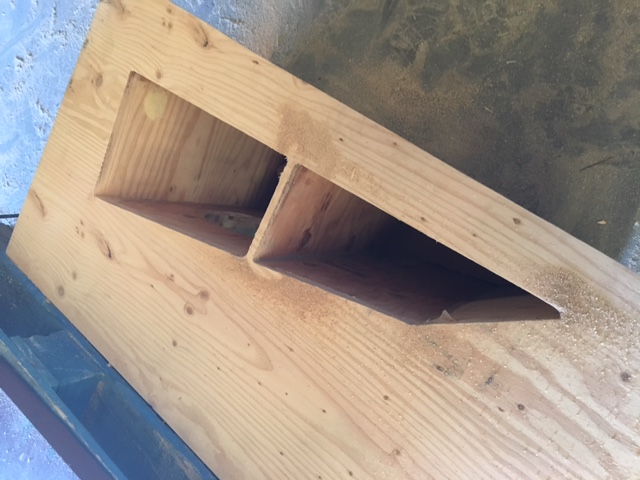

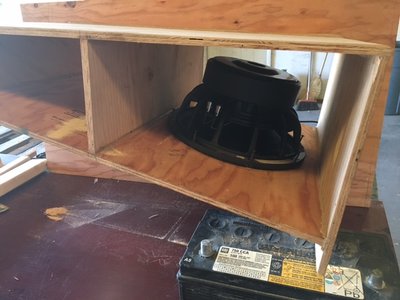

with my flush trim i cut out the driver chamber access hole, test fit my driver and verified the screw holes were all properly aligned. I believe that I will be using some caulking after i secure the driver to ensure that i get a proper seal between the driver and the cab. will be damping down the work pieces today to see how that reacts to the PL.

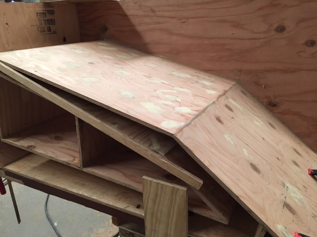

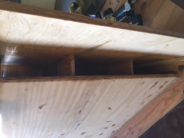

found it a bit tricky at first to get the bracing to work for me but with some gentle sanding i got the fit i wanted, i think i ate more PL than made it onto my work piece today :noob: . I notched the internal brace for the driver surround in the event of some high excursions. PL seems to be working out for me and i cant exactly explain it but damping the wood seems to help or at least i will keep doing it i mean it is not hurting it.

Man, that LAB12 looks really good in there!

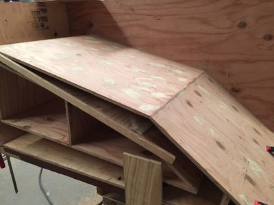

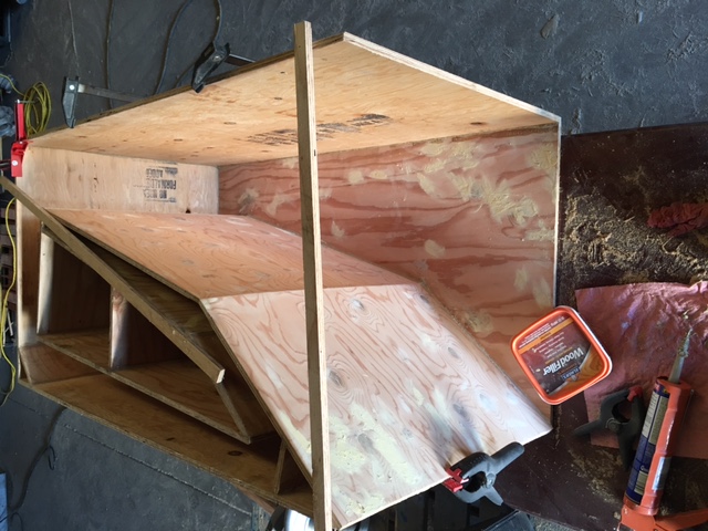

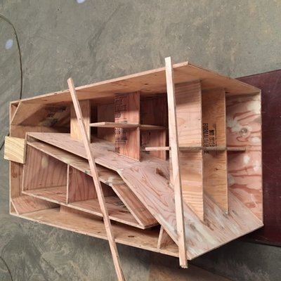

I installed another piece, braced it up, cut and installed the top, used clamps to hold part in place, used some boards to align pieces, i have been filling voids and holes as i go trying to avoid leaks and problems in the future. i discovered that my skill saw can cut up to a 55degree angle that is cool, will work to brace top piece tomorrow,

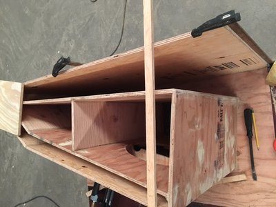

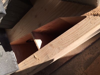

installed some bracing, the larger the horn throat gets the easier it is to work the bracing in. i am having better luck with the PL now that i am damping the work pieces better, i am getting better at gauging just how much to use i could see after a few builds getting good and being able to make the work look clean, for now i am making a PL mess like a proper noob should, i enstalled another wall and braced it and added the 45degree piece, i am going to sand a bit and wood fill from here on so that when im finished i can paint the inside with out worrying about anything, for the record i have opened up a new tube of PL and i wanna say that this batch of PL is seemingly better, stickier out of the tube and seems to set faster.

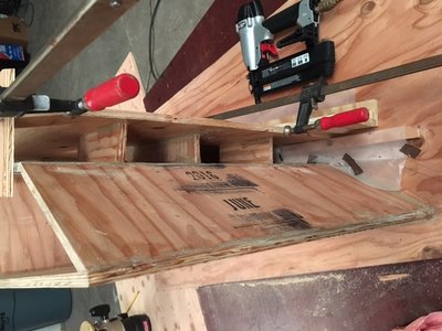

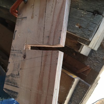

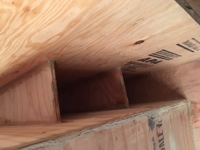

i cut and installed the bottom, this tube of PL sets up way better than the other tube i had, and i keep using damp rag over the glue joints its working better for me, the joints dry harder faster i am really happy with it now!!! im getting more comfortable with the expansion rate of the PL and i am making less and less messes, i made my final panel bracing well some of it, i used a flush trim to make two identical braces and nailed them together after that i used my hand held jig saw and cut out the section for the cross brace, i am still rounding over the bracing, at this point its aesthetic, everything fit nice,

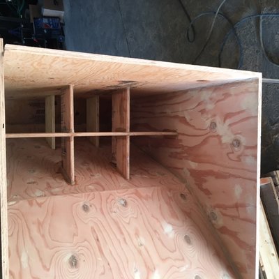

final bracing in, i used same method with the cross bracing and it worked great, next will be the side, then router out the access panel, its coming along!!!

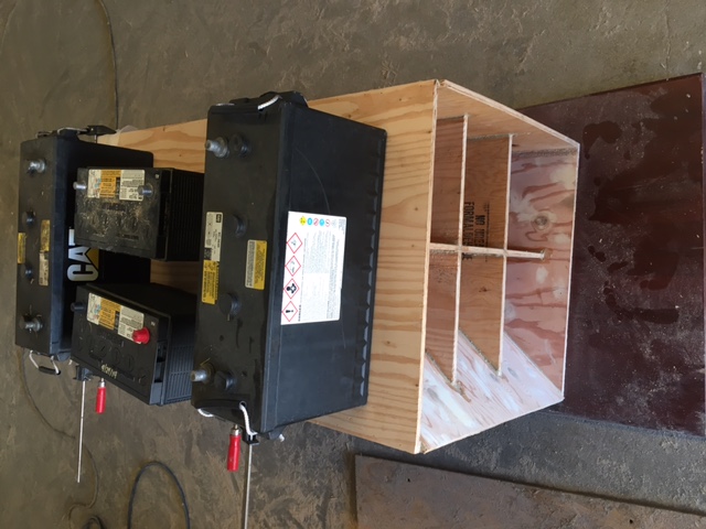

i put the side on today, used some heavy batteries to try to ensure a proper tight fit on all of the joints, this part scares me the most because there are joint edges that i have no access to, i made sure and used a lot of PL just for some piece of mind, i had to use some clamps to get the box to square up to the side, its not bad i have had worse out of square situations, next time i may not cut the final side to size but leave maybe a half to quarter inch extra all around and then glue it on that way and just flush trim it to proper fit, the box is not absolutely square but i dont think it will be that easy to notice. PL is setting pretty well by about 5hours at this point definitely better than what was happening when i started.

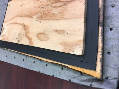

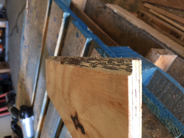

i wanted to test the strength of the PL as i am new to using it, i took one of my 90degree jig fixtures and put it in a vice, used a pipe wrench and broke the 90degree glue joint apart, picture shows that the first ply of the wood broke off and the plywood adhesive was the weak link, the glue joint tore off the first of the 5 plys leaving the glue joint with PL still intact. i would be a fool not to believe in PL after that :fruit:

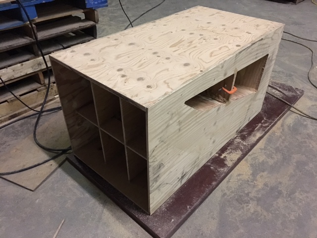

thanks dan, no clue the weight and i have no way to weigh it exactly, i used my router to cut out the driver panel access panel, i flush trim cut the extra little bits of material off of the final side panel to make it look clean, i also cut the hole for the speakon connector, doors next, some sanding too i suppose...

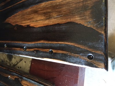

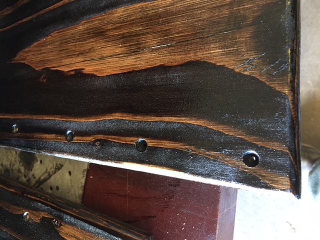

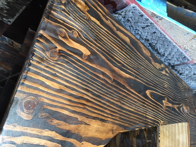

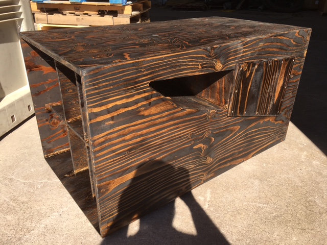

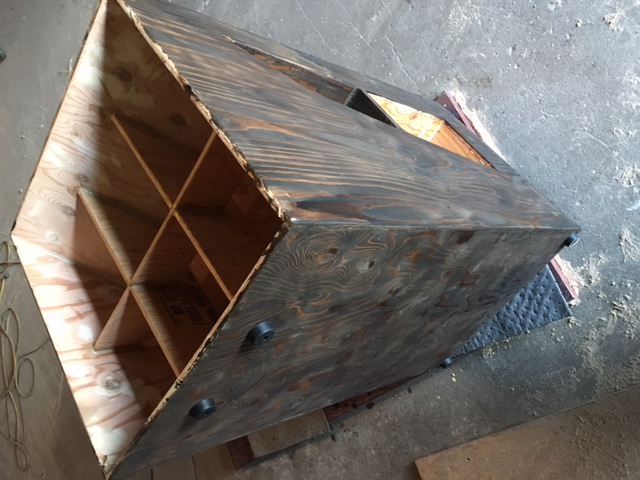

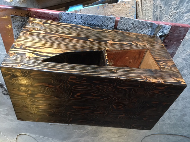

i decided to stain the cabinet because its cheap and different, i went with a dark jacobean, i installed the feet to the enclosure, man now that i stained it it looks like some 80s psychedelic zebra box!!!! hm oh well i guess i could always paint over it down the road, i like bedliner personally but its pricy.

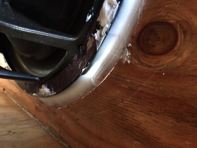

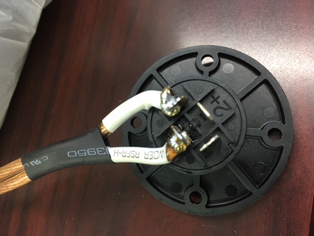

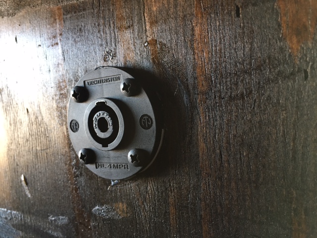

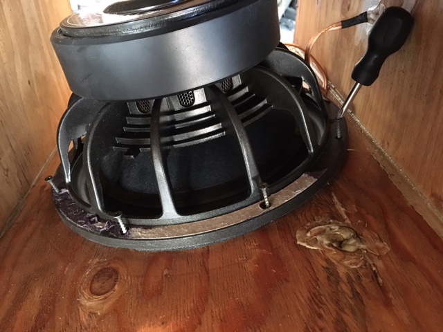

i counter set my pilot holes for the driver chamber covers and stained them, i soldered my wire to the speakon connector, i installed the speakon connector using both speaker gasket and silicone, i test fit my heavy lab12 driver in place, located my short screw driver and mounted the driver, i took my time and did my best to compress the outer gasket that was pre-mounted to the driver evenly and as much as possible with out stripping the wood with the screws, i placed silicone around the driver enclosure joint area and on the screw locations, it is a mess when the driver has to be removed but i want all the help i can get to ensure a proper seal ya.
