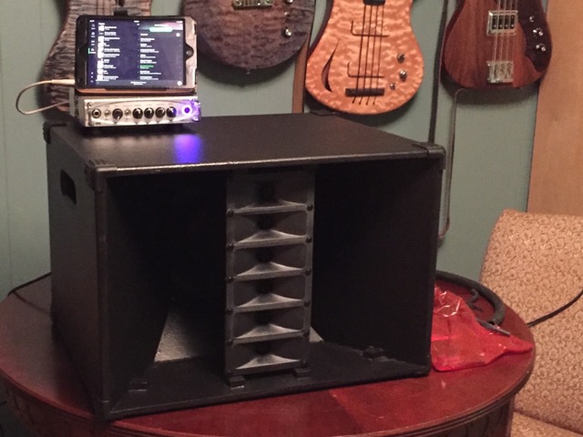

Re: Another OT12 build
Decided to go forward with the two straight-array cabs. Got the first one finished up (except for the grille) this afternoon. Smoke tested it with Spotify running through the Aux In on my little GK MB200.
All of the tweeters work, the woofer works, both Speakons work, and a tone sweep shows no obvious issues at the crossover point. Yay!

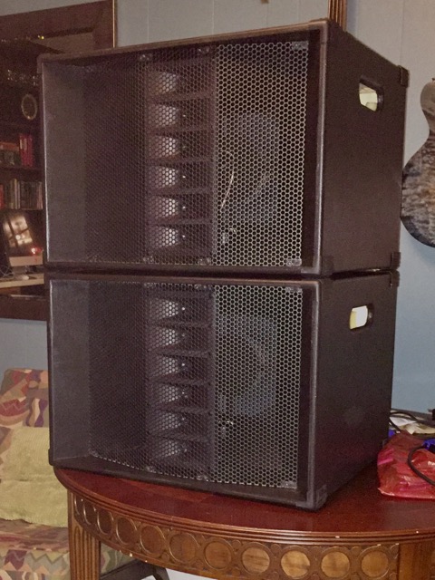

Two straight-array cabs done! I hooked them up along with one T39 and listened to various tracks for a couple hours last night. Played around with EQ some too, just to get a feel for them. Very mid-forward, like the Jacks. Very shy on the low end, no surprise there. The very top end I thought was also a bit shy, not sure if that's due to the lower sensitivity of just six piezos instead of twelve? Nothing a little EQ can't fix. LOUD!
The two melded cabs will be done soon, then I can drag 'em outside and try some RTA.
Check your wiring scheme at both the filters and the tweeters themselves. If they are still a little "shy in the high", change the array wiring to 3 parallel pairs of series, or even parallel them all. But, I would do some testing first, just to make sure all are working. Also, reverse the polarity on the array. If you search around, there's also a recommendation by Bill to move a resistor, I think. Bill?

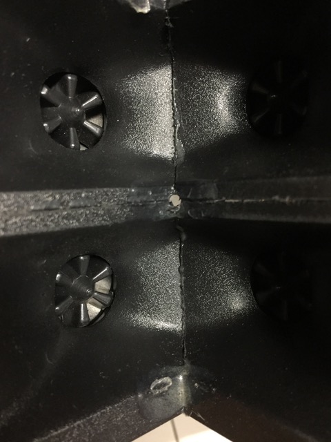

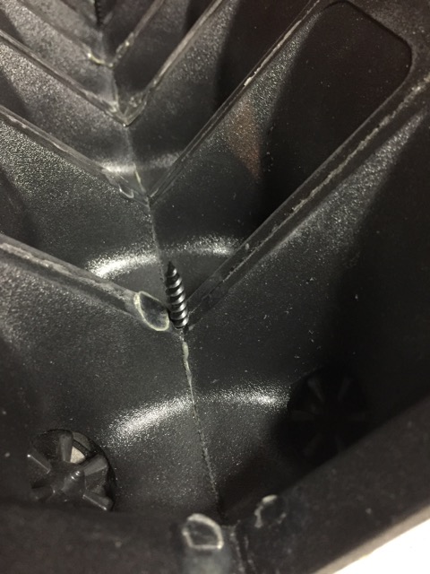

First melded cab assembled and successfully tested. I do think the melded array has a bit more shimmer in the top end, again, makes sense having twice as many tweeters.
I tried gluing the diffuser on but it came off after a few days. So I deviated from the plans.
Very slightly! I drilled a top and bottom hole in the array and screwed the diffuser on. I like having a firm mechanical fastener here.
I thought about something very similar. Just be sure to use something at every array joint to absorb rattling between the diffuser and the array.

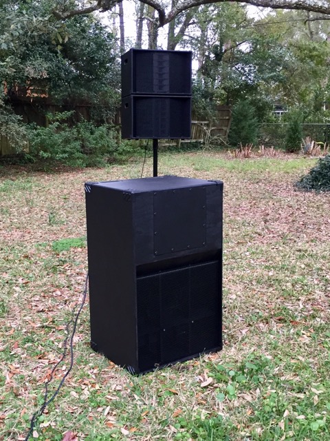

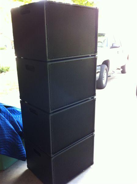

This was gratifying.
Ran it as loud as I dared, given the close proximity of elderly neighbors. Wow!
