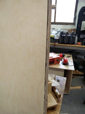

Hmm. Well, you could just live with it, panel 8 is the top, so it would be visibly out of square. PL would probably still fill the gap between the 2nd side and panel 8.
If it was me, I would cut panel 8 off the cab with a circ saw, sand down the mating edges back to normal and start again with a new panel 8. Use a sled to cut the panel off so that you don't deviate into any other panels, and leave 1mm clearance and sand the rest. But that's me and I'm pretty fussy.
Someone with more experience may have a better solution..

Re: Tuba 30 x2 Build
Thanks for the advice guys i appreciate it. See i would do that if i had any more wood availible to me. But the closest source of birch ply is up the country amd costs a fortune to ship down. I was thinking what if i used some sort of thin blade e.g. Hacksaw blade or something similar and hugged the face of panel 7? Then if i filled in the space with PU glue? I dont have the bame of the glue on hand at the moment but will update shortly

This is the tool you need. It can un-PL anything that you happened to PL. It is an oscillating saw that barely touches the wood. It will separate that glue joint without making a mess.
You are the light of my life.CoronaOperator wrote:This is the tool you need. It can un-PL anything that you happened to PL. It is an oscillating saw that barely touches the wood. It will separate that glue joint without making a mess.
You guys are my heros. The oscillating saw was absolutely unbelievable and rescued the panel perfectly. I was absolutely beaming and spent a further 8 hours in the workshop cutting and finishing pieces. I have a few pictures of the outcome of using the saw and i was pretty amazed to say the least.

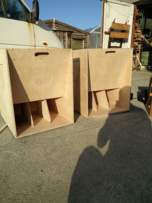

Well guys.. it's been absolutely ages and I don't know why I never finished off the build thread! The final stages of the build took a long time, had a lot of personal stuff going on and my finals for school. The good news is though that the subs are finished and they sound better than I ever could've imagined, or remembered! I'm about to start building my omnitops for a festival on the 8th of july, but i don't think i'll have time to write a build thread. If i do, it'll be short and sweet much unlike this one. Hopefully with a lot less mistakes and questions!
Some finished pics for you all, I was going to do something fancy with the braces but you know what, I think it looks cool enough without altering them!
