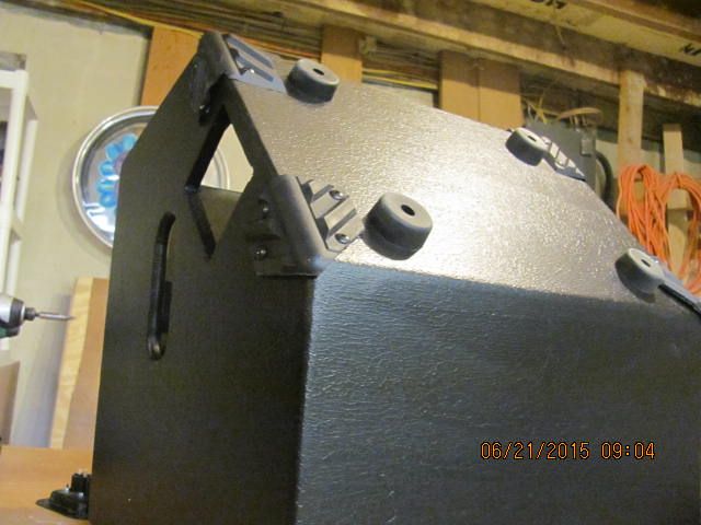

heavybdrums wrote:I am having problems making the penn elcom corners fit the odd angles of the WH 8's and thinking of using the rubber feet instead without corners. Suggestions on how to make these 90 degree corners work on the non-90 degree corners of the monitors?
Grant i see many options for cutting the corners to work here..gets me thinking THANKS!!

Indeedy Grant and that was helpful and Bruce u rock !! The idea i got from the pics of the corners wound u giving me the idea of just cutting the wings off at a 45 deg so a smallish amount of the rounded over corner is left to sand it's pointy little head off for all the "odd" angled corners.
like this:

heavybdrums
Posts: 366
Joined: Fri May 22, 2015 3:46 pm
Re: Wedgehorn 8's w/ horn finishing option
#41 Post by heavybdrums »
Hoping the painter in me shows in this very critical sideways light

heavybdrums
Posts: 366
#42 Post by heavybdrums »
However i ran out of the screws used to mount these and only got 11 corners and waiting from speakerhardware about why the handle didn't come in the kit. Mebe they don't come in the kit anymore...
