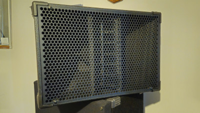

9 years and many gigs later, I finally got around to finishing these off with a set of grills! 9mm hex holes, 62% open 1.3mm galvanised steel. Painted matte black. Did up some mounting blocks to attach them. Reckon they look mint!
