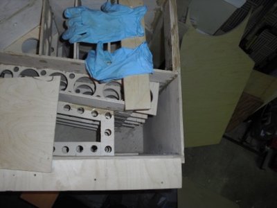

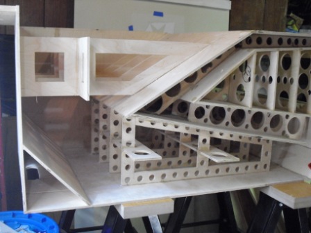

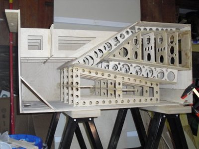

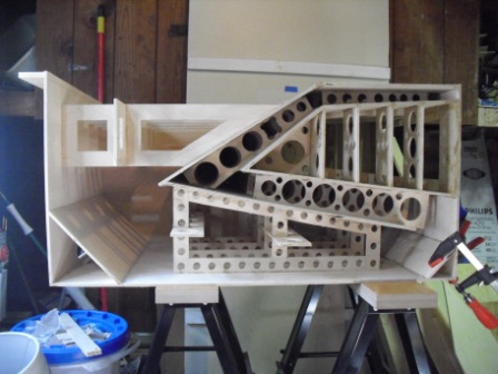

ncgrove
Posts: 457
Re: T39L attempt
#35 Post by ncgrove »
Here's a little more of what I've been up to:

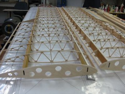

Thought of this when I saw your braces.....
Glider wing framing!

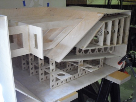

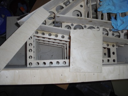

Finally got the last piece installed. Now the real work begins...

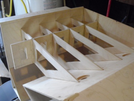

#38 Post by Bill Fitzmaurice »
David Raehn wrote:Thought of this when I saw your braces.....
That's the inspiration for most of my designs, as opposed to this, which is how most commercial cabs are made:
Posts: 8615
Re: T39L attempt
#39 Post by Bruce Weldy »
Holy Swiss Cheese, Batman!!!!

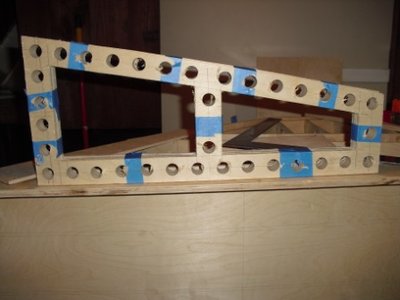

ncgrove
Posts: 457
Re: T39L attempt
#40 Post by ncgrove »
Yeah definitely couldn't have done all that without a drill press.
Now I have to get motivated to get out the can of bondo and the sander.

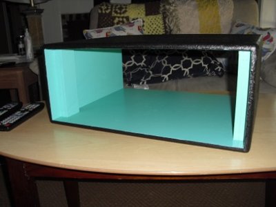

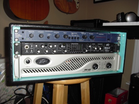

Thanks guys. I had to put the cabinet on hold this week to slap this guy together:
I think it turned out pretty nice. It was the wife's idea to use the green on the inside. I'm really liking it.
Re: T39L attempt
#45 Post by Chris_Allen »
I do like the green colour, nice rack box.
(The original statement read: "Your wife has good taste, nice rack" but decided it didn't read well! 8O )
