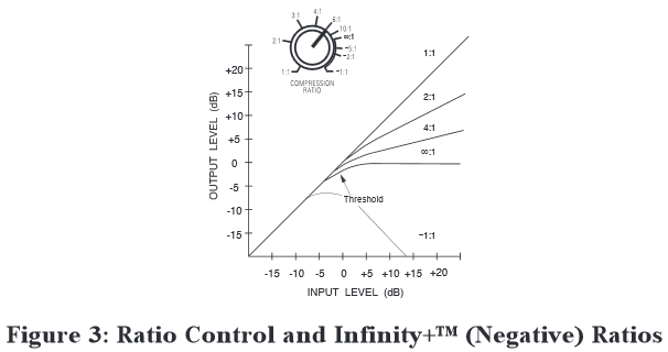

SoundInMotionDJ wrote:I get that a "hard limiter" can be setup to provide a maximum output for any input above a certain level. I have that now. But, it's not working. DJs who get on my system continue to push the DJ mixer into the red and produce an overcompressed mess...and I get the blame.
I am looking for an effect to help me keep overzealous DJs in check. I want a limiter that will allow the "maximum" volume to be passed when the mixer is at some 0dB level of output.
BUT...if the DJ mixer level is raised above the 0dB level, I want the final output to go down from that 0dB point. So, if the DJ mixer is at +6dB, I want the output of the limiter to be -6dB (or whatever ratio I set).
Is there such a device?
Yes.
I recommend a dbx 262 compressor for the task. These are available used for as little as $30. I currently see two online from the used equipment store Music-Go-Round. I recently paid $60 for my own third unit in excellent condition.
Like the older model 166 often seen in clubs in the 90's, it offers "negative" compression ratios, which effectively begin reducing output beyond threshold at up to a -1:1 ratio where it does precisely what you are asking (+6db comes out -6db). Locked in the amp rack and adjusted properly there's far less worry of actions by inexperienced sound board operators.
IMO, the dbx 262 is possibly one of the most overlooked compressor bargains ever. This might be due to the fact that it carries the "Project" label of which other devices in the so named series were for the most part inferior products.
While not feature laden it is a very good dual channel analog compressor. It does not support sidechain connection or provide ADSR style adjustments. I've found the latter to be window dressing anyway on most low end models. The gates in cheap processors rarely work well either.
What it does offer I hold in high regard:
Solid controls and construction
Excellent gain reduction metering
Selectable hard/soft knee operation
Unique Negative ratios
Stereo link
IEC detachable power cord
TRS Balanced 1/4" Input/Output connections
Good sound quality and high reliability
With respect to the negative ratio feature, this comes from the dbx manual:
"Negative ratios can also be used to prevent musicians from continually increasing the volume of their instrument (e.g., in live applications where there is no sound engineer to control the house levels). With their signal compressed by a negative COMPRESSION RATIO, each volume increase initiated at the instrument or amp would actually decrease the volume level at the final mix."
I've found that recording a snare drum with a negative ratio produces an very interesting effect, suppressing the "crack" but allowing the grace notes to breathe with the strainer buzz. Try it sometime.
If you can pick these up cheap they're a bargain. Where else can you get a line amplifier with balanced I/O for 30 bucks?
