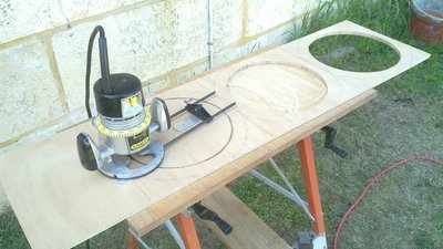

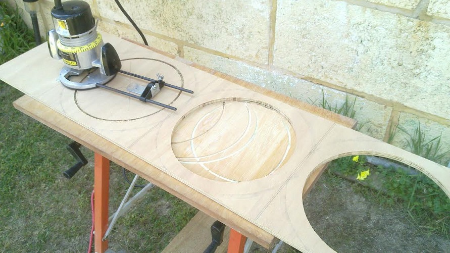

Sorry to interrupt the discussion (it's great, keep it it going!) but my brother did some fine work with the router today in preparation for our next construction marathon next week.. couple of quick pics..

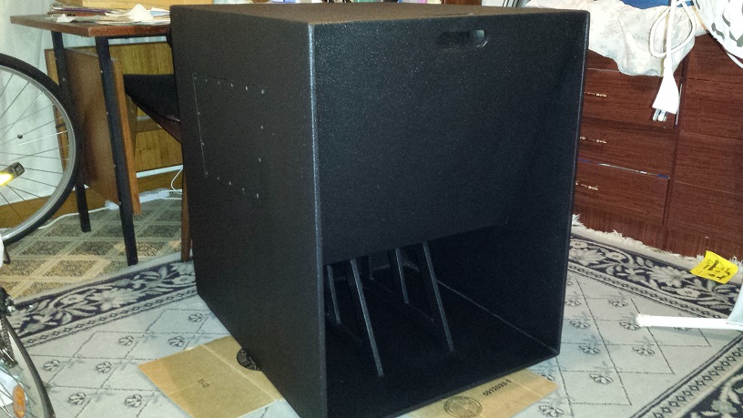

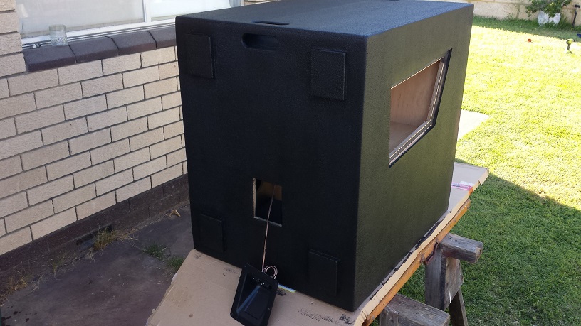

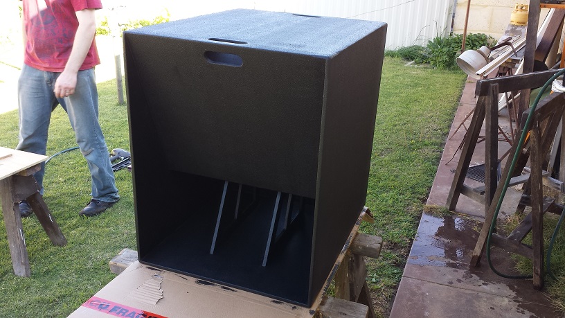

Pretty successful day today! Cab 1 got a double coat of duratex throughout the day, we decided to do the entire cab including horn mouth and it worked out very nicely! Used less than half a gallon of duratex which was less than anticipated. We installed castor wheel blocks on the back of the cab for the screws to have some extra meat. All that remains to do for cab 1 now is install the corners and the castors which will be done tomorrow.

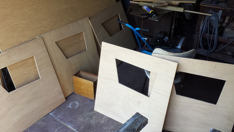

We got the access panels cut out of the sides for the remaining 5 cabs, and then proceeded to cut and install panel 1 on cab 2, then cut panel 1 for cabs 3, 4, 5, and 6 while still setup for it. This is how we intend to continue with the build, so that after cab 2 is done, it should be a lot faster for the last 4 cabs. We got panel 2 installed, and the remaining panel 2's cut. Then we cut the panel 3's to finished length and called it a day. We also broke in the first pair of my brothers 3012LF's over the day. Back at it first thing in the morning!
cab 1 finished, awaiting corner/castor install
Cab 1 drying
Cab 1 drying
Cab 1 finishing
Cab 1 finishing
Cab 1 finishing
Cab 1 finishing
Access panels cut
Access panels cut
