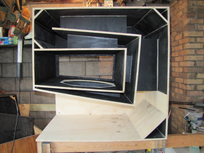

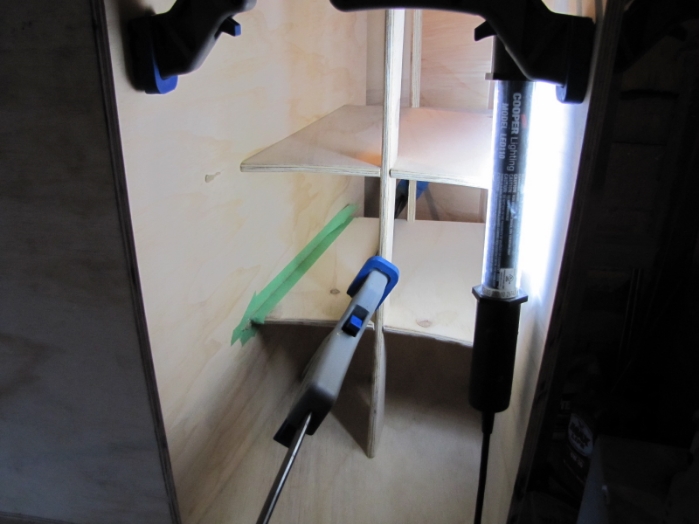

I started to glue the mouth ribs and brace in. I should have taken a picture or two sooner. I was wrestling with how to keep the PL at bay so I can stain this baby and make it look halfway decent. I marked lightly, then masked off around where it would glue. After the glue expanded a bit, I just peeled the tape out. It came surprisingly clear, other than one booger you can see where I smeared on the way in. Horizontal brace was pre-glued, I just have a clamp in to hold the jig / spacer on the back side until the PL cures.

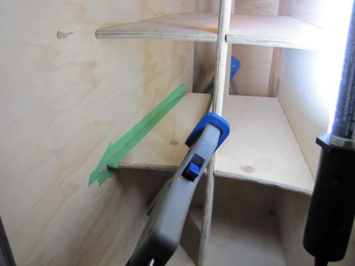

A little closer in so you can see the bottom one left to peel. The top one came pretty clean. The trick seems to be to pull the tape on the face the glue touches first. Then the tape on the sides of each piece just keeps that off as you clear it. Then those around the ribs peel last with relative ease. I'm not happy with the rounded edges. I thought it would look nice, but there was no easy way to transition the ribs to the horizontal brace. I wanted to leave a square bit and hand sand, but I got carried away with my router. Maybe THT#2

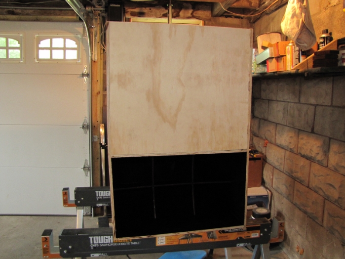

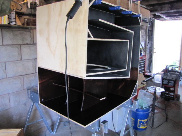

Down to the last panel. I temporarily clamped Side two on, carefully traced everything I could reach in the mouth and around the outside. Then I reached through the access panel and traced inside. So I was able to lay out every panel except 7, 8 and the corner braces (3/10/12) up top. I got a smidgen of 7, but could barely reach around the corner. I double checked it with a T-bevel and threw a straight edge on that to get direction, and transferred the length. Then I offset everything ~1/2" allowing for a little slop and transferred the angle from 7 to 8 with a t-bevel. Then we measured and transferred that angle from 7 to 8 and 8's length. That layout I made over 1/2" wide to account for error. The panels turned out pretty straight but I wanted enough bare wood for the PL. All the corner braces were just measured and transferred, being a little generous. Lastly we masked her off with 5/8" masking tape. I trimmed some where I knew I was very close to 15/32, others I left proud to give the PL some room. A little MinWax Bombay Red Mahogany #225 and 3 coats of water based MinWax poly lightly sanded. I didn't want to put too much time in as it sounds like we'll never see it! Anyway it was good practice to see how my red would come out.

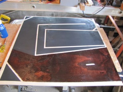

I slapped some stain on the other half, in the mouth as well. What a messy job reaching around all that stuff, I'll have stained arms for weeks. It turned out really dark, I think we'll paint her all flat black next time! As I was laying out the lines for side 2 to mask and paint, I noticed a bit of warp in panel 9, the top. I don't remember it being there before, so I don't know if the humidity, and my clamping caved it in a bit. You can barely see in the top of the picture but I tried to repair the warp. I've wet it down a bit, and clamped a cedar 4x4 across it to pull it up a little. I put a block on each end and clamped as close to the ends as I could. Then I spaced a couple clamps in the middle and pulled it up a bit. I tried to force it a bit high, as I can clamp it back in at final glue, or it will relax anyway.

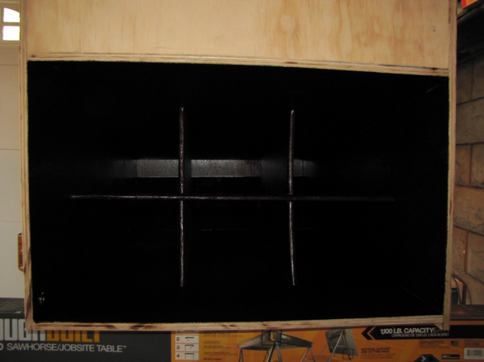

A view into the mouth, very dark, shoulda gone black or used stain pre-treat for this soft pine.
I also need to use my flush cut bit on side 2, still have some overhang as you can see.

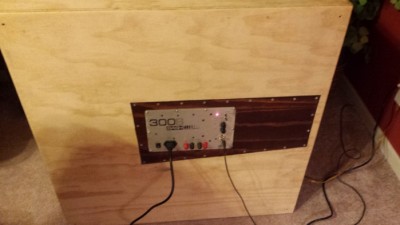

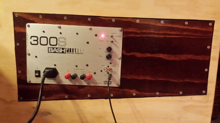

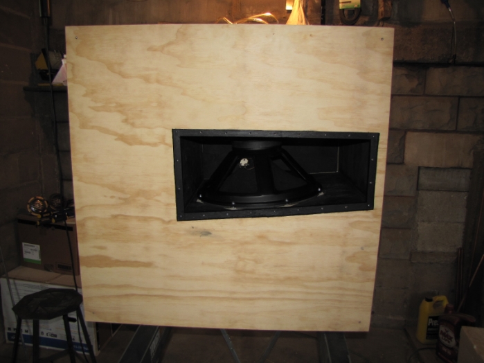

Have my access cover stained and 3 coats of water based poly, it didn't turn out too bad. My refurb BASH300S has white latex caulk where some tool sealed it and got sloppy. I had to clean the factory gasket off, it was trashed. I poly'd the cover right away and sealed the amp with some black RTV, I don't plan on taking it out anytime soon. Going to test for leaks, listen a bit, then convince myself to take it back to the garage for stain. Then I can clean the rest of that white latex off the amp hopefully.
Cell takes awful pictures, I have to steal my wife's Canon again.
