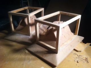

Not really a BFM specific post but spent the last few evenings making some boxes to seal in the drivers on the synergies. Going to rebate the frames so they can take some 5mm perspex so we can show of the unique design of the cab. Might even experiment with some LED strip lighting down the track to finish it off. Just doing some other prep work too so we are all good to get painting on Saturday, then hopefully drag it all down to the nearby playing fields for some serious testing (might even get it to war volume!)
Getting pretty damn exciting to have it close to performance ready.

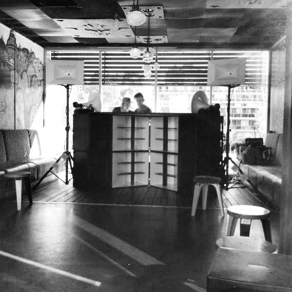

So the saga of our build has come to an end. Last week we put in some big evenings and made great progress. We managed to finish off the painting for the final 2 titans on Saturday morning just in time to drag it all out to the Australian National University Art school Ball. Our System was the main stage and crushed for hours with no sweat. Was sounding sweet and we got lots of compliments from various DJs and people in the promoting scene in Canberra.We were running comfortably below war volume for the whole evening and it was hitting the spot volume wise for the venue. There were about 300/400 people at the main stage at the height of the evening and we had a really nice even sound field right across the audience. We also put together some pretty spec monitors using a pair of Azurahorn fibreglass wave guides with compression drivers and a set of Acoustic Research floorstanders- after all the artists themselves deserve nice sound in the booth too right?
The Djs were pretty well behaved and didn't up the gains on the mixer too much throughout the night but a few tracks that were not recorded at 320k sounded balls on the system. We had no issues at all on the night with our gear and the only stuff up was on the part of the crew that provided the decks with no power or rca cords. So we had a bunch of helpers running around the campus stealing kettle power cords so we could get the decks up and running.
The following day Horizonize took the system out to a small local bar that has been putting on lots of bass/beats music in the last while for an afternoon/evening gig with Sam Binga from the UK headlining. I was unable to attend but apparently it got pretty wild- definitely a level above the regular systems the guys get out there.
In the end we got a local audio consulting guru (who we found through his blog on his own home made synergy horn experiments) to come out and help us dial in the system a few weekends before our debut outing. We were able to do away with the W bins which were giving a bizarre trough in their Frequency response, and cross directly between the titans and our Synergy horns. We managed to get +-2db from 40hz-20k hz! We were also hitting 100db 1v/m. So all in all-very happy with our system. It also means we have an extra pair of 18sound 15" drivers that can go in another set of titans down the track should we feel the need :)
Our experience with the Titans has been really great. They were easy to build, and definitely bring the goods in the output department. Because they are an efficient design we can run our whole rig off my tiny inverter Generator which means we are free-er to throw outdoor parties without too much hassle. Thanks to all the people on the forums here who helped us with tips/ideas. It definitely made the experience an enjoyable and positive one.
Here is a pic of the system ready to shred indoors-
