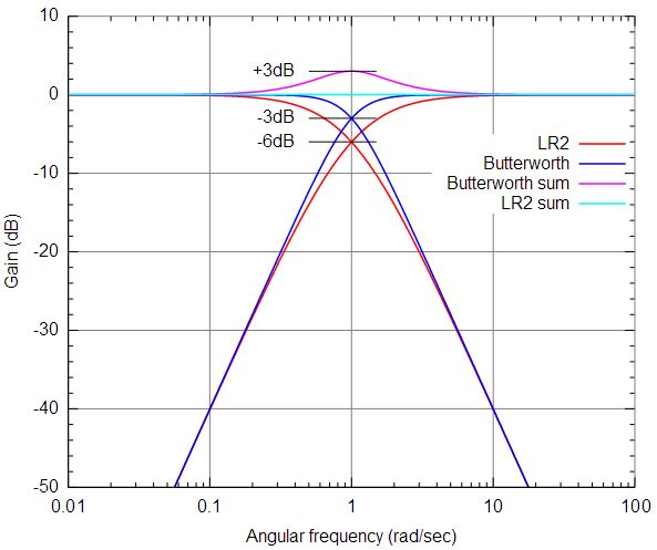

Grant Bunter wrote: Have I got this wrong? You set a HP with a slope, let's say at 40Hz. I thought the slope commenced at 40Hz. Even if it doesn't and the slope actually begins at (eg) 41 or 42Hz, you may see a reduction of (guestimate) 1dB at 40Hz and how does this mean I should have built smaller subs?
If you set a LR highpass at 40hz, the slope wont start at 40 hz but will start higher depending on steepness of the slope. A LR filter is down 6db at the crossover point, so with a 24db/oct 40hz highpass the slope will start at around 45-50hz and be down 6db at 40hz.. Butterworth is down 3db at crossover, thats why you get a 3db bump at crossover point between 2 units when they sum.. LR sums without that bump.
This explains it:

This is why i always use bw 24 on hipasses, only 3 db down at hipass point and you are not xovering to anything so there is no sumation to avoid.
This explains it:
Excellent, thanks Michael.
I had seen that chart before, but hadn't locked into the memory bank.
Perusing it suggests to me, perhaps it could be better said "With the T39 in a group of 4 or more, HP at 40Hz with a butterworth 24 slope, and extension, you will get useable response to 40Hz".
