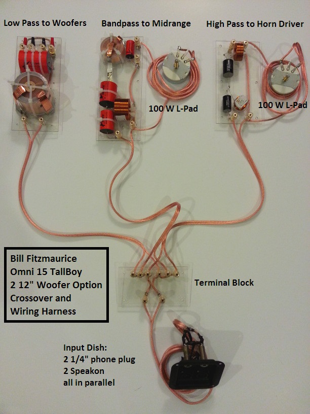

Thanks DJPhatman, you guys are a tremendous help.  I did confirm that those Switchcraft Speakon-like connectors leak a little bit through the slots that the connecting lugs come through, and the 1/4" deep-cabinet jacks similarly leak through the small slots that the connecting lugs come through.  These are not the usual 1/4" jacks that would allow significant air to pass, but are almost 2"-long threaded steel tubes with an interior  phenolic disk on the inside-the-cabinet side, but they will be sealed nonetheless.  Where they meet the dish, on the inside, there is already a 3/8" stainless steel washer bored out to accomodate the jack tube.  On the outside of the dish they have a fairly wide collar.  Those jacks are almost 40 years old, and have been cleaned up with DeOxIt.
My plan was to squish elastomeric sealant into those slots using a caulking gun and fingers, taking care not to goo up the electrically-connecting surfaces, and likewise seal the mounting holes in the dish.  Finally the same sealant would be applied to the lip on the dish as it is attached to the cab with 4 #10 sealant-coated panhead machine screws (I would be doing the sealant-coating).
