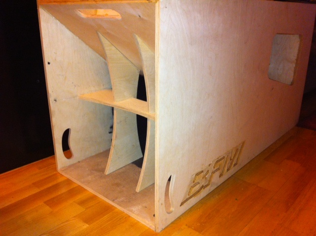

Even with CNC, I decided to leave the access flanges out, I have added them the old fashion way. Although, in hind-site, having the access panel flanges pre-cut into one solid piece for each access panel would help in aligning the first 4 critical panels around the access hole. Great Idea Mr. Jenkins...

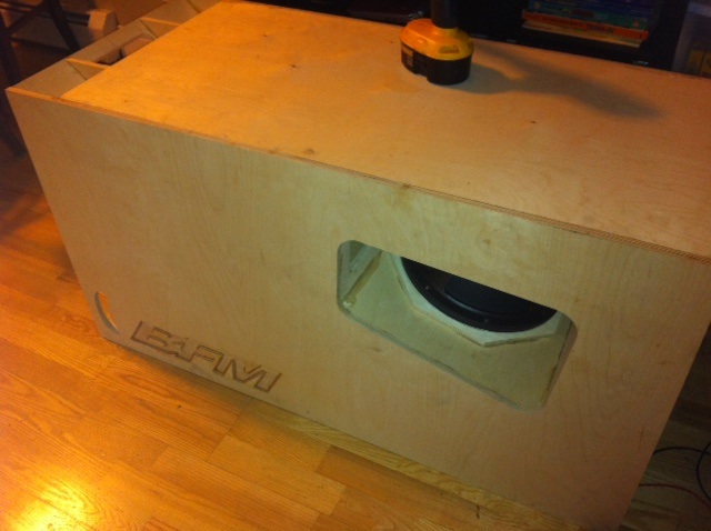

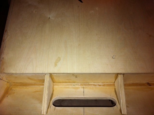

Some more pics, kind of skipped over the build steps and focused more on the overall finish. These are pre access panel and sanding from last week. I decided to reinforce the handle hold at the front...

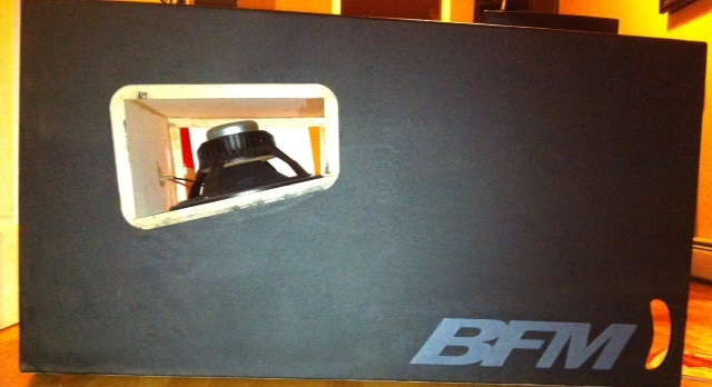

Curious how you will glue flanges in there. It appears that the opening is flush with the surrounding panels; there is no "empty space" to glue flanges to. :? That said, it's looking fantastic. I really like the curved handles at the front of the side panels. Those are CNC'd, I'm assuming? Can't wait to see what it looks like painted!

miked wrote:Curious how you will glue flanges in there. It appears that the opening is flush with the surrounding panels; there is no "empty space" to glue flanges to. :? That said, it's looking fantastic. I really like the curved handles at the front of the side panels. Those are CNC'd, I'm assuming? Can't wait to see what it looks like painted!
Not sure if you've built any of the Tubas but the inside panels line up exactly with the access opening. Access flanges are made to "Rim the access openings with ¾ inch wide plywood strips, creating mounting flanges for the access covers". The only difference in my access openning is that I rounded the corners which shouldn't cause a problem.

#37 Post by miked »
Sorry I missed your reply...been busy with my build. Thanks for explaining it to me. I get it now.

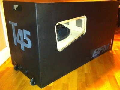

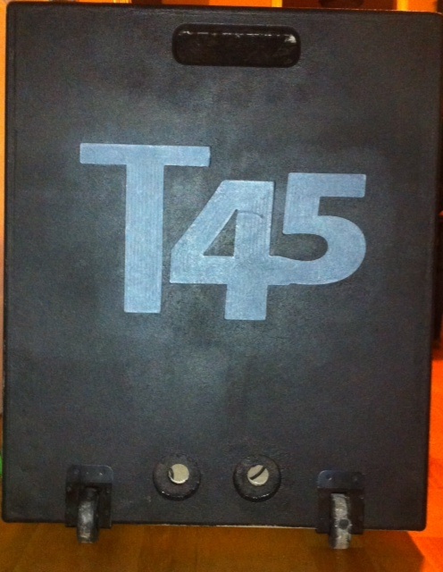

Thanks guys...didn't show the mouth area, havn't decided on a final color scheme but it will include deep purple.
Also On the task list to finish, Terminals and access panel bolts.
