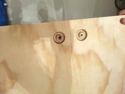

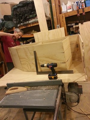

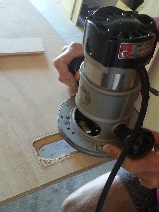

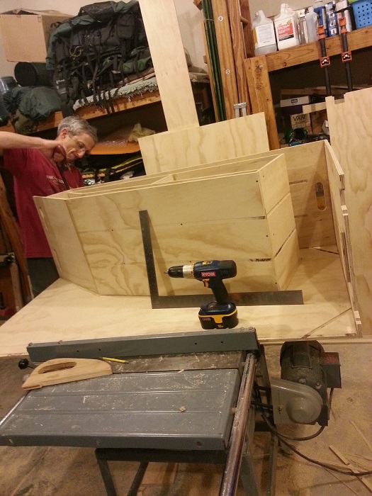

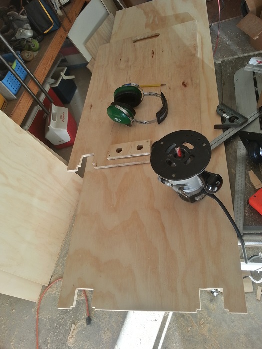

No slipping since using MEK. Problem that we still have is the bit is really difficult to change out. Much safer problem than too loose, so I'm ok with that. More build progress. I manually (fly cutter+ drill press) recessed the rear jacks. Also, panel 8/9 are in and 10 will go in tonight. Didn't take too long to jig saw out the cutouts for the casters. Looking good so far. Ignore the random messup on panel 10, it is airtight and will get bondo/sanding treatment later on.

Nice work repairing / maintaining your router.

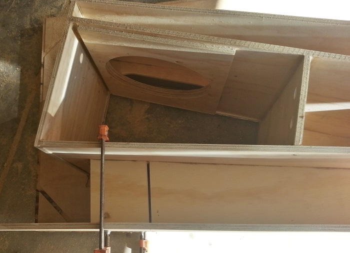

The birds eye view picture of the driver chamber and horn path shows that you are building to a pretty high standard

I pray that it comes out like the chart. I await the day when I get to turn it on. It is VERY solidly built so far (hoping to make some gorgeous 1 piece braces... we'll see), Bill as always the bracing does wonders, super reinforcement. The dado's definitely make glue and screw time more enjoyable although as many forum members will mention is totally overkill
. I've been scraping off the external pl at half cure as to avoid unnecessary sanding later on. With all the panels pulled together with screws I have almost no warp (after careful drilling, forcing it straight) and extremely strong joinery. I'm not chancing leak potential, I already have a ~$330 paper weight, this one has to come out as airtight as humanly possible and I have been using extra PL for this time around (the screws have helped the process a lot as well).
