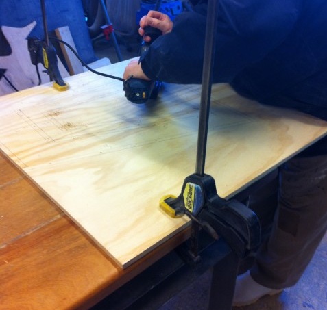

Part 1
Acces hole being cut.

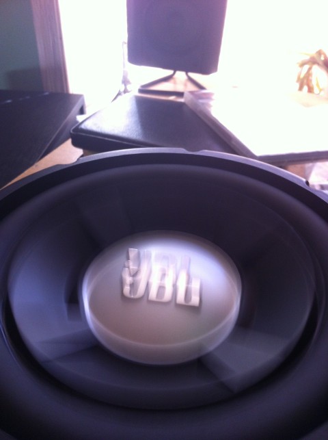

Breaking in the driver.

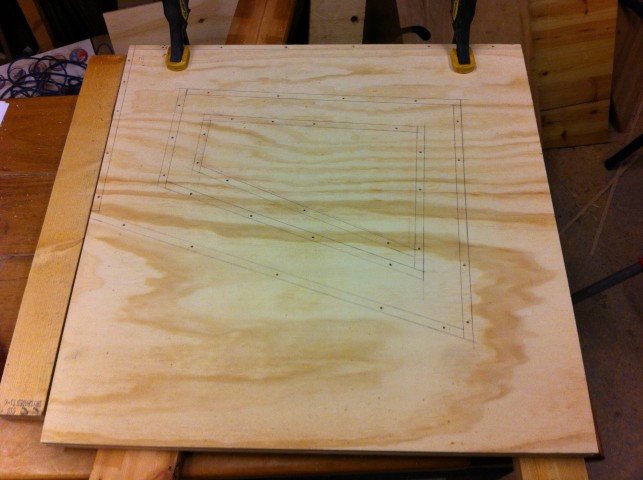

Layout done.
Layout done.

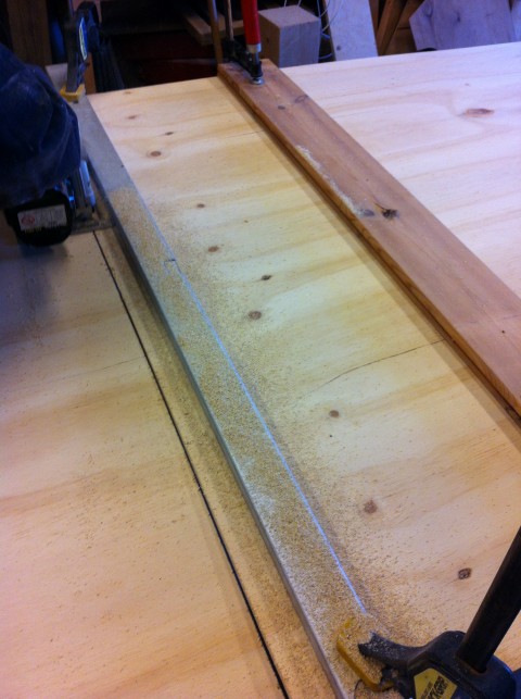

We used a saw sled to cut the pieces, this is a rather simple process.<br />I think everyone would be able to use this technique.
Bought some wood :D
Bought some wood :D

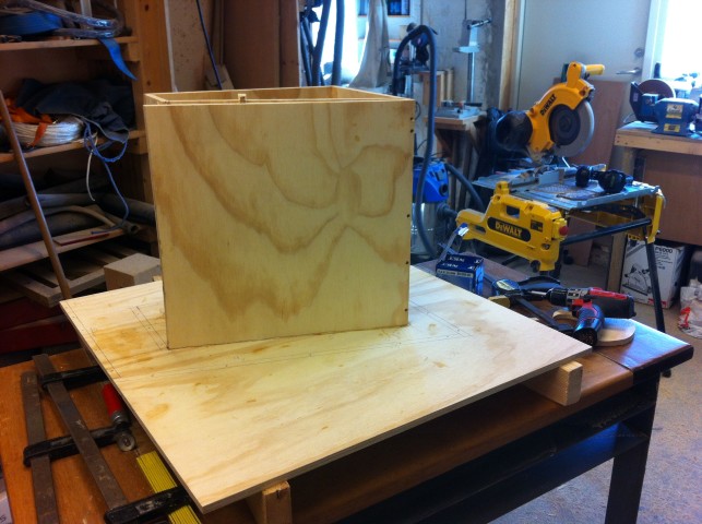

Part 2.
This thing is wide!!

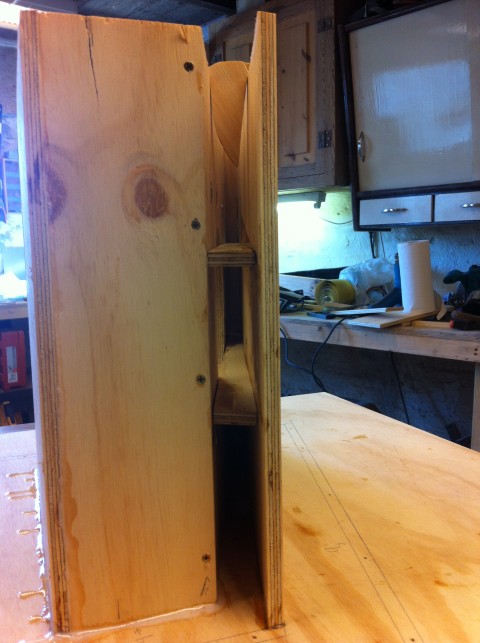

Placement of the braces.

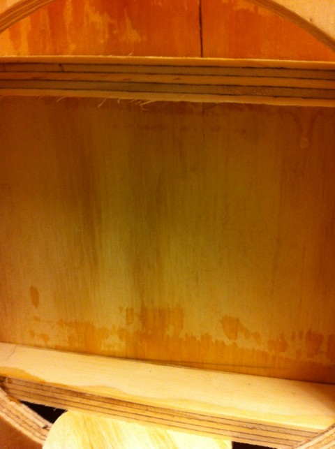

Not the best fit of bracers, but fortunately my glue expands :D
