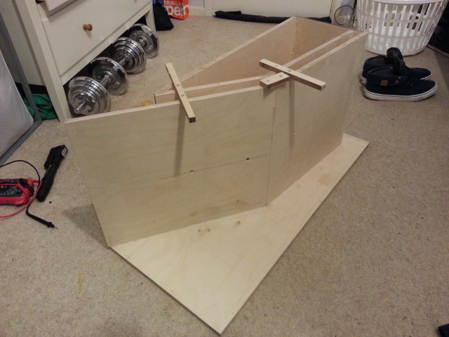

Hello again,
Good news, haven't been banned from the forum
So the second set of T-nut's I ordered finally arrived last week and I have been cracking on with the build. The first lot I ordered on the 25th arrived today
Wouldn't really call that first class.
So I haven't really come across any major problems so far, the biggest muck up was cutting brace 4/6 too small but that's no biggy.
Overall its coming together quite nicely and I'm pretty pleased with the build so far.
Unfortunately I haven't taken that many pics but here are a few...

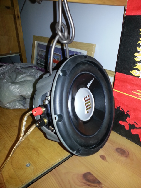

Hanging the speaker is great, keeps the noise and vibrations to a minimum during burn in.

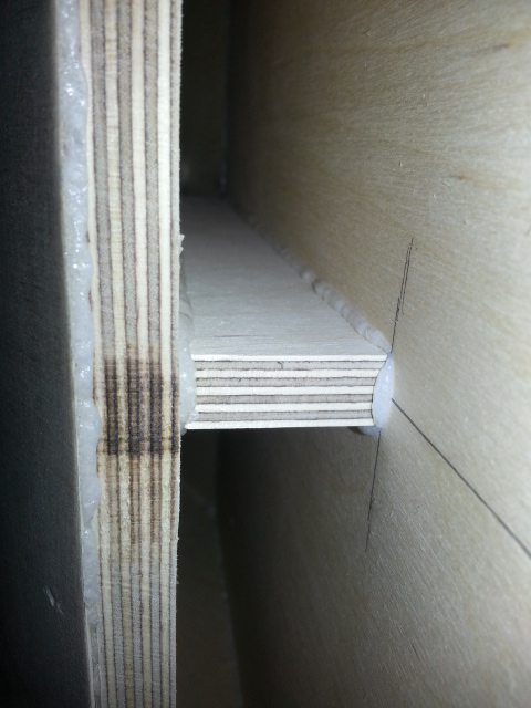

This is the typical amount of squeeze out I'm getting, I assume this is OK/a sign of a good seal?

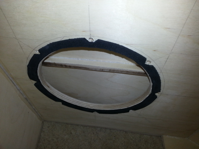

Also I was reading that some members were having trouble getting a good seal from the JBL to the baffle due to the hard rubber surround on the woofer.
I decided to make a gasket as shown below.
I was wondering what you guys thought of this?
I recon it could work but equally it may just 'squash' out the way when I crank up the bolts.

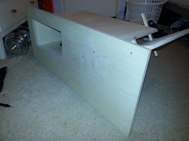

I have also attached panels 7 and 8 but I don't have any photos yet.
Hoping to fit 9 tomorrow and then should start work on the flange access cover as I'm planning to do this before attaching the second side.

Nice. The gasket looks good. Squeezeout is your friend. He is telling you "no leaks here".
Re: First Build - A Single JBL 804 16" AutoTuba
The JBL gasket is fine by itself in my builds...its rubber gasket can compress about 1/4" - 1/2" when tightening the bolts.

Holy crap - it IS. good eyeTom Smit wrote:BOWLINE!
SWMBO just said "it's not a bowline, it's a rabbit out of the burrow, around the tree and down the burrow again."
Man I had trouble teaching that knot when I was a scoutmaster years ago.

The bowline was my nemesis, my favorite was the two half hitches. Ever tried a sheep-shank knot? Release pressure and it all falls apart.
honestly, the one handed method for tying the knot around yourself is the easiest.LelandCrooks wrote:Man I had trouble teaching that knot when I was a scoutmaster years ago.
http://www.youtube.com/watch?v=H85cMlvwwXA[/youtube]
