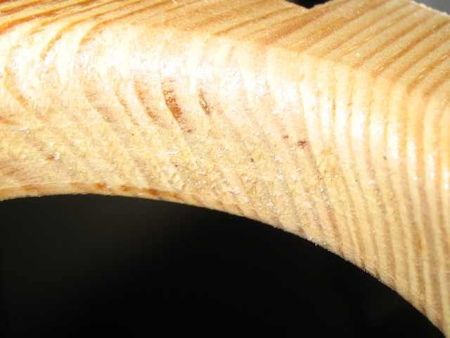

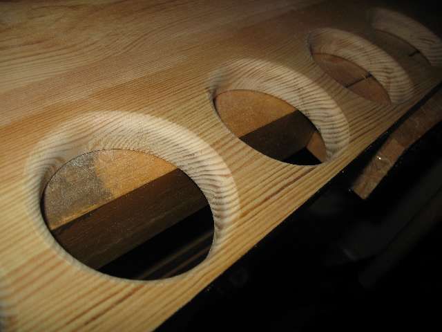

On a more serious note, a small bit was done again. I'm suffering a long lasting and nasty cold, progress on anything I do is slow currently. Manual jig saw to poke through the last bit of wood, the router bit wouldn't go deep enough. The pattern following bit in the router to clean up the rough cut. Then the first bit of lots of sanding. This build will cost plenty sandpaper.
Pics after the first coat of lacquer. That first bit of lacquer makes the wood fibers stand out and break rather than go with the flow when sanding. Smooths up significantly, but still a long way from how smooth I would like it to be. I do not understand how luthiers get their work so silken smooth. They must use their own weight in sandpaper every year.

Your on the right track. I Seal-N-Sand at least 3 times then follow up with progressively smaller grits of paper until I get what I want. I have found that if I only seal one time its very easy to sand right though that area and you end up with the little fibers or hairs again. If you seal and sand 3 times you will not get that but its more work and better results in the end.

Thanks guys. Got three coats of clear & sand now, starting to look better and not sanding 80 grit anymore. I think at least two more coats, maybe three.

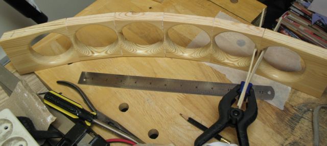

A little progress. The baffle got 3 passes of clear coat and sand. Then I cut it into pieces. There's no fast curing PU glue available here. So I glue and clamp every piece and come back next day. Just did the last baffle piece. Some creative clamping needed, clamps straight on the baffle pieces just slide off because of the rounding.
For size comparison I put down a 30cm steel ruler in front of the baffle (12", for all you imperial cavemen out there :wink: ). The 3" Hivi drivers are tiny, so this is going to be a miniature curved center SLA.
