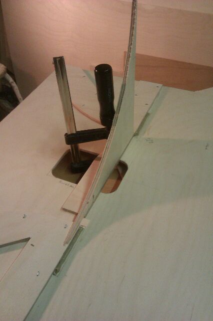

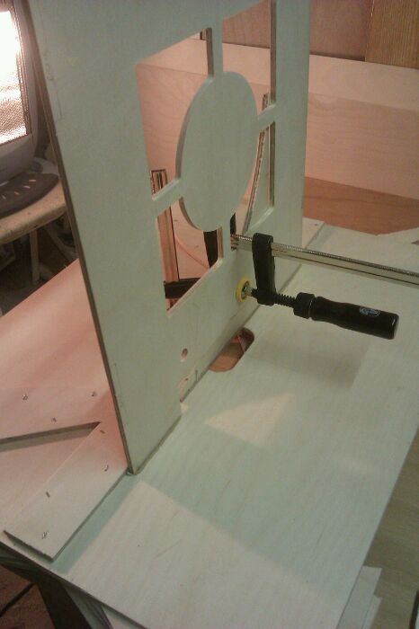

It's 1:20am, but I figure 'what the heck', I'm on holiday, the kids and my wife are in bed, and I may have to get up yet to jiggle new born, ...so i thought I'd cover tonight's progress. Below is a scrap right angle assembly i made when setting up my new nail/staple gun. I clamped it through the enlarged tophat hole (ref: tilting top hat) so I could put the baffle onto the glue in the 'easy side up' position.

Here's the baffle with a second clamp holding it onto the right angled piece, in the bob on position. Now it can be turned over and stapled easily.

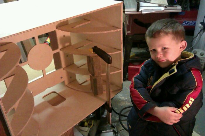

Using 100mm spacer blocks to position the braces before stapling. And my helper.

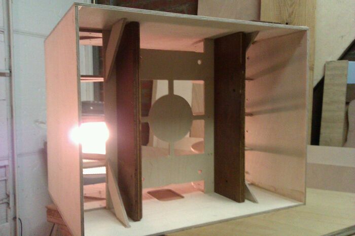

All stapled up. My wife thinks it would make a nice lamp shade.

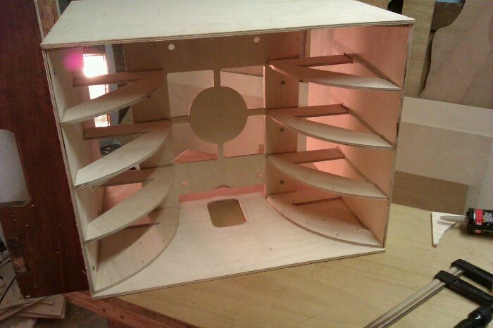

Corner braces installed in the back, fixing baffle to bottom and top panels.
