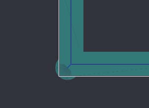

One last explanation of making a square inside corner with a round bit. The software does this but you can also do it manually. You guys are making it too complicated :)
on a normal inside corner, the bit goes into the corner, the goes at 90 degrees to the right to continue cutting. This leaves a rounded inside fillet at the radius of the bit. A square piece of wood can't go all the way onto the corner.
To correct this, when the bit hits the 'corner', and before it goes at 90 degrees to continue the cutting, it goes in to the corner at 45 degrees, just enough to get rid of the fillet, so a square piece can fit in properly. To do this, it has to go past the corner point, til the edge of the bit hits the point where it would be square, allowing the other piece to fit. It actually doesn't make the corner square, it makes it so square pieces can fit into the corner. 8)
The new pic shows the actual cut in light blue, so you can see the 'overcut'... The dark blue line is the path of the bit.
Hope this explains it better.

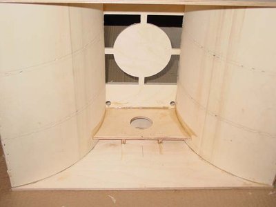

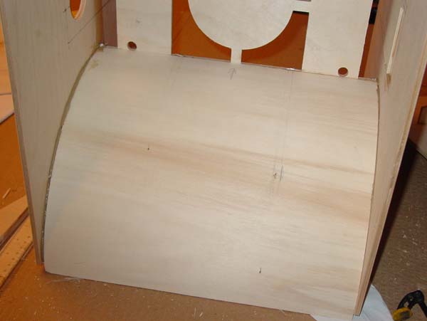

Family left for home after the holiday weekend, now I am back to it... Got one sheath glued and stapled in place. Thought I had practiced enough before hand with the air stapler, but I was wrong.. Have a few staple sized holes to fill once glue dries..
But... I love the way it looks... these are going to be very cool.
Don
One sheath in place...

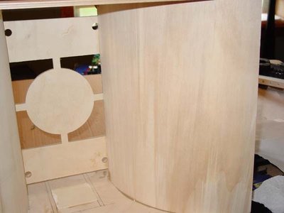

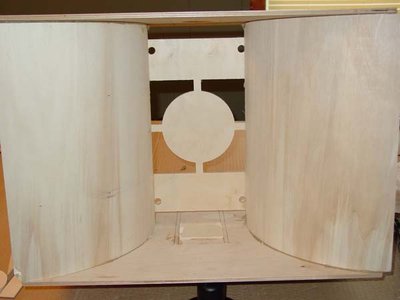

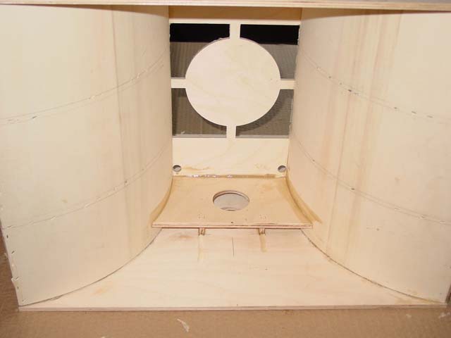

A few pictures.. Have a lot of filling and sanding to do. Stapling the sheaths is the only hard part of the build. Missed the braces quite a few times, as you can see, so a lot of filling. The lines I thought were right weren't quite spot on..
May have found a fix for that problem for the second cab. I found if you put a light inside the cab behind the sheaths, you can see the the brace location very well. Now I just need to learn to aim the stapler correctly :oops:

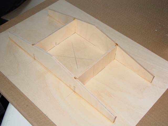

The discs around the top hat are to resize the holes for the metal top hats Leland sells. Cut the 2" holes the plans call for for the thicker plastic top hats, before I bought the metal ones, which only need 1.5" holes. 1/4" gap is a bit much to make airtight.
Don
All sheaths in place.  Sorry about the lighting..
Back Panel
Back Panel
Duct in place
Duct in place

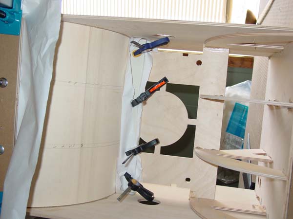

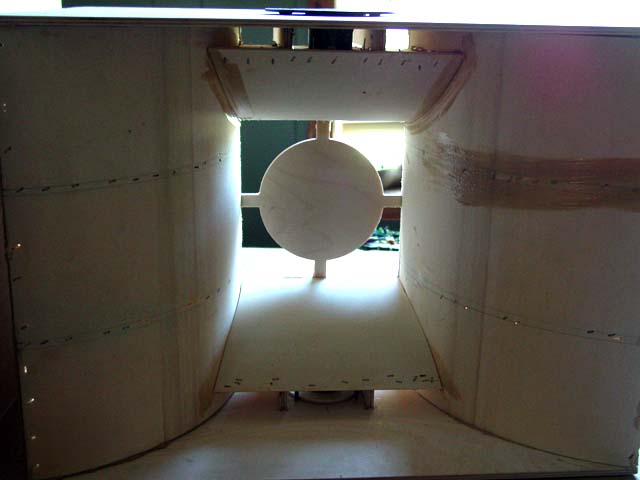

Putting the sheaths on J10 lite #2. Big breakthrough on this one.. After puting on 3 staples on the first sheath, and 1 missing the brace, I decided to try it with no staples, just clamped at the baffle and cab side. :fingers:
After finding it wasn't a 1 person job, had my wife come in and do the clamping while I held the sheath tight in place.
The results were fantastic :hyper: Did completely with no staples on second side. The square piece is sealing the patch for the hole cut in the wrong spot, see earlier post...
Everything was tight against the braces, PL oozing everywhere, and no air leaks to fix, except for the one missed staple on the first side, and no staple holes to fill and sand. Just as solid as the one with the staples, if not more solid.
After these results, I need to come up with a jig to clamp the duct sheaths in place, so no staple there either. A bit harder since no where to easily clamp the front side. Off the CAD....
One question for you all... What Bondo are you using? Is there a Bondo that says it is polyester? I have looked 3 places, and can only find the original Bondo, the 2 part stuff, and it says nothing about polyester :? :feedback:
Does anyone have a picture of the proper Bondo can?
Don
First sheath, 3 staples before I decided to try no staples.
No staples!
No staples!
Both sheaths in place.
