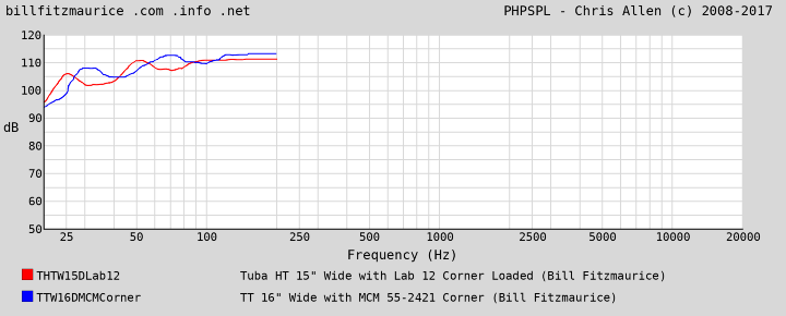

I'm going back and forth between two ideas. Can someone give me some input here on the better option?
A.) Build another T18, dual loaded to match my single loaded T18. Both placed in opposite corners of the wall.
OR
B.) Build a dual loaded TT long style and install it between the floor joists (16" spacing) in my basement, then install a large floor vent for it to fire through (in the corner of the living room). I might be able to fit it in behind my seating area instead of the basement idea, haven't decided yet. Either way, I'd need to unplug the T18.
I love my T18 and I should just be satisfied with what I have, but the extra low end extension of the TT would be nice. However, is it a larger benefit to have two T18's, or a single TT? I thought about doing the same between-the-floor joists idea with a THT LS, but the response graph make me think it wouldn't be worth it to build a minimum width THT.
I've got two T39's and four OTop12's to build for my church before I do anything, so it might be good for me to have some time to think about it before I do anything crazy.
