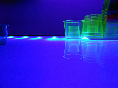

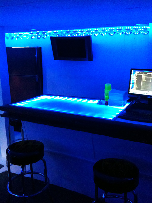

I got the lighted bar top idea from a local club called Fire and Ice. Their whole bar is made from plexiglass and lights up, so I made my own version of it for only $45. I just used two strings of tiny blue l.e.d. christmas lights that ran off of 5 volt batter pack that I got from walmart left over from christmas. They were on closeout for $2 each. A trip to lowes and grabbed up 4 strips of wood trim 'the kind you use to make picture frames and stuff, its like an inch wide and maybe 1/2 thick. That was about $3. The only thing really costing anything was the piece of 2x6 acrylic. It was $40. I used my dremel and routed out little channels in the wood where the lights would be and the wires ran so that everything sat flush. Took the sheet of acrylic and sanded one side of it so that it would give the lights a nice haze. That side goes down and the smooth glossy side is the top. Frame it all together and make it flush with the rest of the bar and walla, lighted led bar top. Oh and I converted the lights over from using batteries to running off a old bluetooth headset charger/power-supply that is 5 volts, so I just plug them in. Here's a few pictures. I also have the L.E.D. strip lighting going all around the basement to, and it all does the changing color thing along with going to the beat of the music if you want. Pretty cool little setup, but nothing I love more than my SLA Pro mini's and the THT down there. I still get goose bumps when I crank it up.
The bar with all the led's blue

The bar top up close

Kudos on a very cool home bar. The light up bar is a really great idea. You two look like you would be fun to party with. Thanks for posting the pics and vids. I am doing a full blown bar/man cave/home theater for a good friend of mine over the next month and I will be sure to post up some pics when it's completed.
